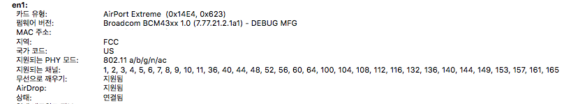

Here is the new country code patch, if someone has interest:
41 83 FC FF 74 35 48 8D 55 D0 -> 66 C7 06 23 61 EB 34 8D 55 D0
Note: 23 61 means '#' 'a', it appears that "#a" is universal for all countries, you can customize it (e.g. 55 53 -> US , 43 4e -> CN , etc)

Oops. MFG? So you are using that com.apple.driver.AirPort.BrcmNIC-MFG? Alright, the patch above is for com.apple.driver.AirPort.BrcmNIC
Try this for MFG driver (Oops but the value is the same)
00000000001608cb	41 83 fc ff 	cmpl	$-0x1, %r12d
00000000001608cf	74 35 	je	0x160906
00000000001608d1	48 8d 55 d0 	leaq	-0x30(%rbp), %rdx

yes
same. it's working now. remains board-id patch.
BT4LE-Handoff-Hotspot patch is same before. but not working Handoff(no) Hotspot(no)
yes
