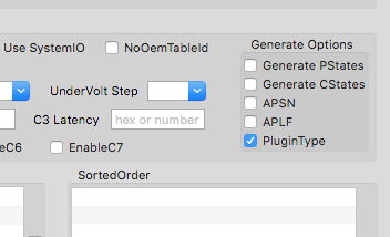

i think have one problem too, only for 10.13.4, u use 10.13.5 beta? if yes, just change to 10.13.x
check if ur PM work good with PlugIn type in DSDT

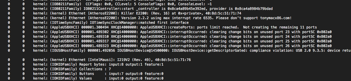

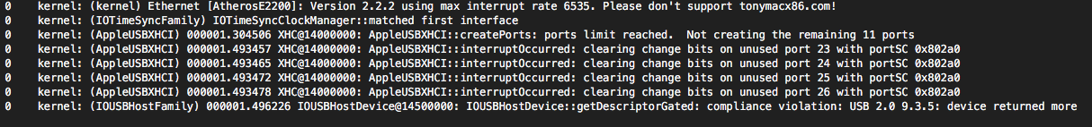

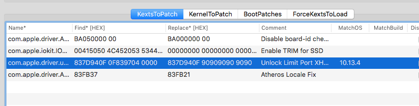

try with limit patch without flag, stay one log abou it
Just now, SavageAUS said:
I had the patch enabled. Should I disable, leave flags?
Sent from my SM-G930F using Tapatalk
ye, leave flag and use patch with 10.13.x

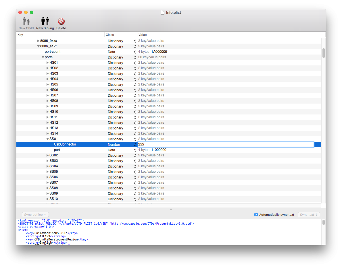

u can edit USBInjectAll kext for it
check what port aio liquid cooler usb header stay and set to 255, ssdt just change it and others, u can edit all into kext or flag, like a ssdt
skylake is a12f, check if work
it?

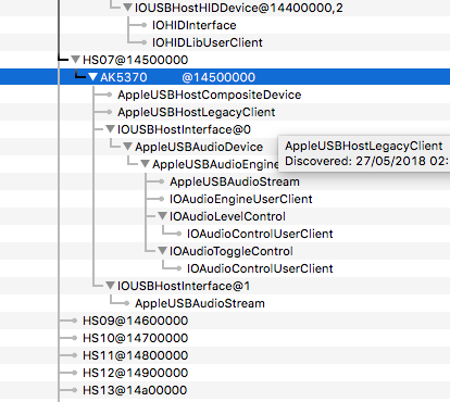

No the AK5370 is a USB microphone.
This is it.
Archive.zip

Any port that uses a motherboard usb header should be 255 yeah? Internal? Usb 2.0 is 0 and usb 3.0 is 3.
Setting cooler to 255 still gave me instant wake.
This is with my SSDT and port limit patch.
https://www.dropbox.com/s/tfevsswnv73k30i/Send me Shanes-iMac.lan.withssdt.withportpatch.zip?dl=0
yes, check port in use and set 0, ssdt use it

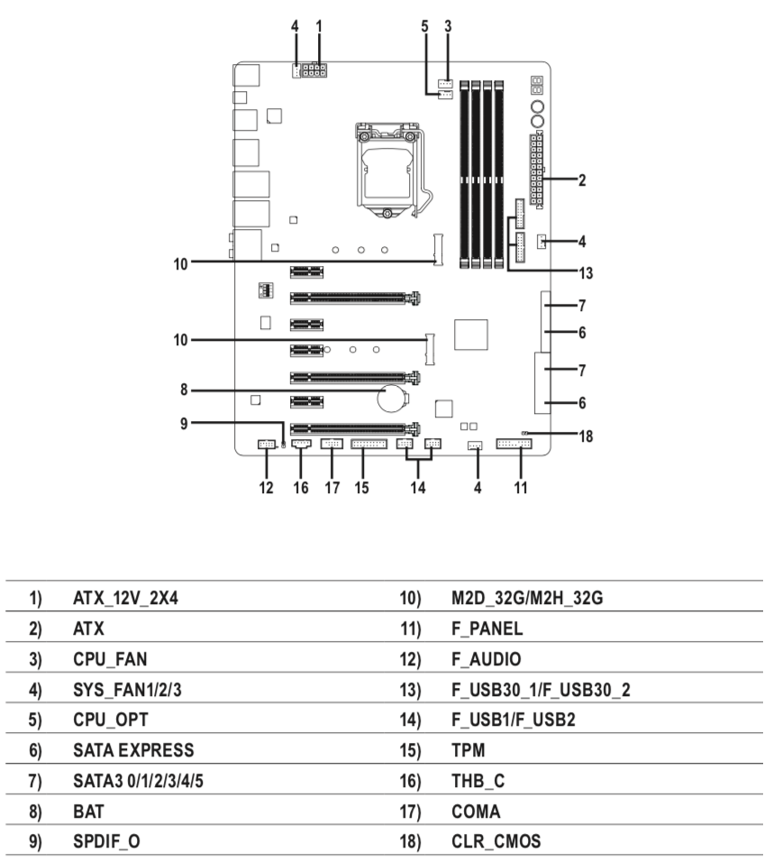

Has anyone tried this board with 2 x nvme m.2. I would like the speed boost as opposed to a standard ssd.
In particular looking at getting 2 x Samsung 970 EVO M.2 500g to replace 2 x 240g ssd.

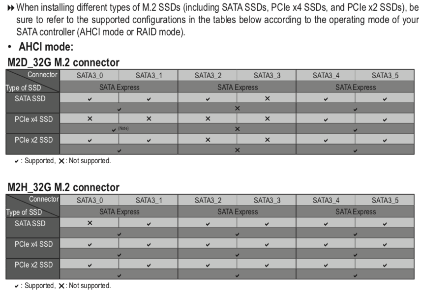

As you might already know, the NVMe ports share the PCI lane with SATA ports and if you use NVMe drives some of those SATA ports will be disabled.
Check the manual of the mainboard before purchasing the drives.
I installed mine in the M2H_32G M.2 connector which only disabled the SATA3_0 port and all of my other drives are OK (I have 5 other hard disks including a SSD disk).
