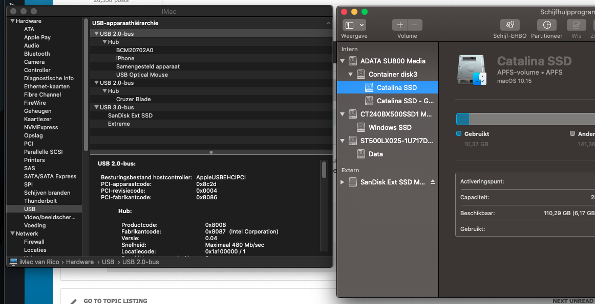

Guest ricoc90 Posted August 2, 2019 Share Posted August 2, 2019 12 minutes ago, MaLd0n said: DSDT.aml.zip Something funny is going on. So system profiler does show me the USB bus now. I can also plug in USB drives and they do show up in System Profiler, however with any USB port (usb2.0 and usb3.0) the issue is that they don't show up in Disk utility nor Finder unless I reboot with the USB drive plugged in ... Spoiler Send me iMac-van-Rico.zip Link to comment Share on other sites More sharing options...
MaLd0n Posted August 2, 2019 Author Share Posted August 2, 2019 3 minutes ago, ricoc90 said: Something funny is going on. So system profiler does show me the USB bus now. I can also plug in USB drives and they do show up in System Profiler, however with any USB port (usb2.0 and usb3.0) the issue is that they don't show up in Disk utility nor Finder unless I reboot with the USB drive plugged in ... Hide contents Send me iMac-van-Rico.zip u try with last dsdt(i put ehci devices again, in ur case u need it) without usbinjectall? 1 Link to comment Share on other sites More sharing options...
Guest ricoc90 Posted August 2, 2019 Share Posted August 2, 2019 8 minutes ago, MaLd0n said: u try with last dsdt(i put ehci devices again, in ur case u need it) without usbinjectall? I did not Now I did and USB ports do work as they should, thanks buddy Waking up issue is still present: no USB and monitor after wake Link to comment Share on other sites More sharing options...
