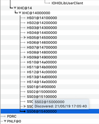

5 hours ago, desmocrash said:
Hello
I think these are ASMedia USB ports
it's not a problem, it's going to stay that way
thanks for your help
k:)
