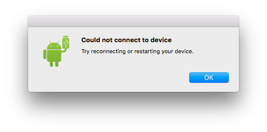

jason761 Posted November 6, 2018 Share Posted November 6, 2018 Hi @MaLd0n I'm running into another USB related issue. This time MTP is not working through Micro USB but it's working fine on Type-C. I tested on both USB 2 and USB 3. DSDT.aml Link to comment https://www.insanelymac.com/forum/topic/323052-guide-el-capitan-sierra-high-sierra-mojave-catalina-on-intel-5-6-7-8-9-chipset-series-nehalem-sandybridge-ivybridge-haswell-broadwell/page/86/#findComment-2645757 Share on other sites More sharing options...
MaLd0n Posted November 6, 2018 Author Share Posted November 6, 2018 7 hours ago, jason761 said: Hi @MaLd0n I'm running into another USB related issue. This time MTP is not working through Micro USB but it's working fine on Type-C. I tested on both USB 2 and USB 3. DSDT.aml https://olarila.com/forum/viewtopic.php?p=65287#p65287 Link to comment https://www.insanelymac.com/forum/topic/323052-guide-el-capitan-sierra-high-sierra-mojave-catalina-on-intel-5-6-7-8-9-chipset-series-nehalem-sandybridge-ivybridge-haswell-broadwell/page/86/#findComment-2645850 Share on other sites More sharing options...

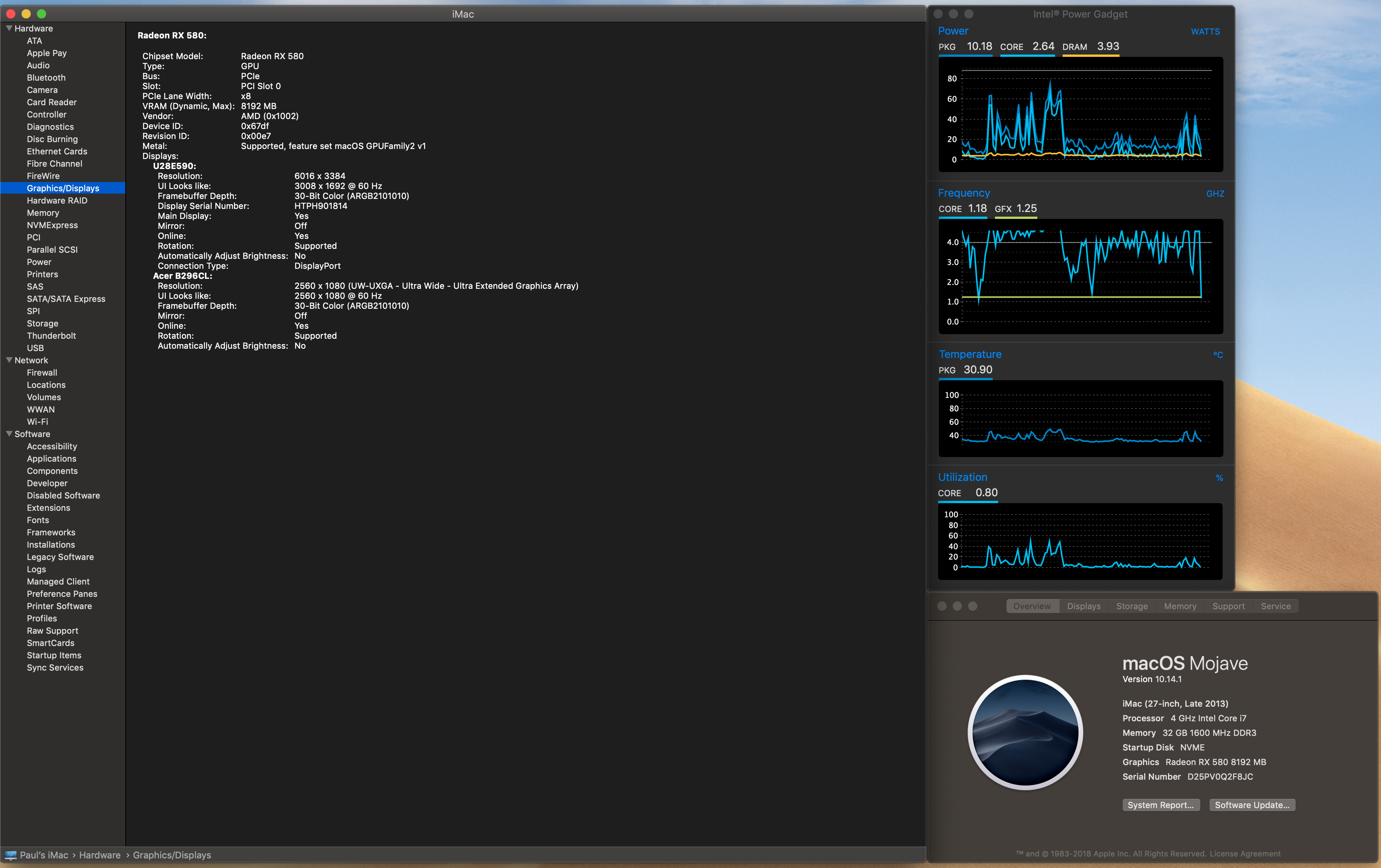

tikizondo94 Posted November 30, 2018 Share Posted November 30, 2018 Hey Maldon, Needing you assistance again please :). Similar build. Clean install. Just needing a Maldon DSDT to make it all complete Ive noticed when using the iMac 14,2 SmBios I loose GPU rendering support with my RX580 but gain it back when using the iMac15,1. Any advice? Send me Pauls-iMac.zip Link to comment https://www.insanelymac.com/forum/topic/323052-guide-el-capitan-sierra-high-sierra-mojave-catalina-on-intel-5-6-7-8-9-chipset-series-nehalem-sandybridge-ivybridge-haswell-broadwell/page/86/#findComment-2650880 Share on other sites More sharing options...
MaLd0n Posted December 1, 2018 Author Share Posted December 1, 2018 3 hours ago, tikizondo94 said: Hey Maldon, Needing you assistance again please :). Similar build. Clean install. Just needing a Maldon DSDT to make it all complete Ive noticed when using the iMac 14,2 SmBios I loose GPU rendering support with my RX580 but gain it back when using the iMac15,1. Any advice? Send me Pauls-iMac.zip for full solution, use this clover folder and enable intelhdgraphics in bios CLOVER.zip 1 Link to comment https://www.insanelymac.com/forum/topic/323052-guide-el-capitan-sierra-high-sierra-mojave-catalina-on-intel-5-6-7-8-9-chipset-series-nehalem-sandybridge-ivybridge-haswell-broadwell/page/86/#findComment-2650904 Share on other sites More sharing options...
tikizondo94 Posted December 1, 2018 Share Posted December 1, 2018 (edited) 16 hours ago, MaLd0n said: for full solution, use this clover folder and enable intelhdgraphics in bios CLOVER.zip Thanks Maldon! All Seems to be working fine now. Only thing ive noticed is that now iGPU is stuck at 1.25Ghz at all times now? Any ideas? Also im not showing any SS0/SSP ports in my XHC controller? Just HS ports. Ive tried changing in my Bios to Intel USB3.0 only to see if it makes a difference and it has not. Attached is another debug. Thanks again Maldon.. Send me Pauls-iMac.zip Edited December 1, 2018 by tikizondo94 Link to comment https://www.insanelymac.com/forum/topic/323052-guide-el-capitan-sierra-high-sierra-mojave-catalina-on-intel-5-6-7-8-9-chipset-series-nehalem-sandybridge-ivybridge-haswell-broadwell/page/86/#findComment-2651082 Share on other sites More sharing options...
tikizondo94 Posted December 1, 2018 Share Posted December 1, 2018 Ok, I figured out USB. Creating a SSDT-UIAC Fixed the issue. Got all my ports working at the correct speeds. So scratch that off. But i still cant get my iGPU you step the speed down from 1.25Ghz. That seems to be its current idle. Which 0.20Ghz is where it usually sits. ? Link to comment https://www.insanelymac.com/forum/topic/323052-guide-el-capitan-sierra-high-sierra-mojave-catalina-on-intel-5-6-7-8-9-chipset-series-nehalem-sandybridge-ivybridge-haswell-broadwell/page/86/#findComment-2651093 Share on other sites More sharing options...
MaLd0n Posted December 2, 2018 Author Share Posted December 2, 2018 7 hours ago, tikizondo94 said: Ok, I figured out USB. Creating a SSDT-UIAC Fixed the issue. Got all my ports working at the correct speeds. So scratch that off. But i still cant get my iGPU you step the speed down from 1.25Ghz. That seems to be its current idle. Which 0.20Ghz is where it usually sits. ? no idea about it, need check in search forum Link to comment https://www.insanelymac.com/forum/topic/323052-guide-el-capitan-sierra-high-sierra-mojave-catalina-on-intel-5-6-7-8-9-chipset-series-nehalem-sandybridge-ivybridge-haswell-broadwell/page/86/#findComment-2651138 Share on other sites More sharing options...
tikizondo94 Posted December 2, 2018 Share Posted December 2, 2018 14 hours ago, MaLd0n said: no idea about it, need check in search forum Figured it out one last thing. Sleep and wake works fine. But i cant use my mouse or keyboard anymore to wake the device. Only the power button? Link to comment https://www.insanelymac.com/forum/topic/323052-guide-el-capitan-sierra-high-sierra-mojave-catalina-on-intel-5-6-7-8-9-chipset-series-nehalem-sandybridge-ivybridge-haswell-broadwell/page/86/#findComment-2651396 Share on other sites More sharing options...

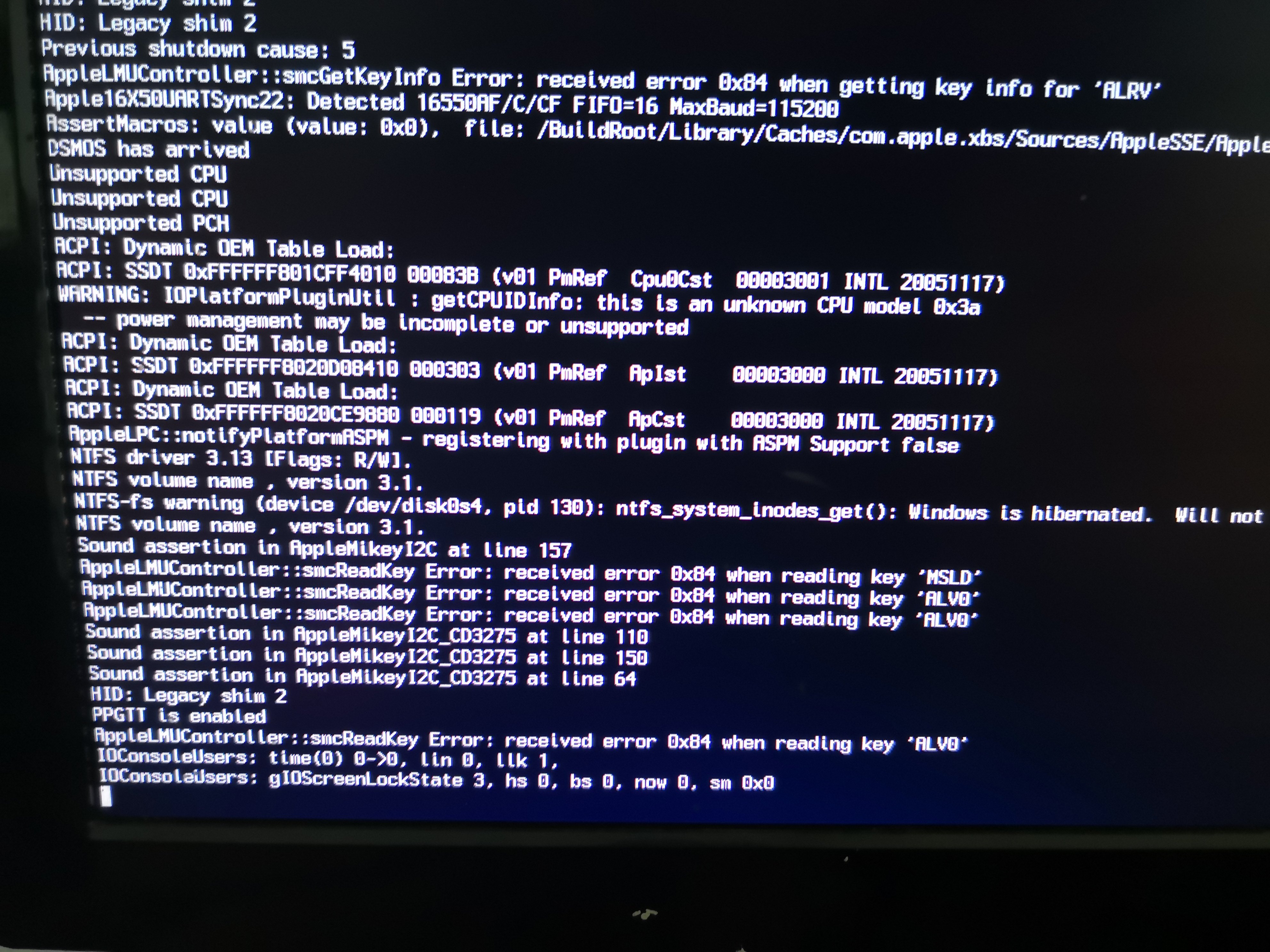

Tom Snow Posted December 9, 2018 Share Posted December 9, 2018 (edited) Hi all, I'm trying to install Mojave on my Sandy Bridge machine, currently running High Sierra, but can't even get it started. It's still the same Gigabyte Z68MA-D2H-B3 mobo with Intel Core i5-2500K I've been using since 2012, but I've since upgraded the graphics to a GeForce GTX 1060. System definition is iMac 14,2. So, that should meet the system requirements, I thought. I can't download the installer directly from the App Store because it says it can't be installed on my computer. So, I used DosDude's patcher program to download the installer. But *it* says that my machine supports Mojave natively and there's no need to patch it. So I used chris1111's program to make an installer USB, put MaLd0n's Clover folder on it, booted off of that into the installer, and it says that Mojave can't be installed on my computer. Since the config.plist on the USB uses the iMac 12,1 definition, I replaced it with the config.plist I've been using, with 14,2, but had the same problem. Right now I'm using DosDude's program to make a patched installer USB. It's taking a long time but it's preparing the USB as I type this. Can anyone tell what's going on? If it's not the graphics card or the system definition, why does the installer think Mojave can't be installed? Thanks in advance. Edited December 9, 2018 by Tom Snow Figured out why the DosDude patcher didn't work Link to comment https://www.insanelymac.com/forum/topic/323052-guide-el-capitan-sierra-high-sierra-mojave-catalina-on-intel-5-6-7-8-9-chipset-series-nehalem-sandybridge-ivybridge-haswell-broadwell/page/86/#findComment-2652957 Share on other sites More sharing options...
