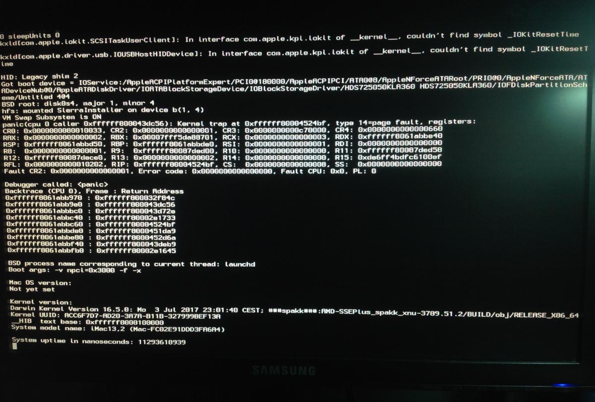

spakk Posted July 3, 2017 Author Share Posted July 3, 2017 Test kernel for older AMD CPU based on xnu-3789.51.2 (10.12.4) ..later am going to upload the missing system.kext and the frameworks kernel.zip 3 Link to comment https://www.insanelymac.com/forum/topic/322370-task-force-amd-to-missing-sse41-instruction-set-older-cpus-on-macos-sierra-1012x/page/2/#findComment-2456709 Share on other sites More sharing options...

AXAXAXAXAXAX Posted July 5, 2017 Share Posted July 5, 2017 Test kernel for older AMD CPU based on xnu-3789.51.2 (10.12.4) ..later am going to upload the missing system.kext and the frameworks AMD Athlon X2 4050 1 Link to comment https://www.insanelymac.com/forum/topic/322370-task-force-amd-to-missing-sse41-instruction-set-older-cpus-on-macos-sierra-1012x/page/2/#findComment-2457670 Share on other sites More sharing options...
spakk Posted July 6, 2017 Author Share Posted July 6, 2017 AMD Athlon X2 4050 IMG_1060.JPG Many thanks for checking and reporting. I'm looking for a solution. 1 Link to comment https://www.insanelymac.com/forum/topic/322370-task-force-amd-to-missing-sse41-instruction-set-older-cpus-on-macos-sierra-1012x/page/2/#findComment-2457976 Share on other sites More sharing options...

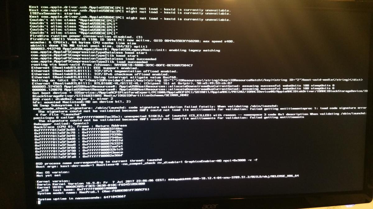

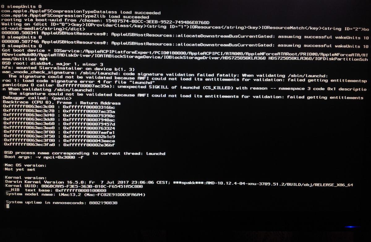

spakk Posted July 7, 2017 Author Share Posted July 7, 2017 I get this error ....please check:mac_vnode_check_signature: sbin/launchd: Code signature validation failed fatally: When validating /sbin/launchd: The signature could not be validated because AMFI could not load its entitlements for validation: failed getting entitlementsproc 1:load code signature error 4 for file "launchd" panic (cpu 0 caller 0xffffff80007ac35a): unexpected SIGKILL of launchd (CS_Killed) with reason--namespace 3 code 0x1 descripion When validating /sbin/launchd: The signature could not be validated because AMFI could not load its entitlements for validation: failed getting entitlements ........ any idea? Kernel.zip 2 Link to comment https://www.insanelymac.com/forum/topic/322370-task-force-amd-to-missing-sse41-instruction-set-older-cpus-on-macos-sierra-1012x/page/2/#findComment-2458628 Share on other sites More sharing options...
AXAXAXAXAXAX Posted July 8, 2017 Share Posted July 8, 2017 I get this error ....please check: mac_vnode_check_signature: sbin/launchd: Code signature validation failed fatally: When validating /sbin/launchd: The signature could not be validated because AMFI could not load its entitlements for validation: failed getting entitlementsproc 1: load code signature error 4 for file "launchd" panic (cpu 0 caller 0xffffff80007ac35a): unexpected SIGKILL of launchd (CS_Killed) with reason--namespace 3 code 0x1 descripion When validating /sbin/launchd: The signature could not be validated because AMFI could not load its entitlements for validation: failed getting entitlements ........ any idea? I get the same error 1 Link to comment https://www.insanelymac.com/forum/topic/322370-task-force-amd-to-missing-sse41-instruction-set-older-cpus-on-macos-sierra-1012x/page/2/#findComment-2459072 Share on other sites More sharing options...
jalavoui Posted July 9, 2017 Share Posted July 9, 2017 check here https://github.com/0xffea/xnu/blob/master/security/mac_vfs.c its an old version but maybe u can find it in your kernel source maybe also here https://github.com/oza/FreeBSD-8.0-dyntick/blob/master/sys/security/mac/mac_vfs.c 1 Link to comment https://www.insanelymac.com/forum/topic/322370-task-force-amd-to-missing-sse41-instruction-set-older-cpus-on-macos-sierra-1012x/page/2/#findComment-2459125 Share on other sites More sharing options...
spakk Posted July 9, 2017 Author Share Posted July 9, 2017 check here https://github.com/0xffea/xnu/blob/master/security/mac_vfs.c its an old version but maybe u can find it in your kernel source maybe also here https://github.com/oza/FreeBSD-8.0-dyntick/blob/master/sys/security/mac/mac_vfs.c @jalavoui Thanks for your message The previous changes in mac_vfs.c have not reached the desired destination but as soon as I'm at home, I'll look at the two links in detail. Link to comment https://www.insanelymac.com/forum/topic/322370-task-force-amd-to-missing-sse41-instruction-set-older-cpus-on-macos-sierra-1012x/page/2/#findComment-2459371 Share on other sites More sharing options...

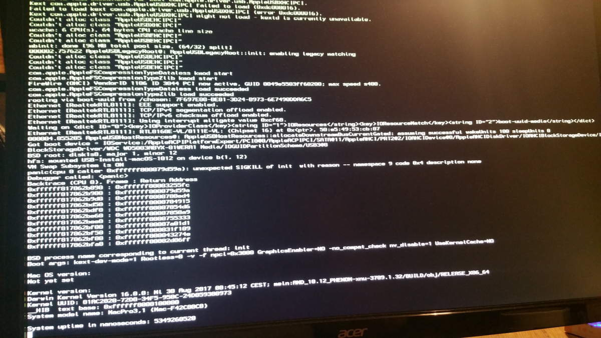

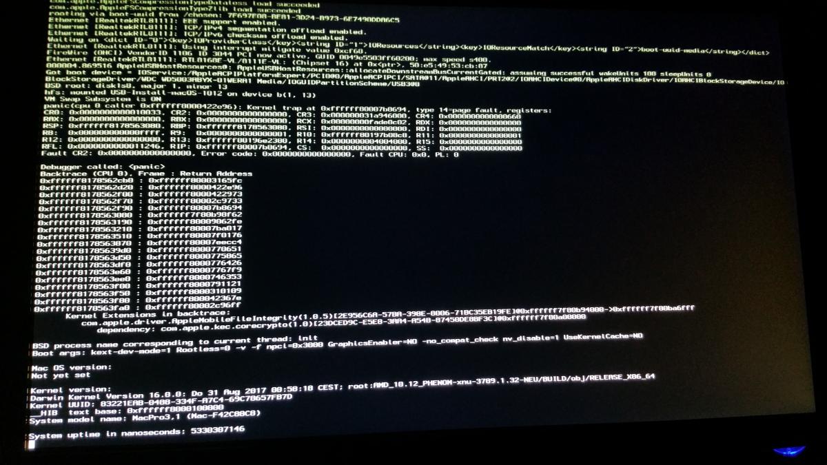

spakk Posted August 30, 2017 Author Share Posted August 30, 2017 I go forward only with small steps attached a new kernel, unfortunately kernel stops, see picture ... and neglect to answer to the bootargs I've used. @jalavoui, If you have interest to work on a solution, then send me a message Kernel.zip 1 Link to comment https://www.insanelymac.com/forum/topic/322370-task-force-amd-to-missing-sse41-instruction-set-older-cpus-on-macos-sierra-1012x/page/2/#findComment-2486923 Share on other sites More sharing options...
Shaneee Posted August 30, 2017 Share Posted August 30, 2017 I go forward only with small steps attached a new kernel, unfortunately kernel stops, see picture ... and neglect to answer to the bootargs I've used. @jalavoui, If you have interest to work on a solution, then send me a message Spakk can you try this kernel please. Minimal edits to boot on AMD and an older OPEMU with SSE42 in it. May possibly need SSE41. kernel.zip Link to comment https://www.insanelymac.com/forum/topic/322370-task-force-amd-to-missing-sse41-instruction-set-older-cpus-on-macos-sierra-1012x/page/2/#findComment-2486968 Share on other sites More sharing options...
spakk Posted August 30, 2017 Author Share Posted August 30, 2017 Spakk can you try this kernel please. Minimal edits to boot on AMD and an older OPEMU with SSE42 in it. May possibly need SSE41. I'll check later, shane send you later the diff-file, then you can see what I've made changes. Try changing kern_sig.c and hope that is doing something hope I am on the right way and not go wrong way Link to comment https://www.insanelymac.com/forum/topic/322370-task-force-amd-to-missing-sse41-instruction-set-older-cpus-on-macos-sierra-1012x/page/2/#findComment-2487031 Share on other sites More sharing options...
Shaneee Posted August 30, 2017 Share Posted August 30, 2017 I'll check later, shane send you later the diff-file, then you can see what I've made changes. Try changing kern_sig.c and hope that is doing something Sure. The kernel I posted only has Cupid, tsc, fpu, laptic_native and opemu edits to run with minimal edits. It still boots my FX with no issues at all. The OPEMU used is that of AnV with his base SSE4.2 edits. Link to comment https://www.insanelymac.com/forum/topic/322370-task-force-amd-to-missing-sse41-instruction-set-older-cpus-on-macos-sierra-1012x/page/2/#findComment-2487037 Share on other sites More sharing options...

spakk Posted August 30, 2017 Author Share Posted August 30, 2017 Any one an idea?? Edit: Just build a new one, is there someone who can test the kernel? here the new Test-Kernel.zip Link to comment https://www.insanelymac.com/forum/topic/322370-task-force-amd-to-missing-sse41-instruction-set-older-cpus-on-macos-sierra-1012x/page/2/#findComment-2487475 Share on other sites More sharing options...
