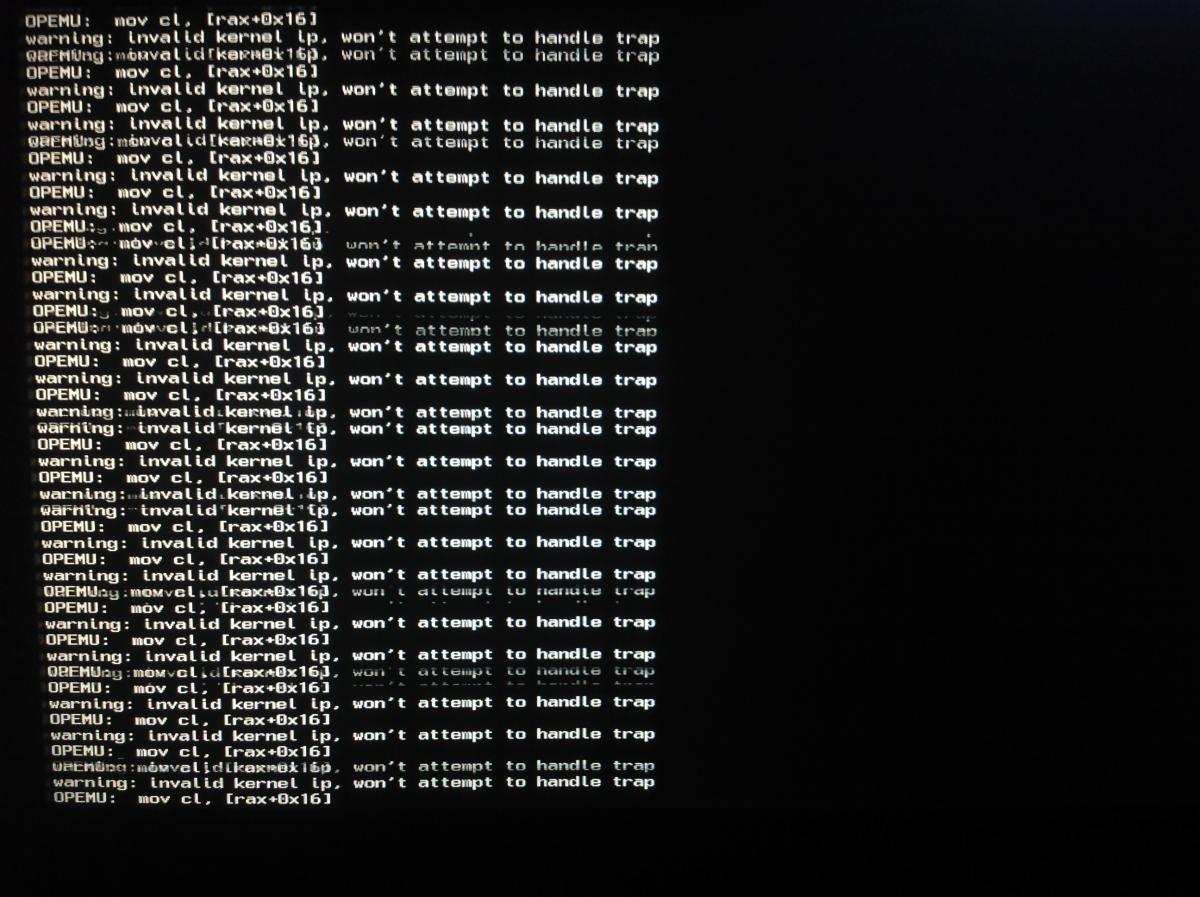

ydeng Posted October 14, 2017 Share Posted October 14, 2017 AMD Athlon X2 4050 IMG_1712.JPG Forgot to turn sse4.1 emulation on in kernel trap. Please try this one. AMD Athlon X2 4050 IMG_1712.JPG This one comes from here https://github.com/Shaneee92/SierraAMD-XNU/blob/master/osfmk/i386/trap.c#L802. The memory address pointed to by instruction counter does not exist! 5 Link to comment https://www.insanelymac.com/forum/topic/322370-task-force-amd-to-missing-sse41-instruction-set-older-cpus-on-macos-sierra-1012x/page/4/#findComment-2515528 Share on other sites More sharing options...
jsl Posted October 14, 2017 Share Posted October 14, 2017 Forgot to turn sse4.1 emulation on in kernel trap. Please try this one. This one comes from here https://github.com/Shaneee92/SierraAMD-XNU/blob/master/osfmk/i386/trap.c#L802. The memory address pointed to by instruction counter does not exist! Thanks for this testing kernel which got the same error as Post#82 here in my FX-6300 hackintosh. I'll test it later in Phenom II x6 hackintosh later. Link to comment https://www.insanelymac.com/forum/topic/322370-task-force-amd-to-missing-sse41-instruction-set-older-cpus-on-macos-sierra-1012x/page/4/#findComment-2515616 Share on other sites More sharing options...
ydeng Posted October 14, 2017 Share Posted October 14, 2017 Thanks for this testing kernel which got the same error as Post#82 here in my FX-6300 hackintosh. I'll test it later in Phenom II x6 hackintosh later. Are you able to see anything else before it prints pages of invalid kernel ip? This one boots FX8350 with no problem. I turned on trap panic. Should be able to see what happens before the memory error. 2 Link to comment https://www.insanelymac.com/forum/topic/322370-task-force-amd-to-missing-sse41-instruction-set-older-cpus-on-macos-sierra-1012x/page/4/#findComment-2515631 Share on other sites More sharing options...

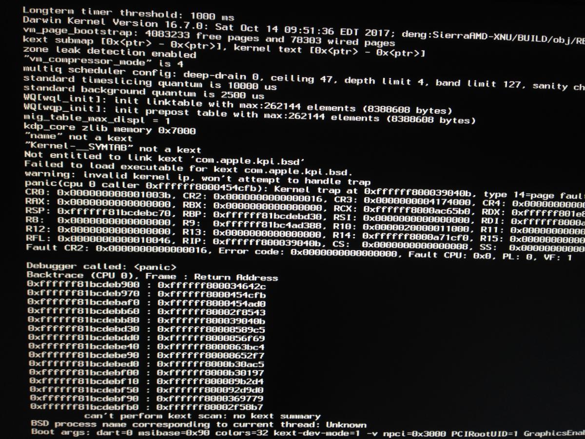

jsl Posted October 14, 2017 Share Posted October 14, 2017 Are you able to see anything else before it prints pages of invalid kernel ip? This one boots FX8350 with no problem. I turned on trap panic. Should be able to see what happens before the memory error. This kernel can boot to desktop at 10.12.6 by Clover, but it got KP by Enoch/Bronya. 1 Link to comment https://www.insanelymac.com/forum/topic/322370-task-force-amd-to-missing-sse41-instruction-set-older-cpus-on-macos-sierra-1012x/page/4/#findComment-2515756 Share on other sites More sharing options...
ydeng Posted October 14, 2017 Share Posted October 14, 2017 This kernel can boot to desktop at 10.12.6 by Clover, but it got KP by Enoch/Bronya. com.apple.kpi.bsd is not linked properly. Stock Enoch works for me. Link to comment https://www.insanelymac.com/forum/topic/322370-task-force-amd-to-missing-sse41-instruction-set-older-cpus-on-macos-sierra-1012x/page/4/#findComment-2515763 Share on other sites More sharing options...
jsl Posted October 14, 2017 Share Posted October 14, 2017 com.apple.kpi.bsd is not linked properly. Stock Enoch works for me. Yes, Enoch 2902 can boot to desktop without any issue in FX-6300 hackintosh. 1 Link to comment https://www.insanelymac.com/forum/topic/322370-task-force-amd-to-missing-sse41-instruction-set-older-cpus-on-macos-sierra-1012x/page/4/#findComment-2515804 Share on other sites More sharing options...

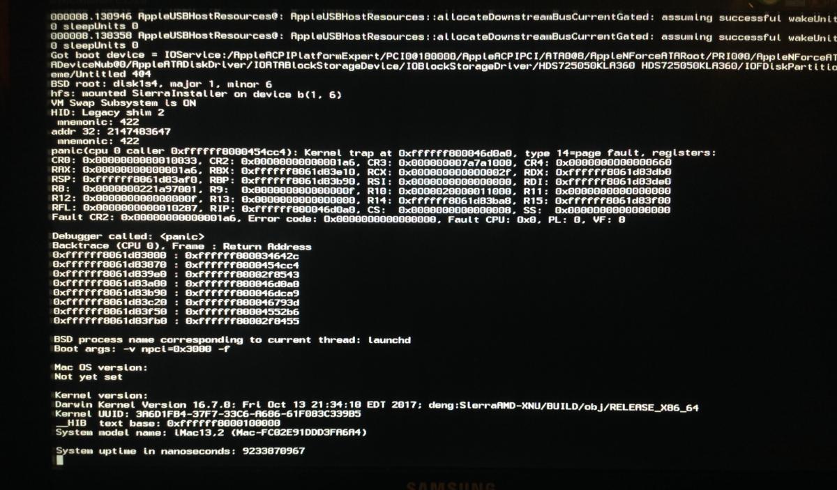

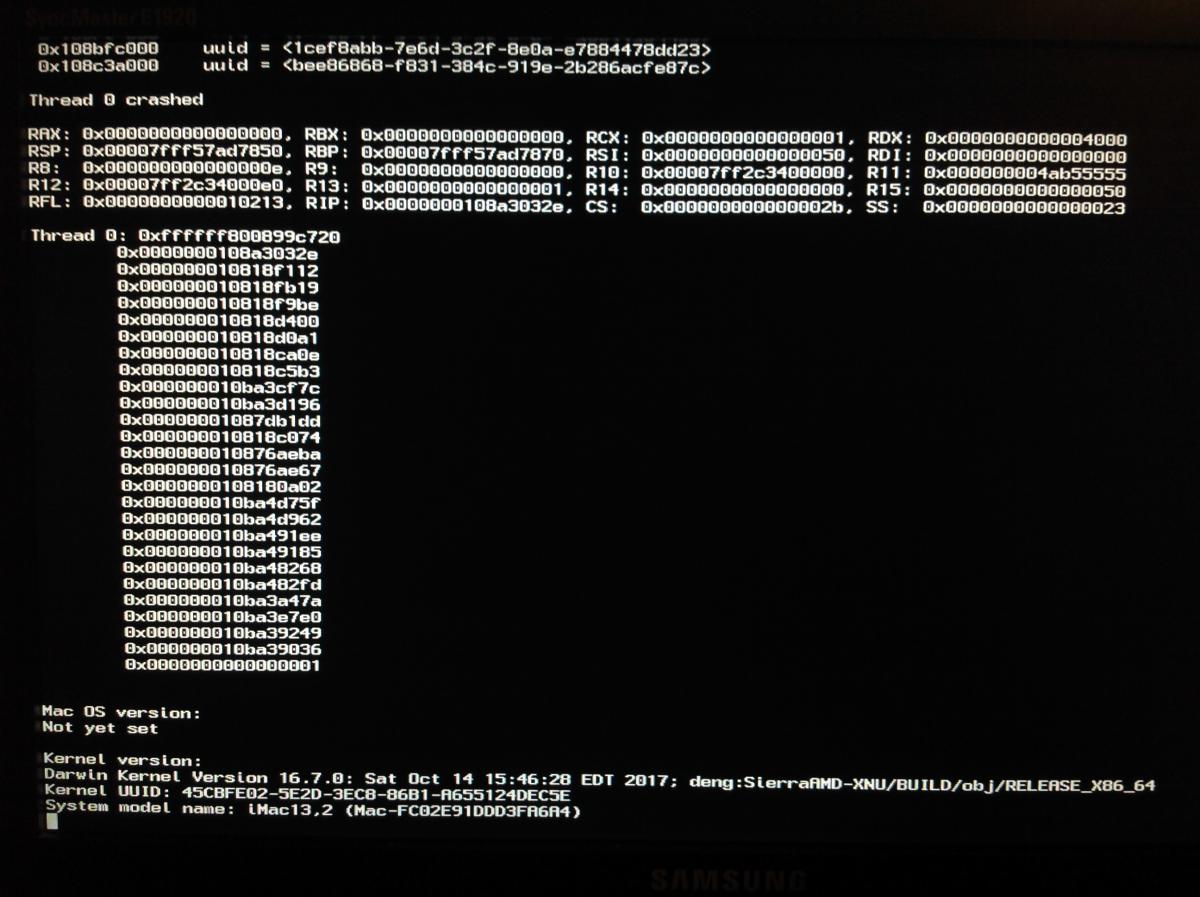

AXAXAXAXAXAX Posted October 14, 2017 Share Posted October 14, 2017 Are you able to see anything else before it prints pages of invalid kernel ip? This one boots FX8350 with no problem. I turned on trap panic. Should be able to see what happens before the memory error. the first kernel with Enoch r2902: the latest kernel: and it gives a lot of messages of "mnemonic: 422" and things like "0x103777000 uuid = <13d3b12d-3c1c-3f22-8735-f8ec784714f4>" before and says initproc exited -- no exit reason available -- (signal 6, exit status 0 ) 2 Link to comment https://www.insanelymac.com/forum/topic/322370-task-force-amd-to-missing-sse41-instruction-set-older-cpus-on-macos-sierra-1012x/page/4/#findComment-2515901 Share on other sites More sharing options...
ydeng Posted October 14, 2017 Share Posted October 14, 2017 the first kernel with Enoch r2902: IMG_1718.JPG the latest kernel: IMG_1717.JPG and it gives a lot of messages of "mnemonic: 422" and things like "0x103777000 uuid = <13d3b12d-3c1c-3f22-8735-f8ec784714f4>" before and says initproc exited -- no exit reason available -- (signal 6, exit status 0 ) I forgot to turn some of the debug prints off. 'mnemonic: 422' is sse4.1 instruction pinsrd . Let me remove those so that we can see where it crashes. Here's another one. Thanks for trying. 1 Link to comment https://www.insanelymac.com/forum/topic/322370-task-force-amd-to-missing-sse41-instruction-set-older-cpus-on-macos-sierra-1012x/page/4/#findComment-2515961 Share on other sites More sharing options...

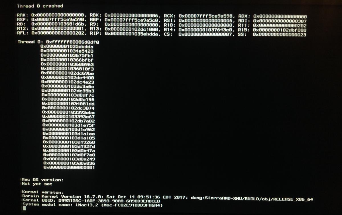

AXAXAXAXAXAX Posted October 14, 2017 Share Posted October 14, 2017 I forgot to turn some of the debug prints off. 'mnemonic: 422' is sse4.1 instruction pinsrd . Let me remove those so that we can see where it crashes. Here's another one. Thanks for trying. it still gives me a lot of messages with uuid like the first two in the screenshot Link to comment https://www.insanelymac.com/forum/topic/322370-task-force-amd-to-missing-sse41-instruction-set-older-cpus-on-macos-sierra-1012x/page/4/#findComment-2516030 Share on other sites More sharing options...
ydeng Posted October 14, 2017 Share Posted October 14, 2017 it still gives me a lot of messages with uuid like the first two in the screenshot IMG_1791.JPG I think I need to copyin/out between user space memory and kernel space. Thanks for the update. This takes a lot of patience. But we are getting there. Please try again. Fixed a bunch of bugs. 2 Link to comment https://www.insanelymac.com/forum/topic/322370-task-force-amd-to-missing-sse41-instruction-set-older-cpus-on-macos-sierra-1012x/page/4/#findComment-2516048 Share on other sites More sharing options...

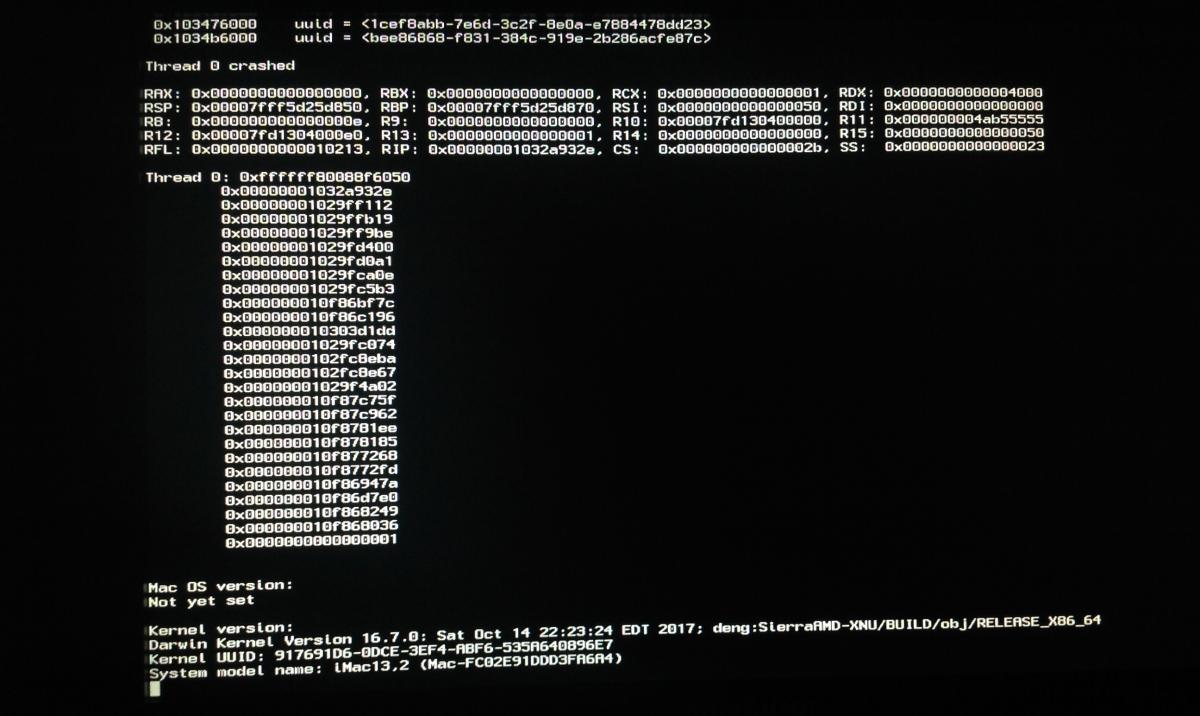

AXAXAXAXAXAX Posted October 15, 2017 Share Posted October 15, 2017 I think I need to copyin/out between user space memory and kernel space. Thanks for the update. This takes a lot of patience. But we are getting there. Please try again. Fixed a bunch of bugs. Still the same 2 Link to comment https://www.insanelymac.com/forum/topic/322370-task-force-amd-to-missing-sse41-instruction-set-older-cpus-on-macos-sierra-1012x/page/4/#findComment-2516173 Share on other sites More sharing options...
ydeng Posted October 15, 2017 Share Posted October 15, 2017 Still the same IMG_1796.JPG Debug print all sse41 instructions. You need to catch the last one before the failure. 1 Link to comment https://www.insanelymac.com/forum/topic/322370-task-force-amd-to-missing-sse41-instruction-set-older-cpus-on-macos-sierra-1012x/page/4/#findComment-2516395 Share on other sites More sharing options...
