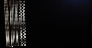

spakk Posted October 22, 2017 Author Share Posted October 22, 2017 I am just building the kernel and will report later I will now check this kernel with my CPU and report later Edit: I've made a video and will upload it later AMD10.12.6-SSE4.1.zip Link to comment https://www.insanelymac.com/forum/topic/322370-task-force-amd-to-missing-sse41-instruction-set-older-cpus-on-macos-sierra-1012x/page/6/#findComment-2520415 Share on other sites More sharing options...

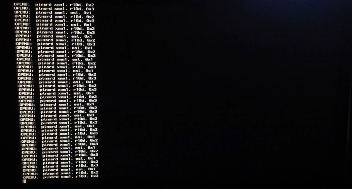

ydeng Posted October 22, 2017 Share Posted October 22, 2017 I am just building the kernel and will report later I will now check this kernel with my CPU and report later Edit: I've made a video and will upload it later None of these instructions is sse4.1. I turned on printing for all instructions executed by opemu. You may selectively print to see boot messages. Link to comment https://www.insanelymac.com/forum/topic/322370-task-force-amd-to-missing-sse41-instruction-set-older-cpus-on-macos-sierra-1012x/page/6/#findComment-2520451 Share on other sites More sharing options...

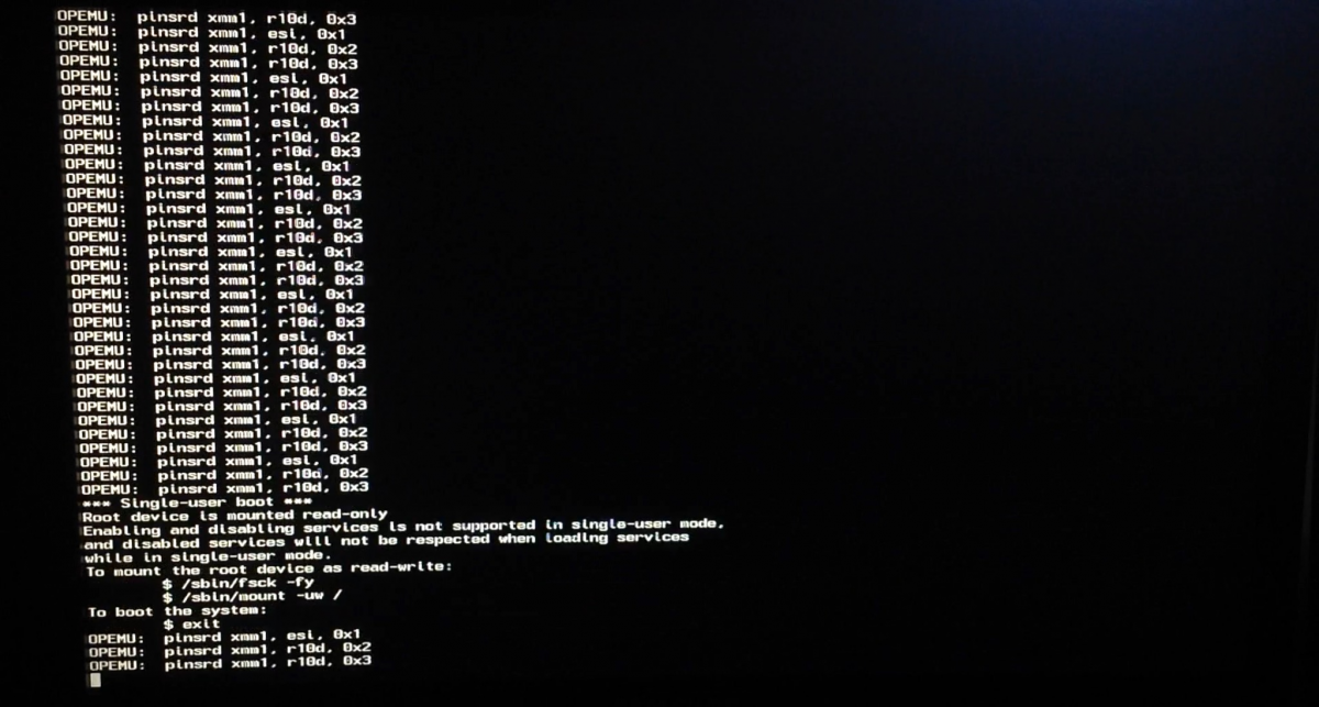

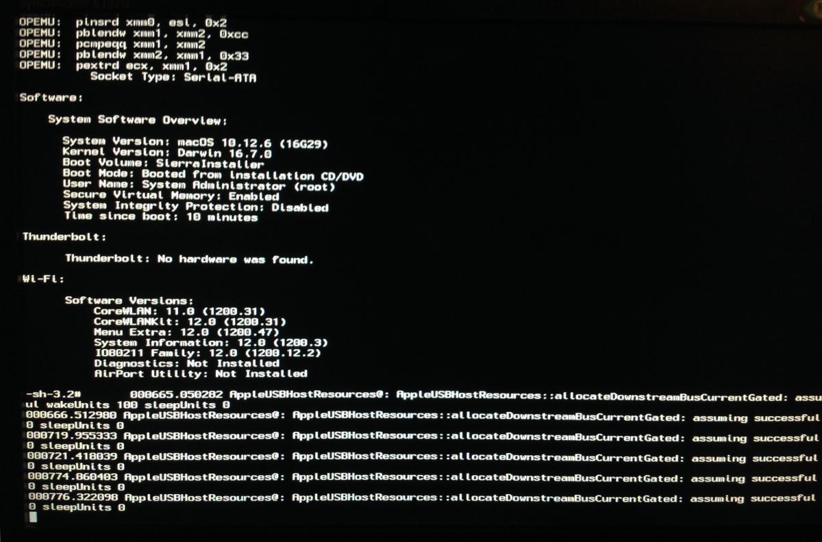

AXAXAXAXAXAX Posted October 23, 2017 Share Posted October 23, 2017 None of these instructions is sse4.1. I turned on printing for all instructions executed by opemu. You may selectively print to see boot messages.I managed to boot into single user mode. Can I do something useful there? 2 Link to comment https://www.insanelymac.com/forum/topic/322370-task-force-amd-to-missing-sse41-instruction-set-older-cpus-on-macos-sierra-1012x/page/6/#findComment-2521483 Share on other sites More sharing options...
spakk Posted October 24, 2017 Author Share Posted October 24, 2017 I managed to boot into single user mode. Can I do something useful there? IMG_1918.JPG Insert the USB dummies into S/L/E and test again USB-Fix.zip 1 Link to comment https://www.insanelymac.com/forum/topic/322370-task-force-amd-to-missing-sse41-instruction-set-older-cpus-on-macos-sierra-1012x/page/6/#findComment-2521555 Share on other sites More sharing options...

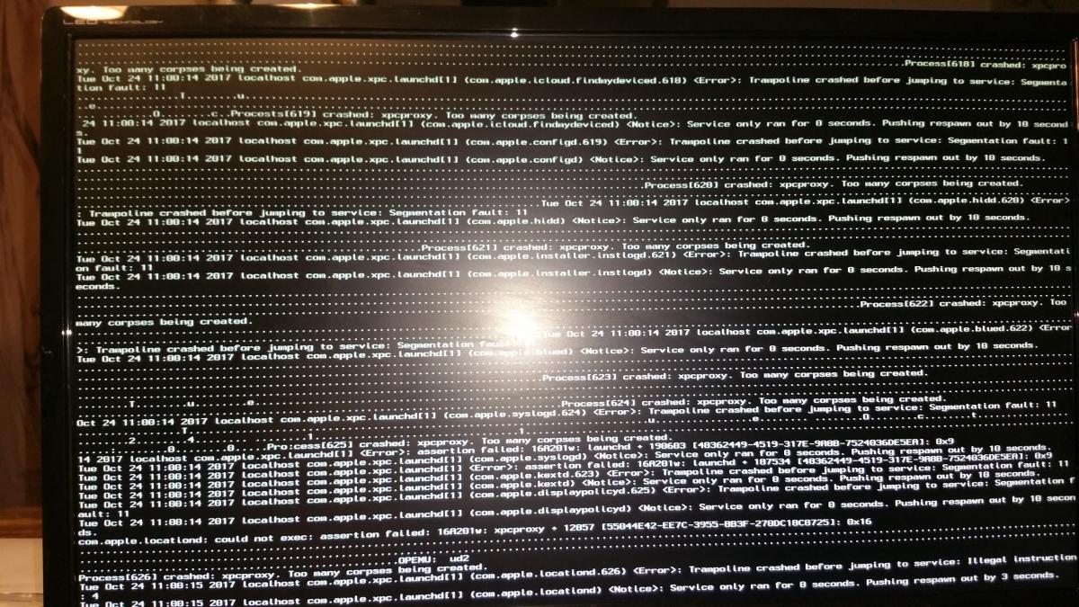

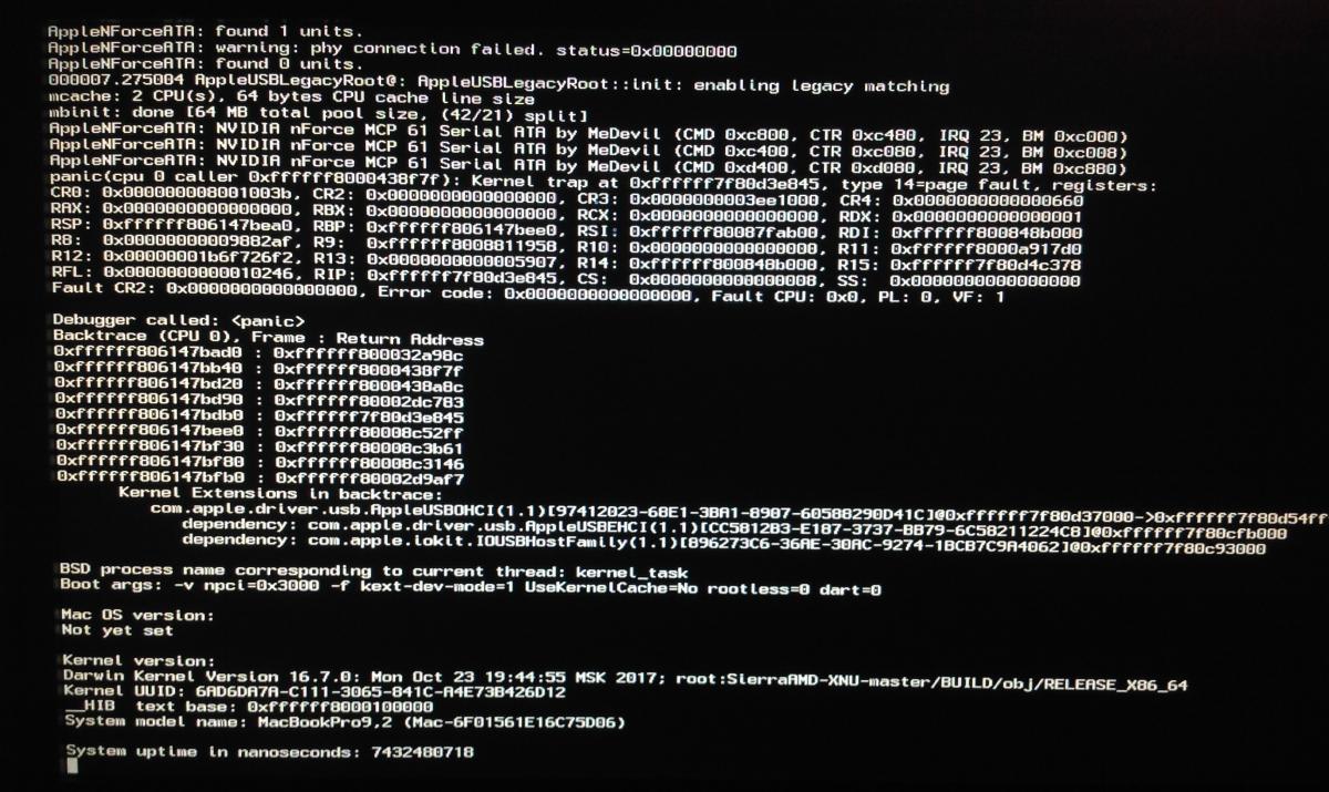

AXAXAXAXAXAX Posted October 24, 2017 Share Posted October 24, 2017 what a mainboard you have?Asrock N68C-S USS Now I stuck at this point: The cursor doesn't respond to my USB mouse but USB keyboard seems to be working. Link to comment https://www.insanelymac.com/forum/topic/322370-task-force-amd-to-missing-sse41-instruction-set-older-cpus-on-macos-sierra-1012x/page/6/#findComment-2521804 Share on other sites More sharing options...
spakk Posted October 24, 2017 Author Share Posted October 24, 2017 Asrock N68C-S USS Now I stuck at this point: IMG_1928.JPG The cursor doesn't respond to my USB mouse but USB keyboard seems to be working. 1. can not find information to your controller, start systeminfo.app or dpci-manager.app and see which controller is installed 2. or put this into org.chanmeleon.boot.plist, may it can help? USBBusFix Yes 3. if possible boot with -v -f or with -s ..etc 4. Which drivers are in extra/extensions? Link to comment https://www.insanelymac.com/forum/topic/322370-task-force-amd-to-missing-sse41-instruction-set-older-cpus-on-macos-sierra-1012x/page/6/#findComment-2521834 Share on other sites More sharing options...

AXAXAXAXAXAX Posted October 24, 2017 Share Posted October 24, 2017 do you have solved the problem ? I guess there is a bug somewhere in opemu, probably in sse41.c. I added printf in sse41.c and the kernel started working and it doesn't matter what to put in printf, it will work while printf is there. Here is some reference to that https://stackoverflow.com/questions/6079865/why-does-a-printf-stop-a-crash-from-occuring/6079878#6079878 and here is my test kernel. i put dots in printf in it to be able to see other print kernel.zip 1 Link to comment https://www.insanelymac.com/forum/topic/322370-task-force-amd-to-missing-sse41-instruction-set-older-cpus-on-macos-sierra-1012x/page/6/#findComment-2521933 Share on other sites More sharing options...

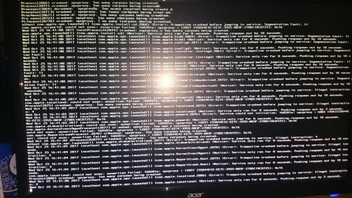

AXAXAXAXAXAX Posted October 25, 2017 Share Posted October 25, 2017 so now it stops at this endless loop with Opemu: UD2 error. What changes you have made? I've used ydeng's patch and added printf in op_see41_run. That's all and printf should be disabled in other places in opemu because it will get a kernel panic if it isn't. 1 Link to comment https://www.insanelymac.com/forum/topic/322370-task-force-amd-to-missing-sse41-instruction-set-older-cpus-on-macos-sierra-1012x/page/6/#findComment-2522165 Share on other sites More sharing options...

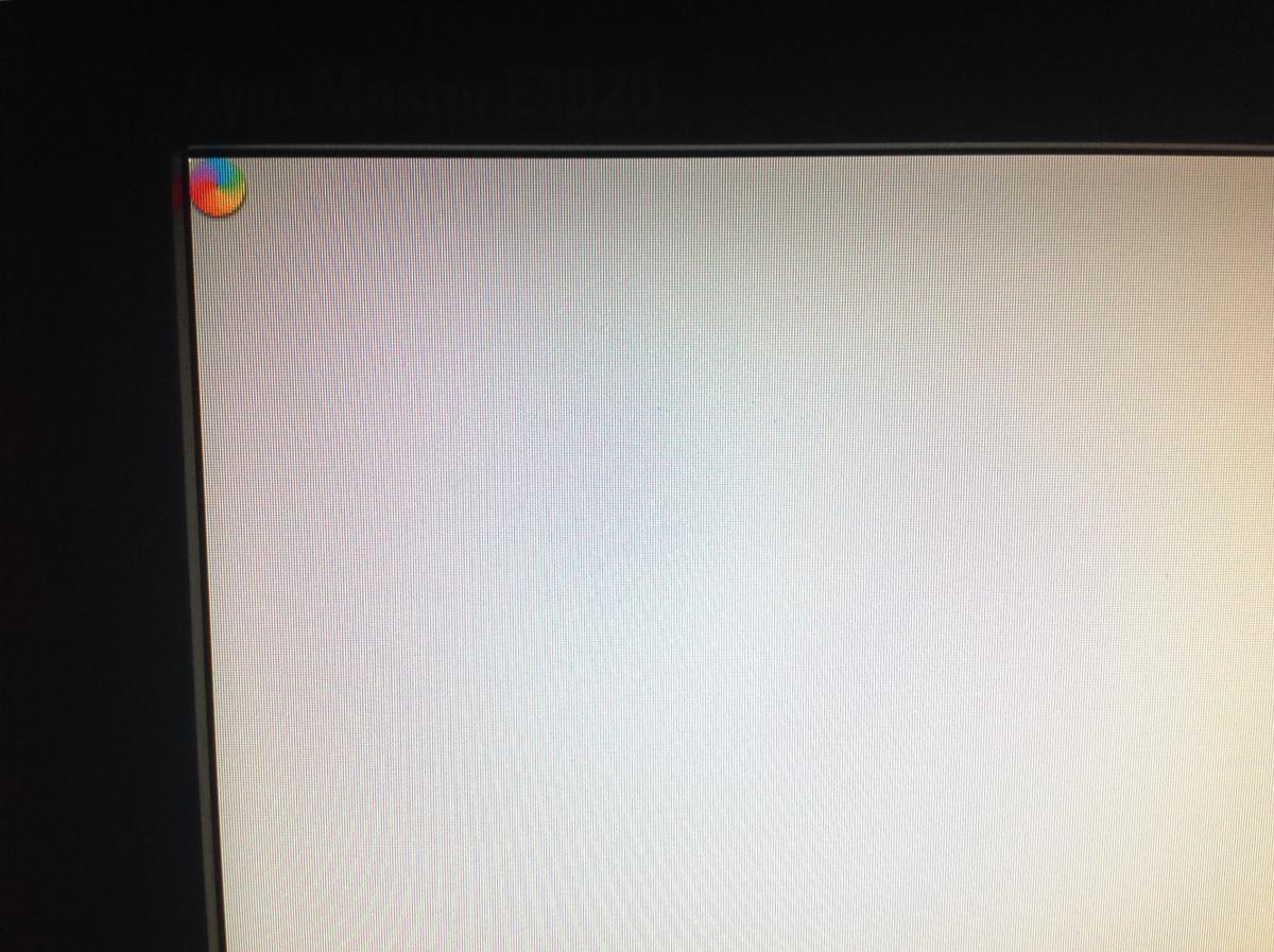

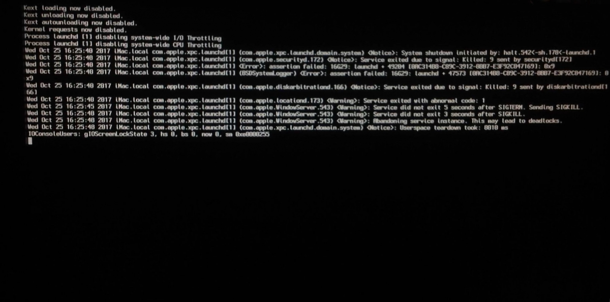

AXAXAXAXAXAX Posted October 25, 2017 Share Posted October 25, 2017 New test kernel Edit: It boots to the white screen with loading cursor but then the system shuts down with this log kernel.zip 1 Link to comment https://www.insanelymac.com/forum/topic/322370-task-force-amd-to-missing-sse41-instruction-set-older-cpus-on-macos-sierra-1012x/page/6/#findComment-2522506 Share on other sites More sharing options...
spakk Posted October 26, 2017 Author Share Posted October 26, 2017 I think it has something to do with the graphics card Edit: this is my test result 1 Link to comment https://www.insanelymac.com/forum/topic/322370-task-force-amd-to-missing-sse41-instruction-set-older-cpus-on-macos-sierra-1012x/page/6/#findComment-2522549 Share on other sites More sharing options...

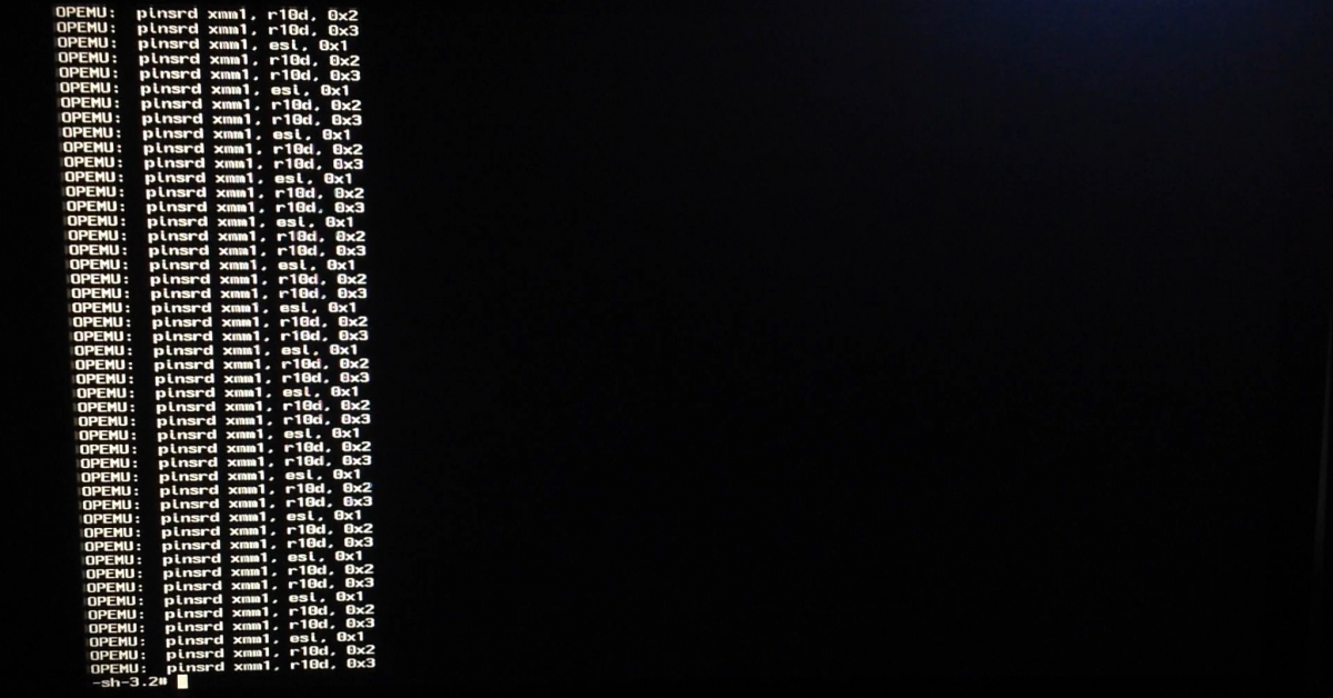

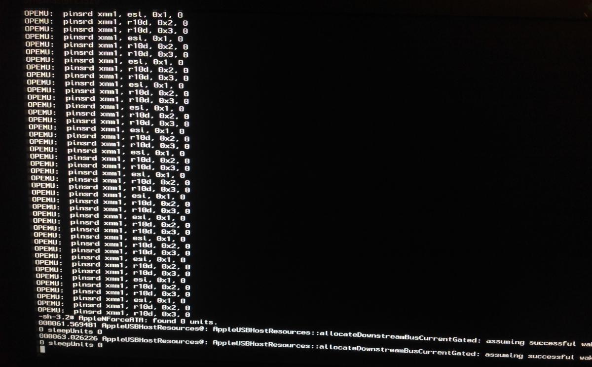

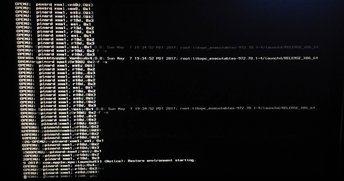

ydeng Posted October 26, 2017 Share Posted October 26, 2017 I've used ydeng's patch and added printf in op_see41_run. That's all and printf should be disabled in other places in opemu because it will get a kernel panic if it isn't. Where did you put the printf exactly? I see a whole bunch of sse4.1 instructions on your single user mode boot screen. There is some strange side effect going on. Link to comment https://www.insanelymac.com/forum/topic/322370-task-force-amd-to-missing-sse41-instruction-set-older-cpus-on-macos-sierra-1012x/page/6/#findComment-2522564 Share on other sites More sharing options...
AXAXAXAXAXAX Posted October 26, 2017 Share Posted October 26, 2017 Where did you put the printf exactly? I see a whole bunch of sse4.1 instructions on your single user mode boot screen. There is some strange side effect going on. i put it just above of switch statement of mnemonic. Link to comment https://www.insanelymac.com/forum/topic/322370-task-force-amd-to-missing-sse41-instruction-set-older-cpus-on-macos-sierra-1012x/page/6/#findComment-2522566 Share on other sites More sharing options...
ydeng Posted October 26, 2017 Share Posted October 26, 2017 i put it just above of switch statement of mnemonic. Do you have the full log of single user mode? Link to comment https://www.insanelymac.com/forum/topic/322370-task-force-amd-to-missing-sse41-instruction-set-older-cpus-on-macos-sierra-1012x/page/6/#findComment-2522714 Share on other sites More sharing options...
spakk Posted October 26, 2017 Author Share Posted October 26, 2017 Do you have the full log of single user mode? this is correct, you can boot only with "single user mode", every other input goes into a kernel panic sory, a misunderstanding Edit: but the information that "AXAXAXAXAXAX" has made regarding printf () in sse41.c, can not be alone, there must be other changes in the source. he should check the source again I do not get the same effect with the changes as the last kernel from "AXAXAXAXAXAX" , therefore there must be something else changed. Link to comment https://www.insanelymac.com/forum/topic/322370-task-force-amd-to-missing-sse41-instruction-set-older-cpus-on-macos-sierra-1012x/page/6/#findComment-2522734 Share on other sites More sharing options...
AXAXAXAXAXAX Posted October 26, 2017 Share Posted October 26, 2017 Do you have the full log of single user mode? this is correct, you can boot only with "single user mode", every other input goes into a kernel panic sory, a misunderstanding Edit: but the information that "AXAXAXAXAXAX" has made regarding printf () in sse41.c, can not be alone, there must be other changes in the source. he should check the source again I do not get the same effect with the changes as the last kernel from "AXAXAXAXAXAX" , therefore there must be something else changed. I think only printf in sse41.c affected that. But I'll check it with clean sources and report later. Edit: I applied ydeng's patch onto sourses, commented printf in opemu_ktrap and opemu_utrap in opemu.c and enabled printf in op_sse41_run in sse41.c and built this kernel and it doesn't get kernel panic kernel.zip 1 Link to comment https://www.insanelymac.com/forum/topic/322370-task-force-amd-to-missing-sse41-instruction-set-older-cpus-on-macos-sierra-1012x/page/6/#findComment-2522767 Share on other sites More sharing options...

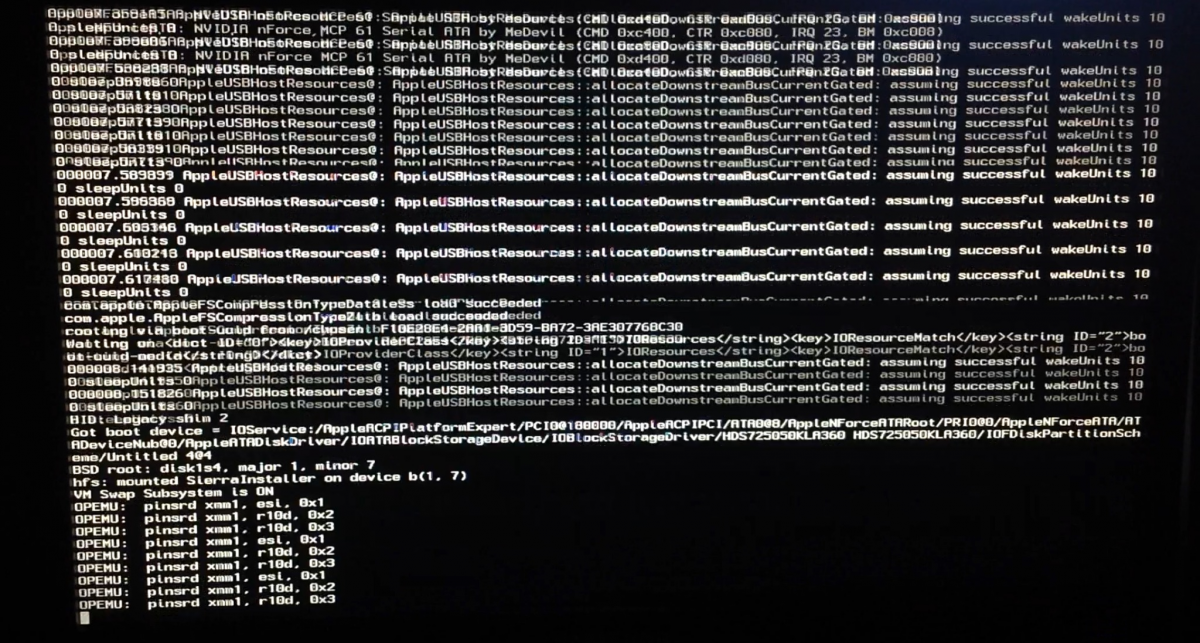

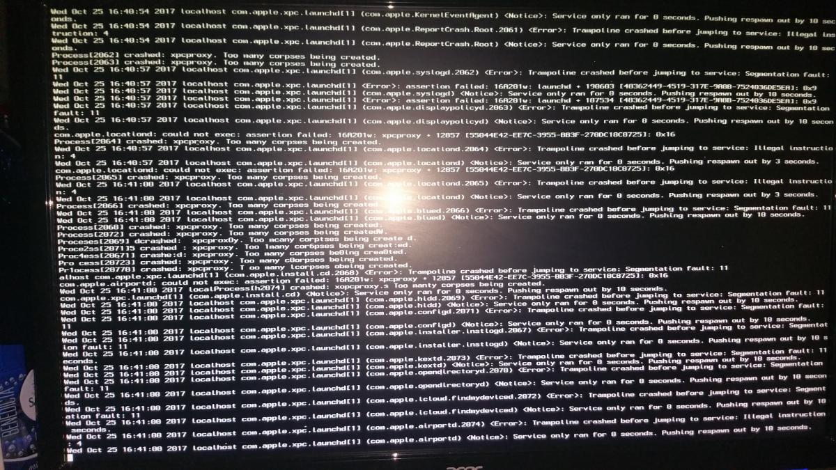

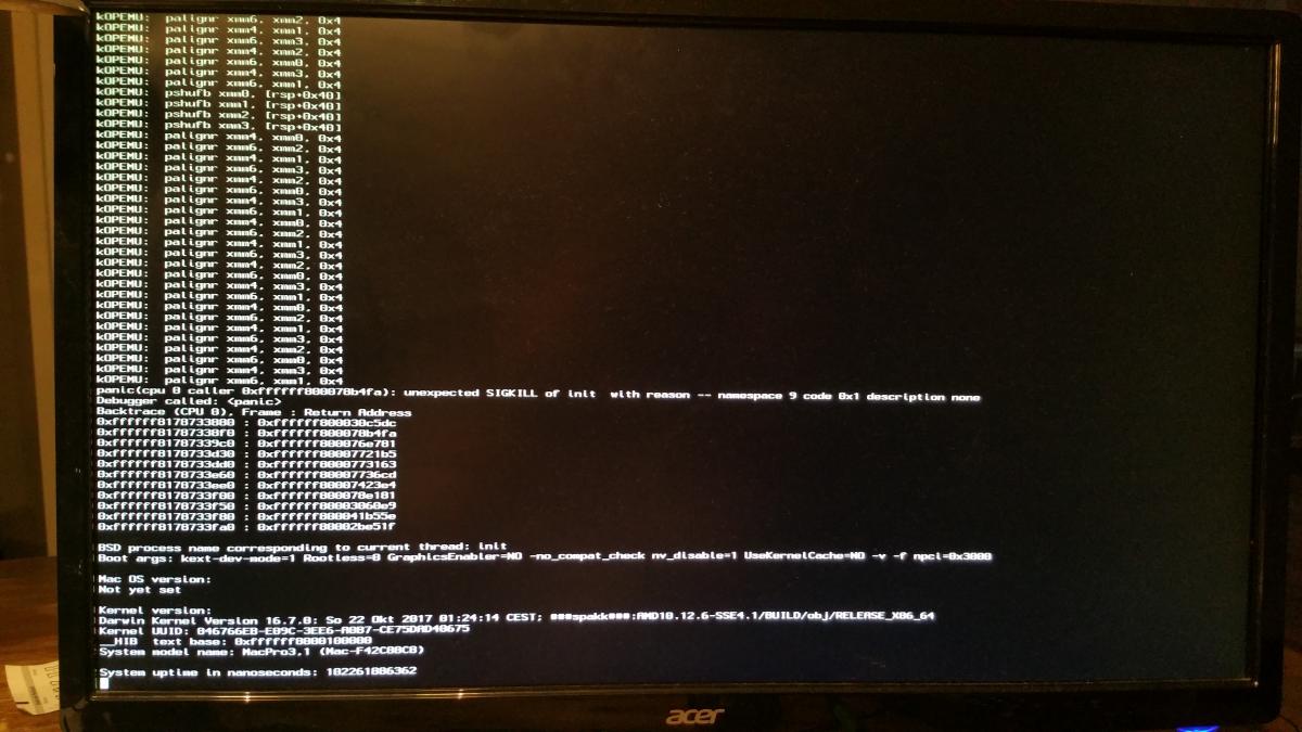

ydeng Posted October 26, 2017 Share Posted October 26, 2017 IMG_1961.PNG IMG_1962.PNG IMG_1964.PNG IMG_1965.PNG IMG_1966.PNG IMG_1967.PNG IMG_1969.PNG I think only printf in sse41.c affected that. But I'll check it with clean sources and report later This looks like some kind of race conditions. The instructions are working. But the results are committed to xmm registers directly. If something else happens between the trap return and thread continuation, content of xmm registers might be missed up. Could you put printk the value of op_obj.ring0 as well? Link to comment https://www.insanelymac.com/forum/topic/322370-task-force-amd-to-missing-sse41-instruction-set-older-cpus-on-macos-sierra-1012x/page/6/#findComment-2523121 Share on other sites More sharing options...
ITzTravelInTime Posted October 26, 2017 Share Posted October 26, 2017 so the emulation is working right? we are close, but there is the need for some check for the results, or other wise the content of the xmm registers will not the rigth, If I have understood correctly Link to comment https://www.insanelymac.com/forum/topic/322370-task-force-amd-to-missing-sse41-instruction-set-older-cpus-on-macos-sierra-1012x/page/6/#findComment-2523130 Share on other sites More sharing options...
AXAXAXAXAXAX Posted October 27, 2017 Share Posted October 27, 2017 This looks like some kind of race conditions. The instructions are working. But the results are committed to xmm registers directly. If something else happens between the trap return and thread continuation, content of xmm registers might be missed up. Could you put printk the value of op_obj.ring0 as well?It is always 0 Link to comment https://www.insanelymac.com/forum/topic/322370-task-force-amd-to-missing-sse41-instruction-set-older-cpus-on-macos-sierra-1012x/page/6/#findComment-2523154 Share on other sites More sharing options...
