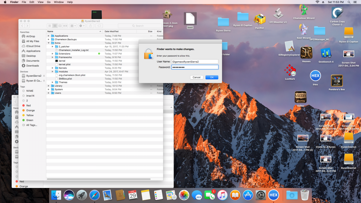

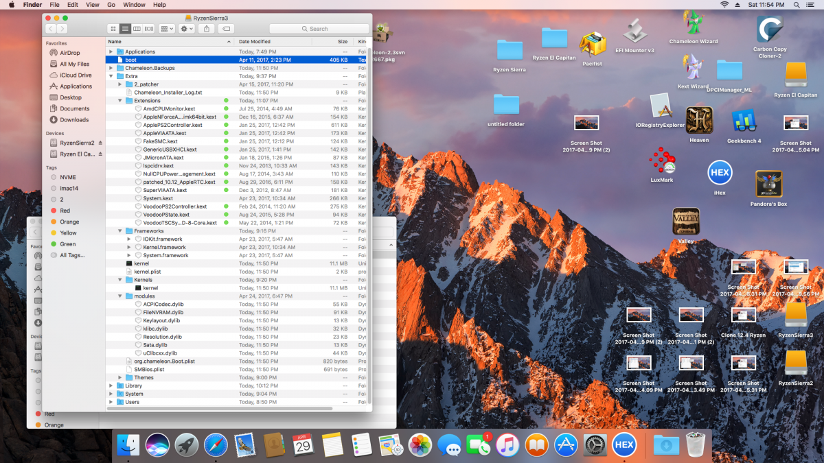

Gigamaxx Posted April 30, 2017 Share Posted April 30, 2017 What kexts did you use in your extra folder? Are you able to upload your files / configs? I am having no luck at all :I Did you study my Gigabyte bios settings? Try to mimic that on your Asus board as best you can. I switched out processors and Bios reset, so I followed my bios settings pics. I'm just finished cloning and want to do a few more things before I reboot, if it will? Wish me luck. Other important things Ethernet and Wifi are needed to clear as well as the most important graphics support. Do you have the proper hardware (supported) like graphics card, Wifi, Bluetooth, and Ethernet? It wants to hang at each of those and stops you. Download: Pacifist, kext wizard, Chameleon wizard, EFIMounter, and (IORegistryExplorer and iHex optional). I'll do what I can and explain how I made my bootloader "low tech" and Kernel placement. Kexts will depend on your hardware a bit but you can probably get it working. I have realtec8111 Ethernet, Atheros 93xx Wifi, and Nvidia 8400gs which all run natively in OsX. Link to comment https://www.insanelymac.com/forum/topic/322268-help-topic-ryzen-macos-1012x-sierra/page/3/#findComment-2414730 Share on other sites More sharing options...

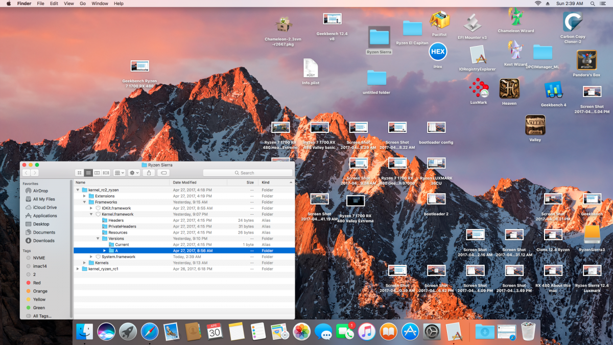

tikizondo94 Posted April 30, 2017 Share Posted April 30, 2017 Install a fresh copy of Sierra and then update it to latest version 12.4, and leave it alone. Instal only the Bronya files Merge them don't replace.. There is a trick to one of the Framework files to get it to set. Select the A- folder and merge it with the existing folder. you can't replace it. see pic for A- folder. Add all these folders to S/L/(Extensions, Frameworks and Kernels) folders. Don't forget to use Kext Wizzard after to clear caches. Don't add the space files to S/L/E yet they are not necessary to boot. I added them to Extra "extensions" folder but am not sure if they are loading. They may be needed to smooth out things later but all you need are the basics provided by Bronya to get started. Download and run Chameleon 2667, use custom settings. See pics. I'll post more soon here so come back to this page. You will need to use your own serial number for the Mac Pro 6.1 definiition. Where did you find your voodooTSCsyncAMD-8-core.kext? I noticed it in your Extra/Extensions.. Link to comment https://www.insanelymac.com/forum/topic/322268-help-topic-ryzen-macos-1012x-sierra/page/3/#findComment-2414909 Share on other sites More sharing options...
Gigamaxx Posted April 30, 2017 Share Posted April 30, 2017 Where did you find your voodooTSCsyncAMD-8-core.kext? I noticed it in your Extra/Extensions..These are files from Spakk. The Rysen Kernel testing thread around pg 2-5 somewhere. They are not in S/L/Extensions, just leave inside the Extra folder in boot loader. Here I added them for you. I believe they are scanning and trying to load as the boot process is long and full of attempted kext loading. See the stuff on top? The bottom lines are the normal loading the top look like atttmepted loading of the Extra folders extensions files. I will remove them later and try to narrow down the Extra folder to only essential kexts. But for now it works. Ryzen Essentials 2.zip 1 Link to comment https://www.insanelymac.com/forum/topic/322268-help-topic-ryzen-macos-1012x-sierra/page/3/#findComment-2414913 Share on other sites More sharing options...

jaytarang92 Posted May 1, 2017 Share Posted May 1, 2017 Install a fresh copy of Sierra and then update it to latest version 12.4, and leave it alone. Instal only the Bronya files Merge them don't replace.. There is a trick to one of the Framework files to get it to set. Select the A- folder and merge it with the existing folder. you can't replace it. see pic for A- folder. Add all these folders to S/L/(Extensions, Frameworks and Kernels) folders. Don't forget to use Kext Wizzard after to clear caches. Don't add the space files to S/L/E yet they are not necessary to boot. I added them to Extra "extensions" folder but am not sure if they are loading. They may be needed to smooth out things later but all you need are the basics provided by Bronya to get started. Download and run Chameleon 2667, use custom settings. See pics. I'll post more soon here so come back to this page. You will need to use your own serial number for the Mac Pro 6.1 definiition. So clone a running Mac and then modify it? I will try this out . I have been attempting to run the installer. Thanks, Link to comment https://www.insanelymac.com/forum/topic/322268-help-topic-ryzen-macos-1012x-sierra/page/3/#findComment-2415300 Share on other sites More sharing options...

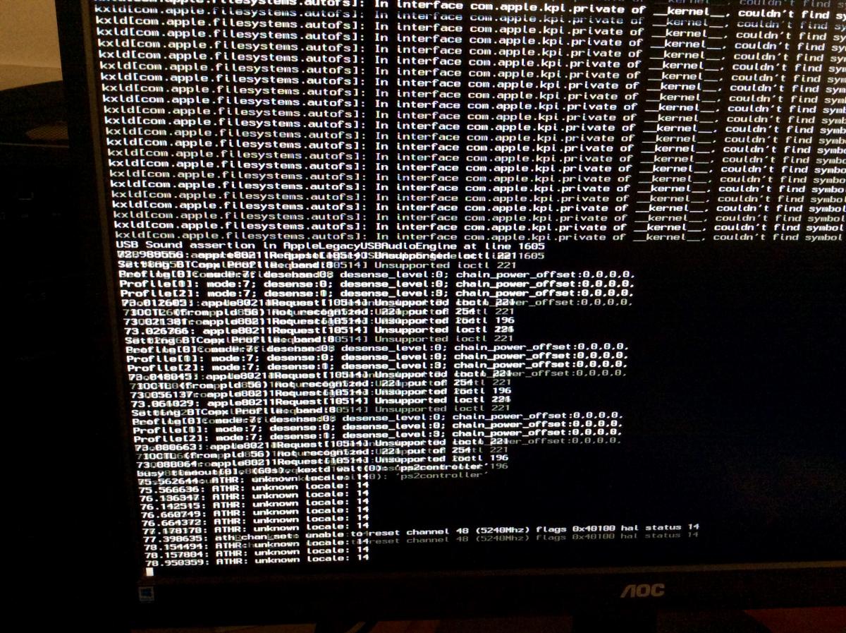

matthew. Posted May 1, 2017 Share Posted May 1, 2017 Not sure what I'm doing wrong here. I copied the kernel, kexts and frameworks into their respective directories and booted with -v -x npci=0x2000 GraphicsEnabler=no -UseKernelCache=no It does some booting stuff, hangs and then powers off after a minute. Does anybody have any ideas? I recorded a video showing what happens Link to comment https://www.insanelymac.com/forum/topic/322268-help-topic-ryzen-macos-1012x-sierra/page/3/#findComment-2415422 Share on other sites More sharing options...
Gigamaxx Posted May 1, 2017 Share Posted May 1, 2017 Not sure what I'm doing wrong here. I copied the kernel, kexts and frameworks into their respective directories and booted with -v -x npci=0x2000 GraphicsEnabler=no -UseKernelCache=no It does some booting stuff, hangs and then powers off after a minute. Does anybody have any ideas? I recorded a video showing what happens did you try npci=0x3000? Link to comment https://www.insanelymac.com/forum/topic/322268-help-topic-ryzen-macos-1012x-sierra/page/3/#findComment-2415443 Share on other sites More sharing options...
