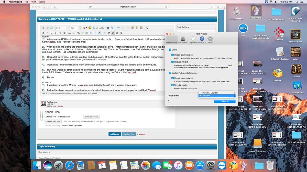

There are a few kext utilities out there, which one are you using and have you tried it with a different one? Xerxes, kext wizard, kext beast? I have had mixed results with kext beast in the past and only use kext wizzard or Xerxes (pandoras box).
Did you use the terminal code, to generate the kernelCache and PrelinkedKernel that AkimoA has described? If no, then please do it. We assume that the Sierra partition is "SIERRA", keep the name as simple as possible without spaces, etc.
I know and I always (on hackintoshes and on real macs) used the "Kext Utility" with no issues at all.
Btw, I also did a try with Kext Wizard (same story). I will try Pandora's Xerxes tool, fingers crossed.

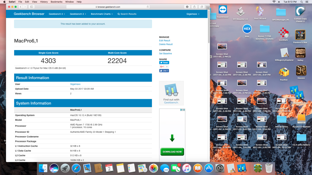

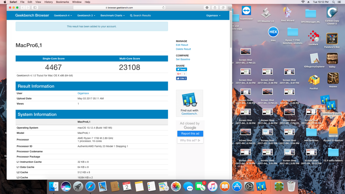

I did some overclocking tests and found that underclocking outperforms overclocking.
For my Ryzen 7 1700 with bustratio=29 underclocking to 2,9 and 2.8 increases single core performance as well as multi score.    See below settings 3.0, 2.9, 2.8, and 3.6 GHz settings.     I will try again tonight and set busratio=3.5 and set to 3.5 GHZ CPU freq.     My gigabyte AB350 gaming doesnt allow for CPU voltage increases or at least I haven't been able to use anything but Auto setting.     I picked up a new Gigabyte AX370 Aurus Gaming K5 board and will set up tonight to try overclocking with voltage adjustments and busratio=x settings and to get better PCI lane support for my RX 480.    I was able to break 100,000 on Geekbench with the RX last night. see last pic.

I did some testing, I removed busratio=x and dart=0 so that all I had in Chameleon org boot plist was ncpi=0x3000 PCIRootUID=1.

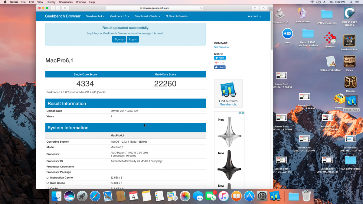

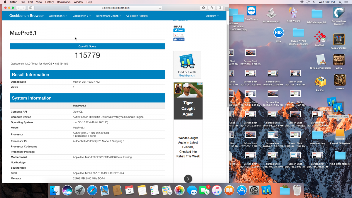

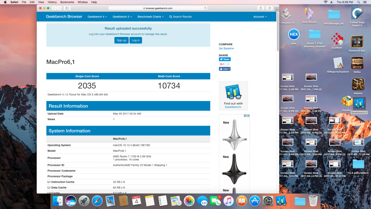

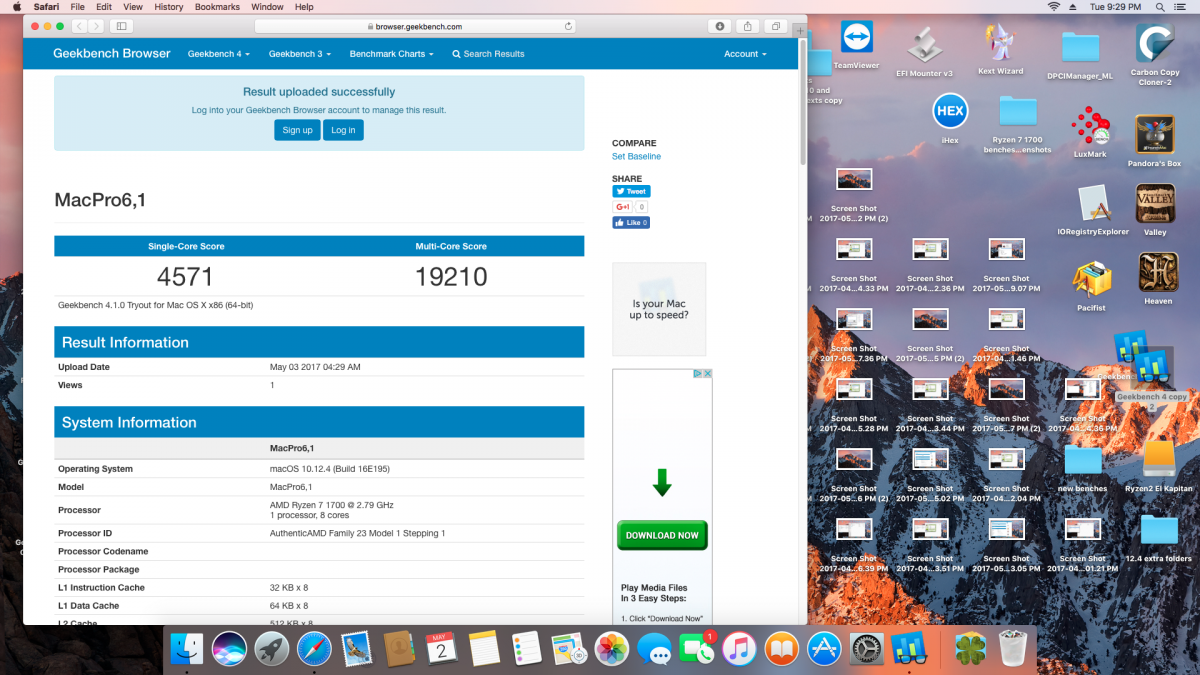

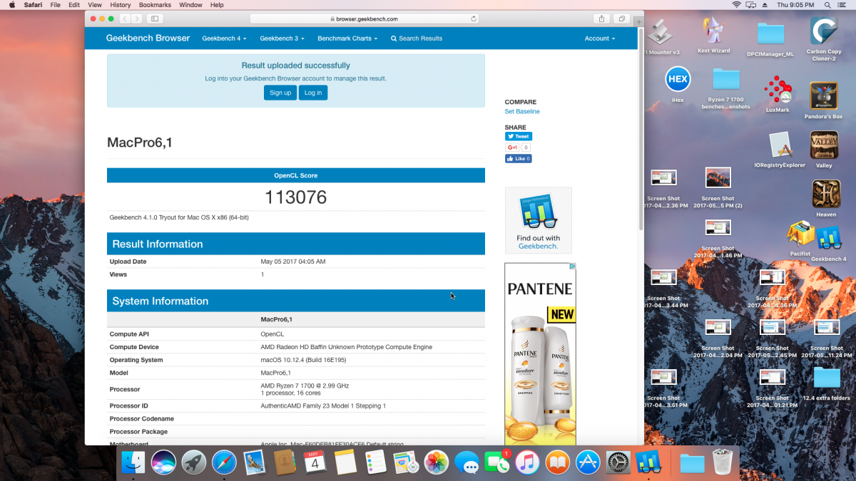

I may have found your problem with power at 1/2 of normal (first 2 pics).    I added them back and got my normal performance level +- (last 2 picks).
I'm not sure but it may work that way. I will test later but if you find any results let us know. It could be that setting this ratio (low) at boot is giving us problems if overclocking.

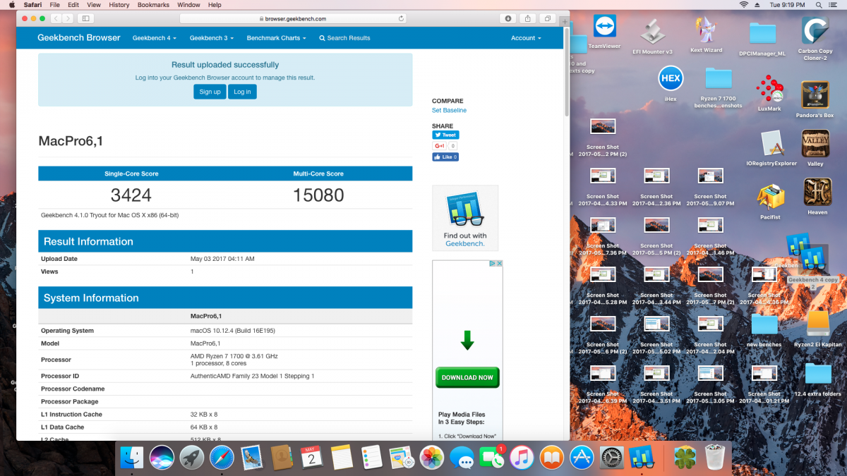

I tested with busratio=35 and set bios overclock to 3.5GHz and it was unstable, wifi disabled, apps crashed etc...., no good.
I tested with busratio=32 bios OC @3.2GHz unstable, wifi disabled, apps crashed..
I set busratio=29 and bios to 29 back to stable.
I set busratio=29 and bios OC @3.2GHz and it was stable but benchmarks are lower, less performance.
The sweet spot for my Ryzen 7 1700 seems to be busratio=29 and bios CPU frequency set 2900MHZ or 2.9 GHz.
Conclusion, overclocking Ryzen 7 1700 in macOS Sierra does not gain performance but rather decreases performance using my current configuration. It would be nice to be able to overclock these chips and get away with it.

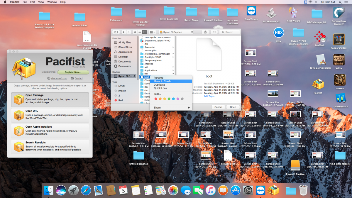

You cannot boot from the USB to disk drive after the install. You need to install the boot loader on the disk drive itself. You have a couple quick easy options that I know of. The second one is best if you have a working Mac or Hack.
Note: This is also necessary to do after using Carbon Copy Cloner or disk utility to clone a copy disk. It will not boot until this procedure or something similar is done.
Option 1
1). After creating USB boot loader add an extra folder labeled tools. Copy your Extra folder files to it, Chameleon/enoch, Kext Wizzard, and "Pacifist" software (free).
2). When booted into Sierra use chameleon/enoch to target disk drive. After its installed open Pacifist and select the disk drive it should show up like the pic below. Select the "boot" file (The is the Chameleon boot file installed not Bronya boot file) and move to trash. go to top tool bar and quit Pacifist.
3). Open disk drive folder in Finder window, and drag a copy of the Bronya boot file to the folder at bottom below Users. It will place itself under Applications after you authorize it to folder.
4). Open extra folder on disk drive folder and check and place all necessary files and folders, plists and modules.
5). Run Kext wizard or other utility to fix permissions and rebuild caches. ( Kext Wizzard can rebuild both S/L/E and the boot loader E/E folders). **Make sure to select proper drives when using pacifist and Kext wizzard.
6). Reboot.
Option 2
1). If you have a working Mac or Hackintosh plug disk drive(install) into it via usb or sata port.
2). Follow the above instructions and make sure to select the proper drive when using pacifist and Kext Wizzard
