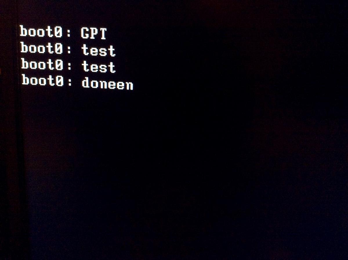

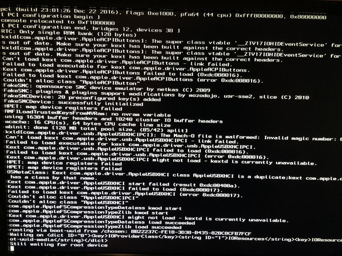

Gigamaxx Posted April 16, 2017 Share Posted April 16, 2017 Clover 3650/Mavericks new boot error, it's not red panic. 2 Link to comment https://www.insanelymac.com/forum/topic/322268-help-topic-ryzen-macos-1012x-sierra/page/2/#findComment-2405585 Share on other sites More sharing options...
spakk Posted April 16, 2017 Author Share Posted April 16, 2017 Clover 3650/Mavericks new boot error, it's not red panic. IMG_2688.JPG Boot0: doneen => to the devil what does that mean?... i could'nt find anything.... hmm.. or is this only a typo mistake into clover and should mean "done"? this is just a guess 1 Link to comment https://www.insanelymac.com/forum/topic/322268-help-topic-ryzen-macos-1012x-sierra/page/2/#findComment-2405694 Share on other sites More sharing options...

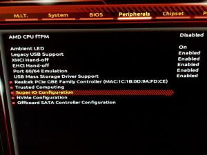

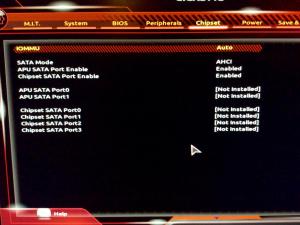

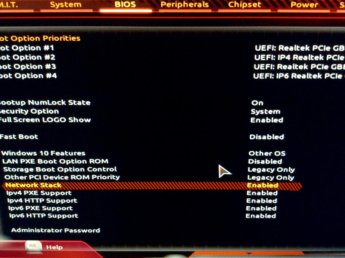

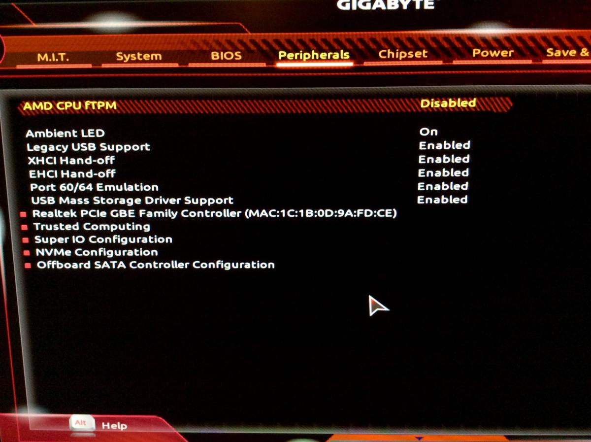

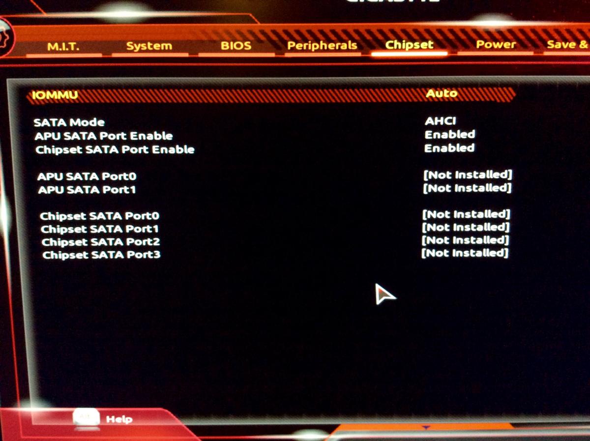

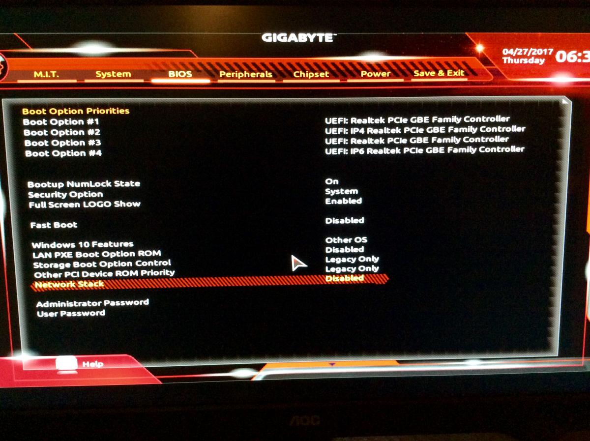

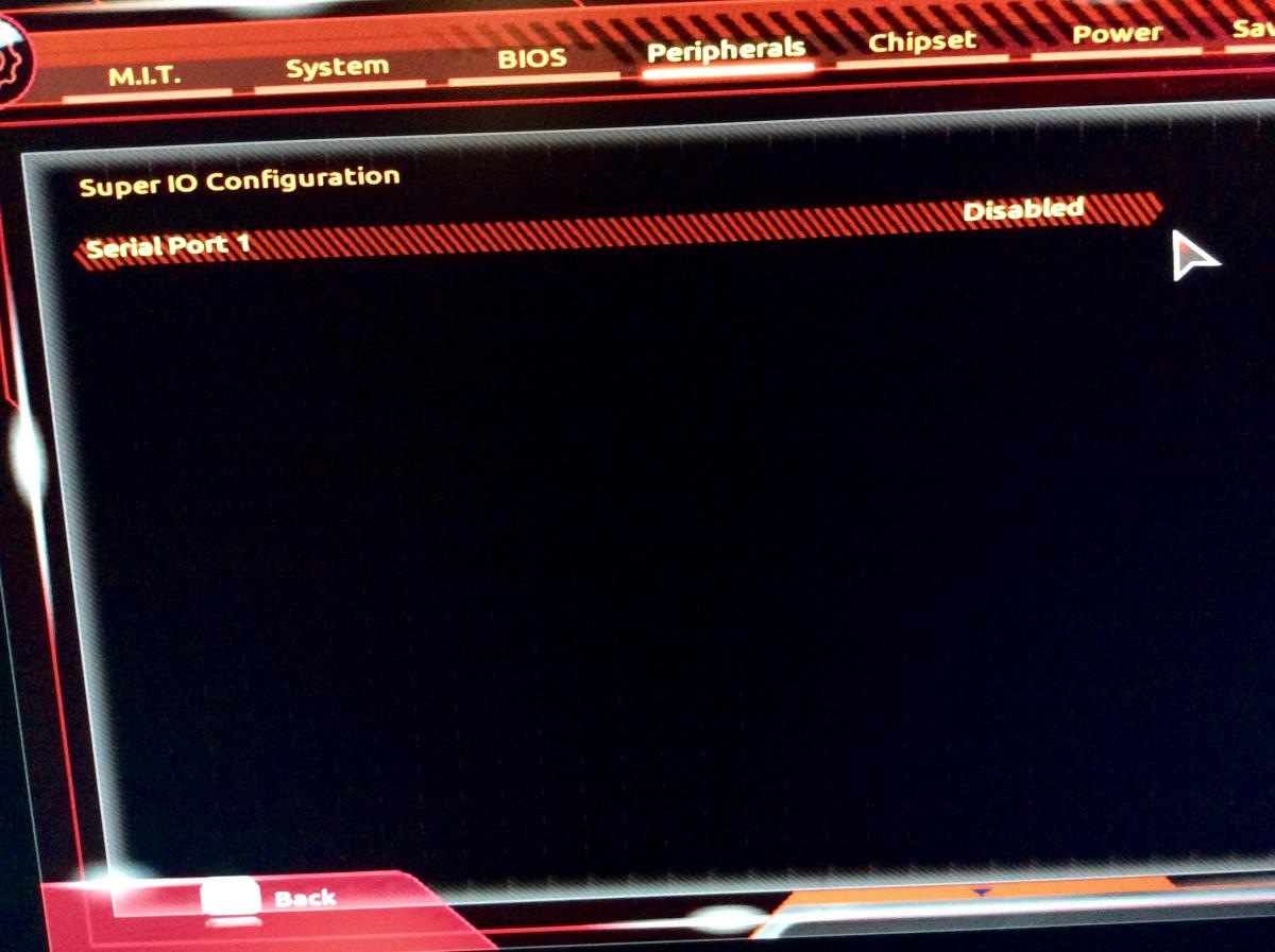

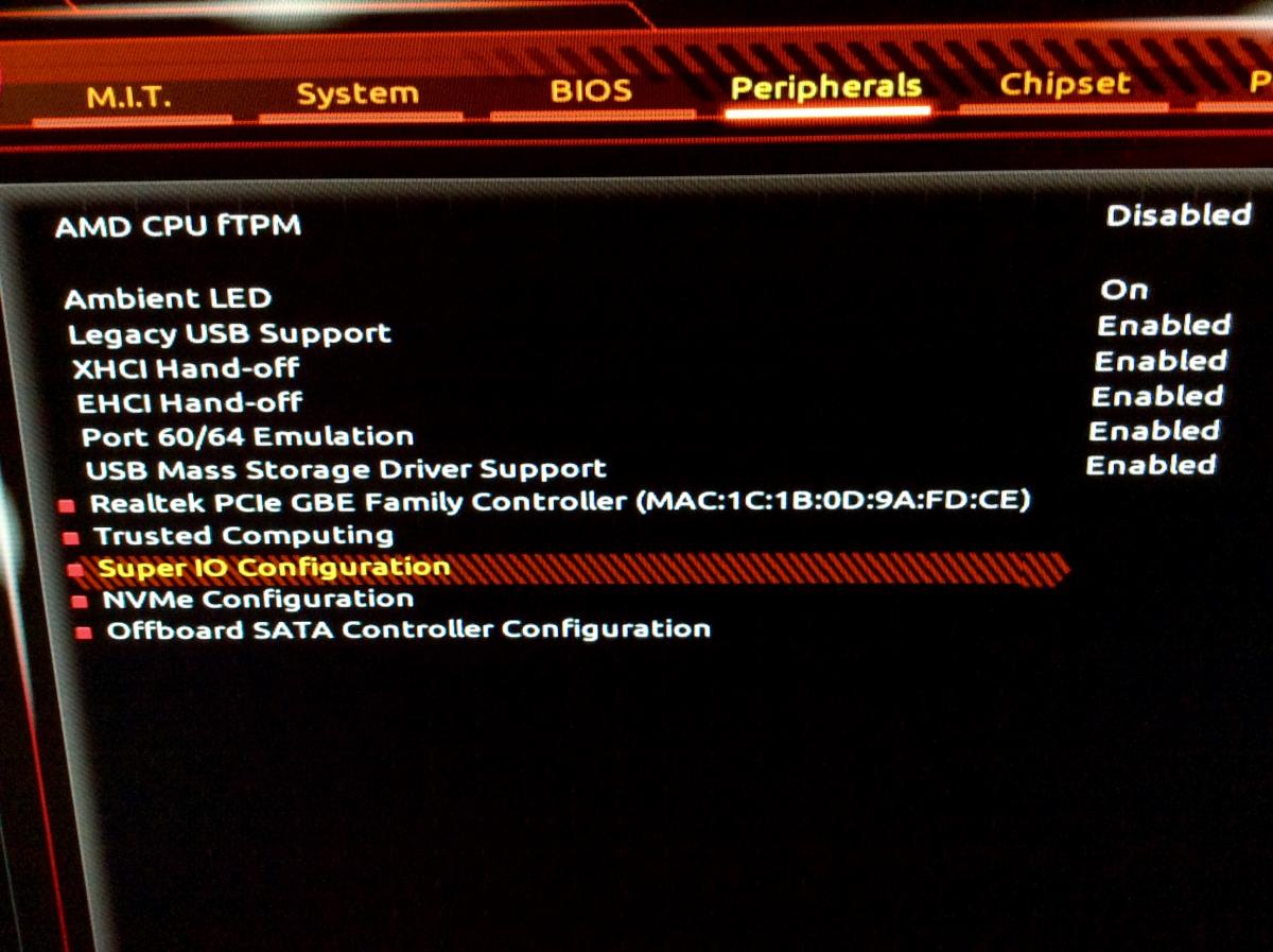

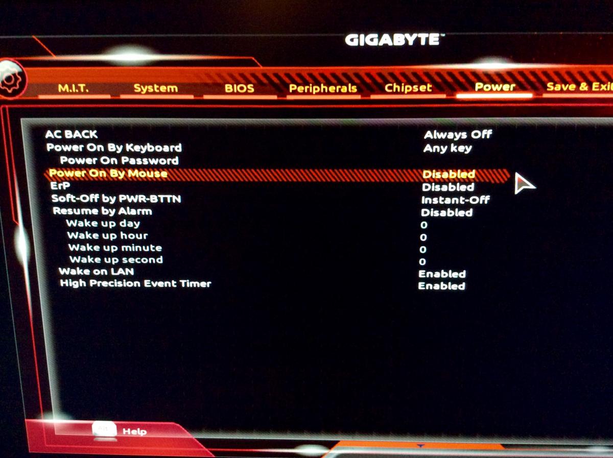

Gigamaxx Posted April 27, 2017 Share Posted April 27, 2017 Here are some Bios settings for Gigabyte AB350 gaming AM4 motherboard for Ryzen El Capitan install. Key points: enable network stack, and disable Serial port. Link to comment https://www.insanelymac.com/forum/topic/322268-help-topic-ryzen-macos-1012x-sierra/page/2/#findComment-2413295 Share on other sites More sharing options...

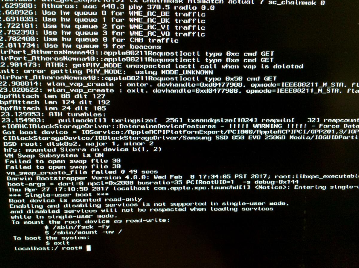

Gigamaxx Posted April 28, 2017 Share Posted April 28, 2017 It's getting closer, but it either shuts down, or with single user give this message. Any solutions? Link to comment https://www.insanelymac.com/forum/topic/322268-help-topic-ryzen-macos-1012x-sierra/page/2/#findComment-2413476 Share on other sites More sharing options...

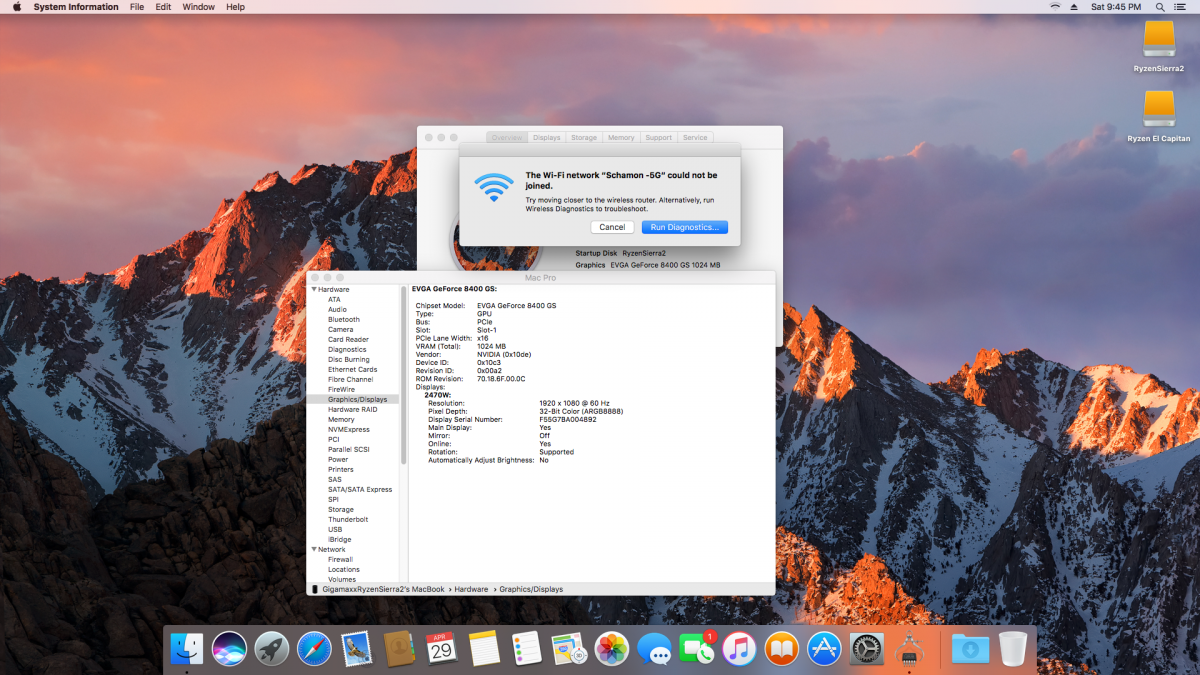

Gigamaxx Posted April 30, 2017 Share Posted April 30, 2017 Finally In, I was making it too complicated for myself. Started anew with a fresh 12.4 install and a fairly simple configuration. 1 Link to comment https://www.insanelymac.com/forum/topic/322268-help-topic-ryzen-macos-1012x-sierra/page/2/#findComment-2414700 Share on other sites More sharing options...
