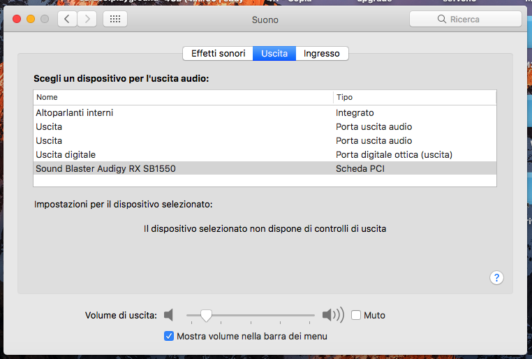

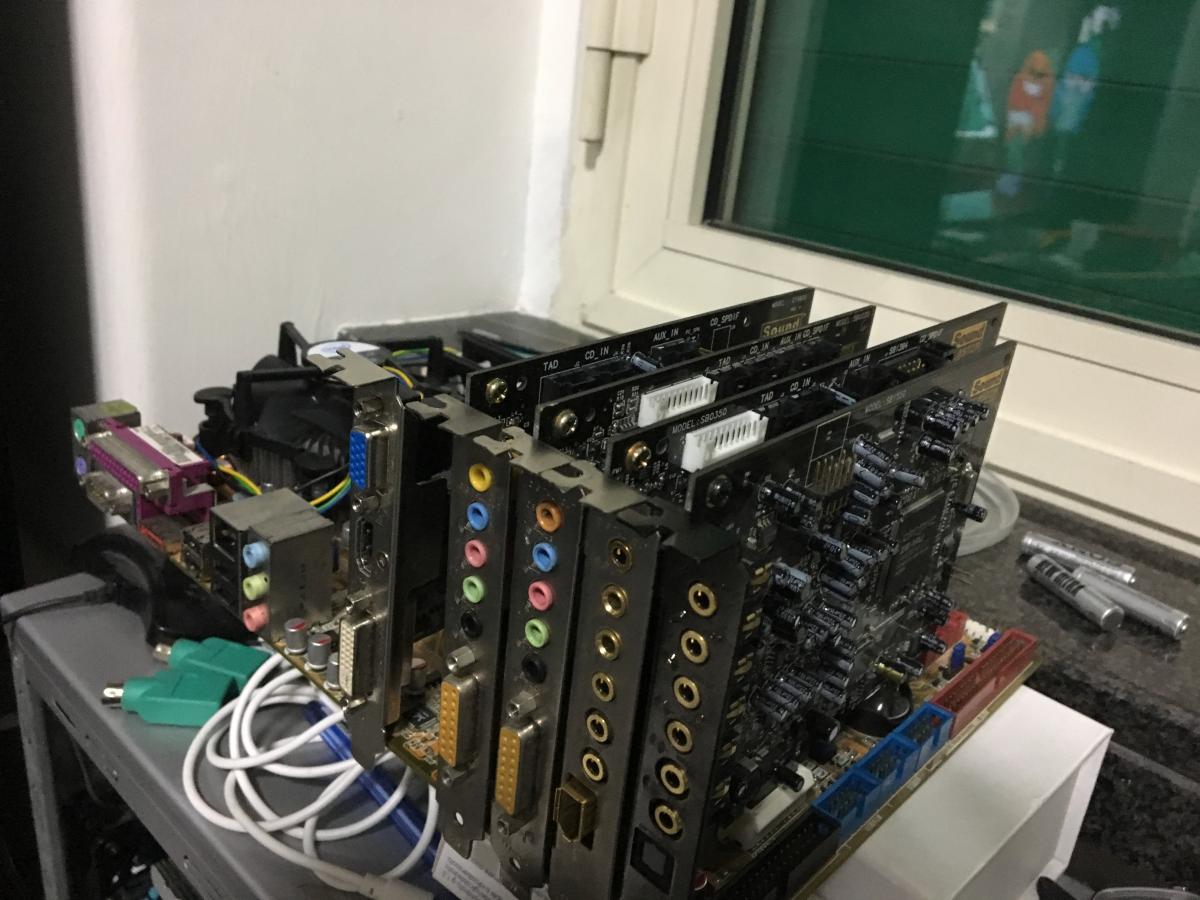

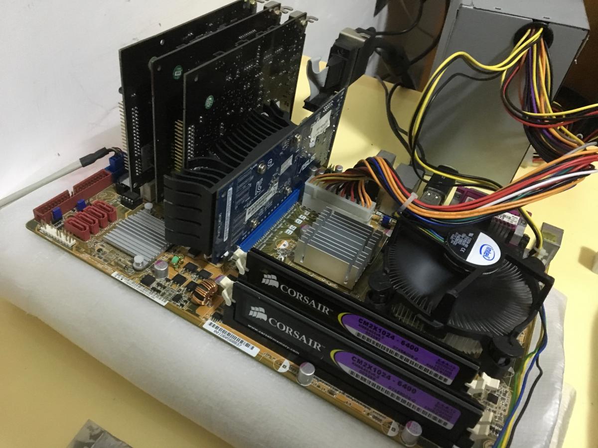

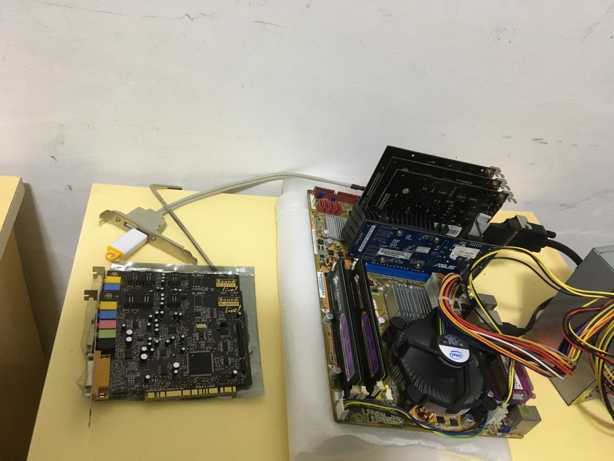

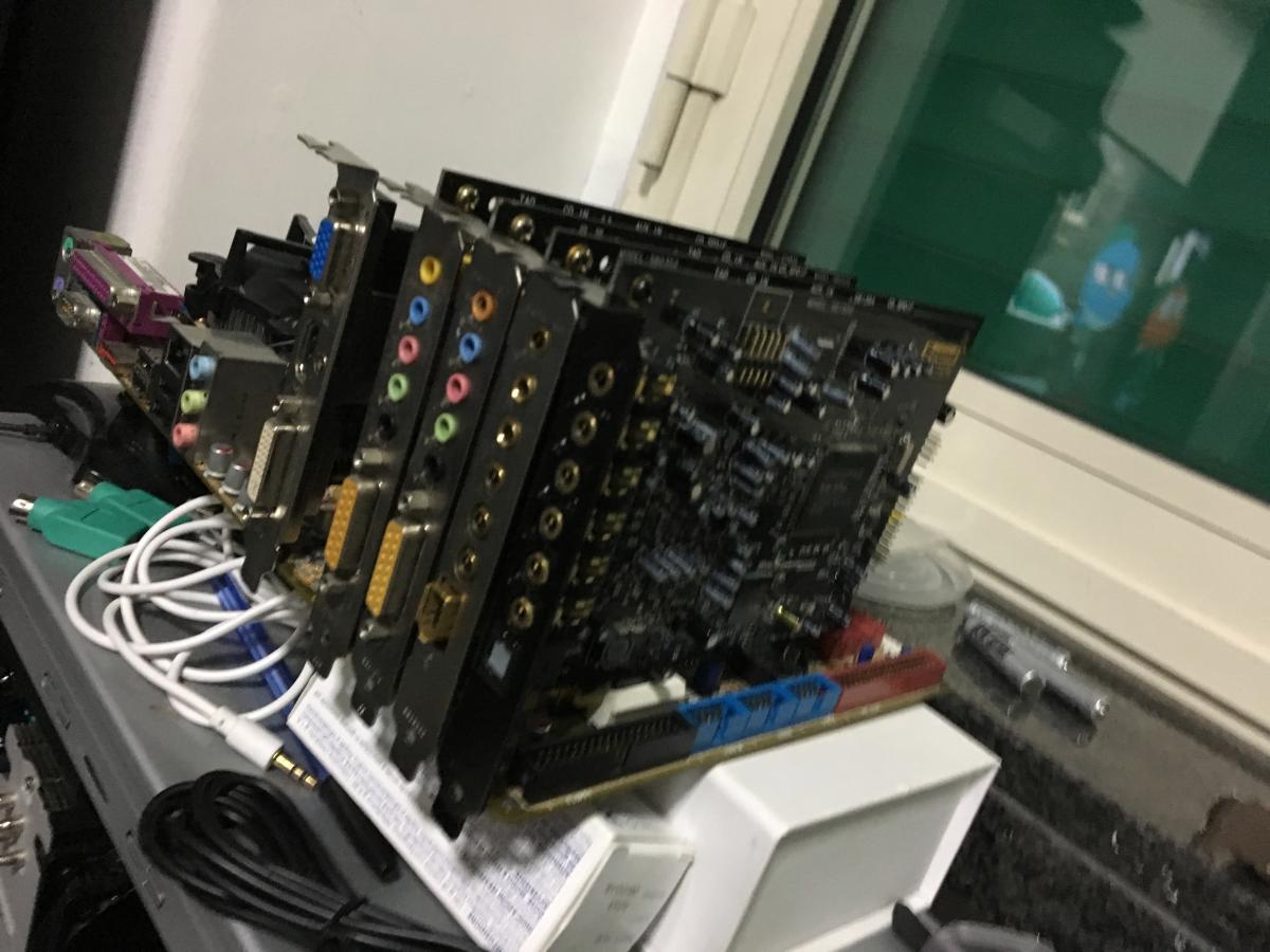

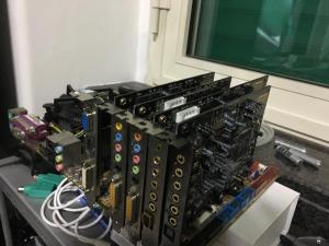

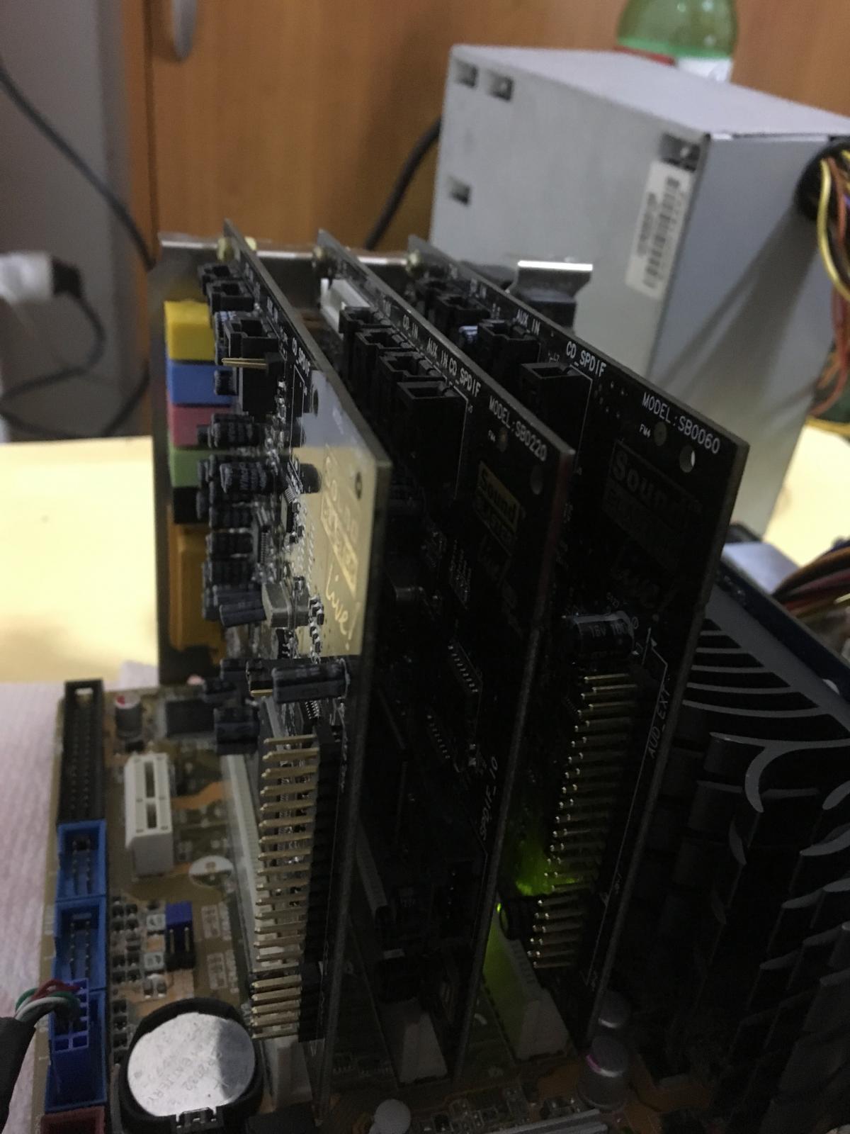

Just some pictures from the last test sessions of the driver, i used a socket 775 system with an asus, p5b se, 2gb of ddr2 800 ram, pentium dual core e2200, geforce 210, on mac os x yosemite, i used a lot of cards at the same time to see what the driver does: i used the sound blaster live ct4830 (3 of them), sb0060, sb0220 audigy 2 zs sb0350, and the only compatible pcie card i have tested, the sound blaster audigy rx, for now the driver initializes all the cards, but only a random one will appear in system preferences as usable audio device, i am still finding a solution to how to let the driver to show all the devices in system preferences
Have you tried the same setup with El Capitan and Sierra?
