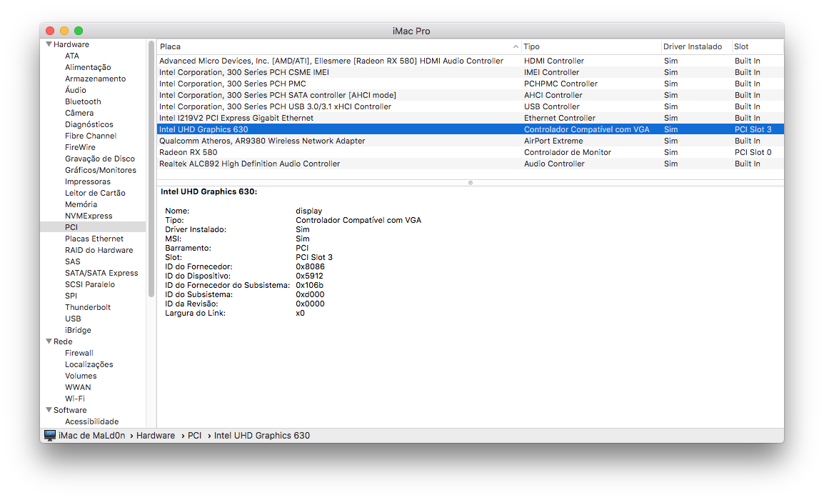

7 hours ago, MaLd0n said:
i see others users with same problem with 4k
u can se both gpus for hardware acceleration
Intel UHD Graphics appears visible under Hardware\PCI

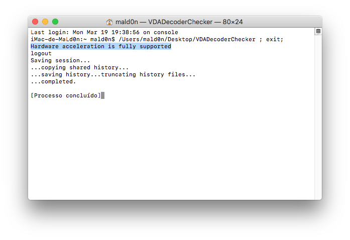

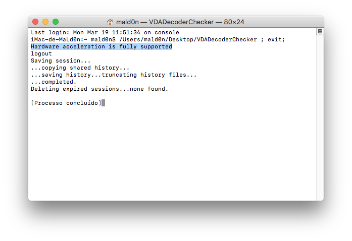

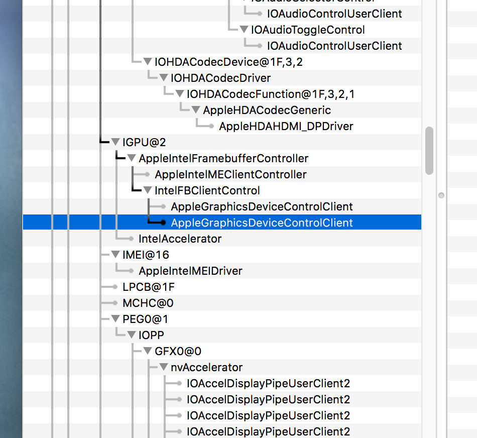

work for me
-IntelGFX 0x59128086
-InjectIntel
-ig-platform-id 0x59120003
-IntelGraphics enable in bios
-DVMT 128
-IntelGraphicsFixup.kext
-Shiki.kext
dont need flag shikigva with last Shiki version

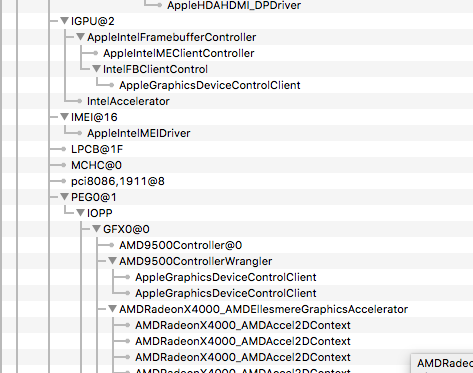

It looks different. @my IGPU@2 I have 2 times AppleGraphicsDeviceControlClient. Is that related with the amount ports?

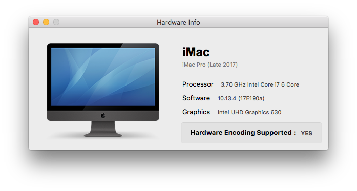

check with MacX Video Converter Pro.app
I see nVidia GT1080Ti only there so its not working correctly.
