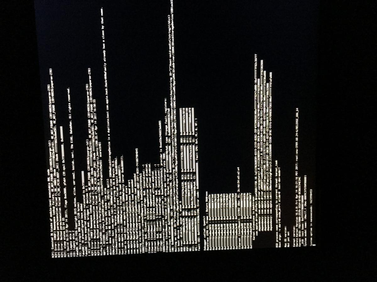

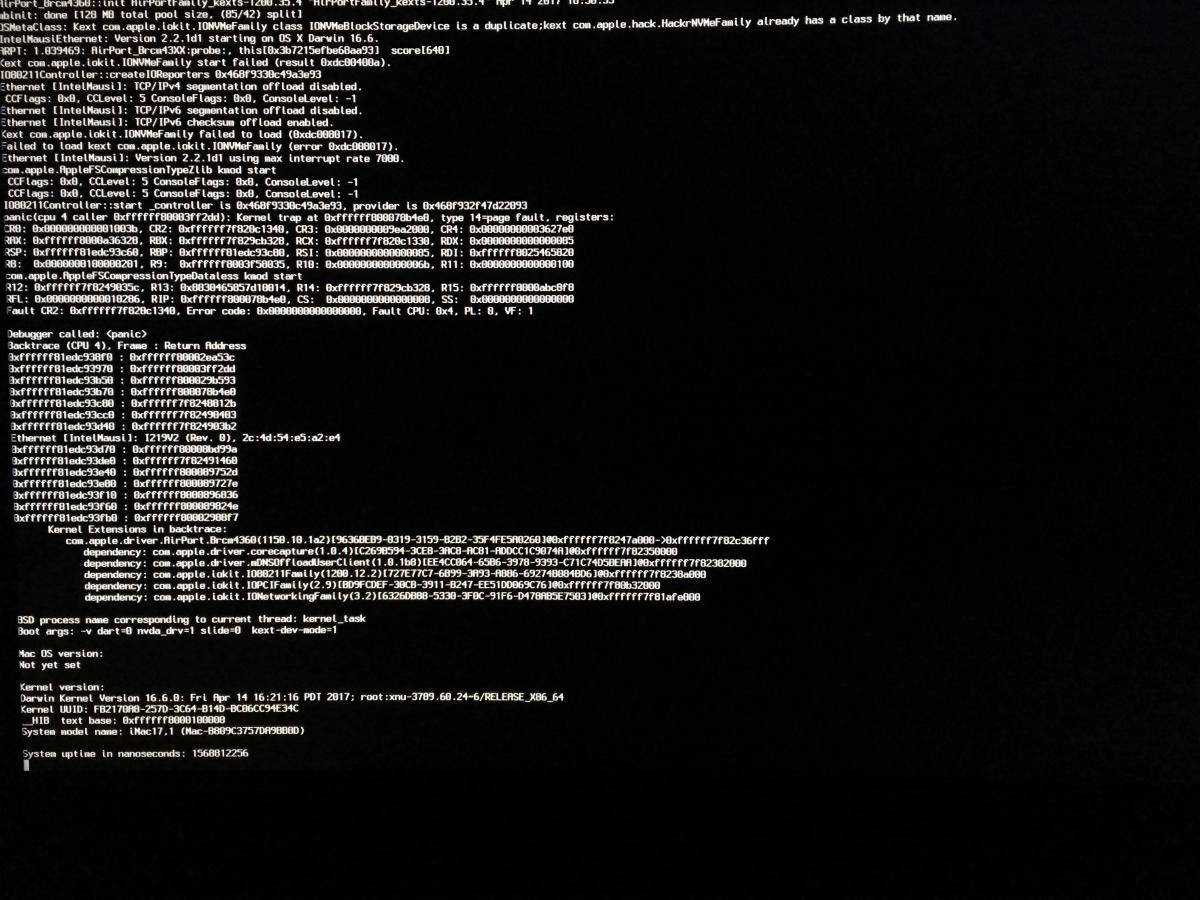

UltraLaser Posted May 16, 2017 Share Posted May 16, 2017 Hey Mald0n, I've bought the NVMe MZ-V6E250BW 960 EVO, create the kext like this guide but at reboot I have KP! What can be wrong? ssdt? 1 Link to comment Share on other sites More sharing options...

MaLd0n Posted May 16, 2017 Author Share Posted May 16, 2017 Hey Mald0n, I've bought the NVMe MZ-V6E250BW 960 EVO, create the kext like this guide but at reboot I have KP! What can be wrong? ssdt? U use patch in config.plist or Kext? Link to comment Share on other sites More sharing options...
UltraLaser Posted May 16, 2017 Share Posted May 16, 2017 Only kext in sle 1 Link to comment Share on other sites More sharing options...
MaLd0n Posted May 16, 2017 Author Share Posted May 16, 2017 I think I have everything working expect for audio if I go into settings theres 2 built-in line outputs 1 built-in Output and 1 built-in Digital Output which is my speakers which are plug in there the green port on my motherboard what ur GPU? Only kext in sle Rehabman kext? Link to comment Share on other sites More sharing options...
UltraLaser Posted May 16, 2017 Share Posted May 16, 2017 Rehabman kext? Yes 1 Link to comment Share on other sites More sharing options...
MaLd0n Posted May 16, 2017 Author Share Posted May 16, 2017 Yes Use patch in config.plist, if u use kext u need XDSM patch and KILL all _DSM into DSDT what system u have? 10.12.4 or 5? Post ur config.plist I think I have everything working expect for audio if I go into settings theres 2 built-in line outputs 1 built-in Output and 1 built-in Digital Output which is my speakers which are plug in there the green port on my motherboard Check CLOVER.zip Hi. I have a question. I want to solve the iBooks problem with the nvidia web driver by enable the embedded intel graphics. I enable the embedded Intel Griphics and inject Intel in clover. However, I will always boot to a black screen. Is it because of the parched DSDT. Should I give you the same files for you to analyse? Other solution for nvidia web driver problem is also welcome Thanks if u use DGPU disable intel HD Link to comment Share on other sites More sharing options...
