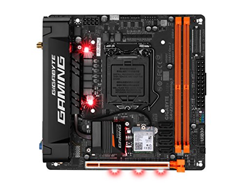

UltraLaser Posted May 6, 2017 Share Posted May 6, 2017 Hi MaLd0n, I have a problem with my mobo (DDR4 bios problem) and Asus won't solve ...I was going to make me change to a Gigabyte GA-Z270N Gaming 5. do you think there may be problems with a hack? 1 Link to comment Share on other sites More sharing options...
MaLd0n Posted May 6, 2017 Author Share Posted May 6, 2017 Good! Asus, Giga, Asrock, etc work, but Asus and Giga is best for me. Link to comment Share on other sites More sharing options...
