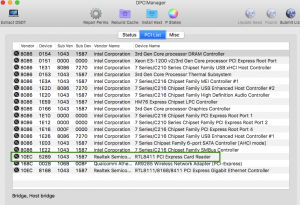

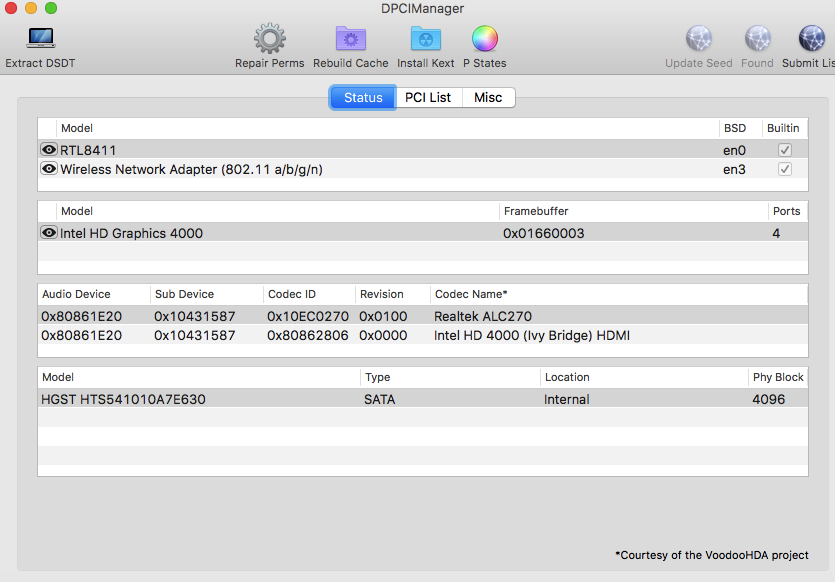

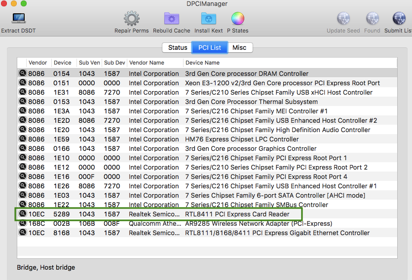

rage75 Posted February 5, 2018 Author Share Posted February 5, 2018 Scusate ma mi sono accorto anche perché non l' ho mai usato che non va il lettore SD, c'è un modo per farlo andare? Link to comment https://www.insanelymac.com/forum/topic/317769-installazione-sierra-su-asus-k56cb/page/18/#findComment-2585038 Share on other sites More sharing options...
foskvs Posted February 5, 2018 Share Posted February 5, 2018 Modello? Link to comment https://www.insanelymac.com/forum/topic/317769-installazione-sierra-su-asus-k56cb/page/18/#findComment-2585057 Share on other sites More sharing options...
rage75 Posted February 5, 2018 Author Share Posted February 5, 2018 Dovrebbe essere Realtek, dove lo vedo? Link to comment https://www.insanelymac.com/forum/topic/317769-installazione-sierra-su-asus-k56cb/page/18/#findComment-2585107 Share on other sites More sharing options...
foskvs Posted February 5, 2018 Share Posted February 5, 2018 DPCIManager o Windows. Link to comment https://www.insanelymac.com/forum/topic/317769-installazione-sierra-su-asus-k56cb/page/18/#findComment-2585324 Share on other sites More sharing options...
rage75 Posted February 5, 2018 Author Share Posted February 5, 2018 http://www.insanelymac.com/forum/topic/317769-installazione-sierra-su-asus-k56cb/page-3?do=findComment&comment=2318876 Link to comment https://www.insanelymac.com/forum/topic/317769-installazione-sierra-su-asus-k56cb/page/18/#findComment-2585383 Share on other sites More sharing options...
foskvs Posted February 6, 2018 Share Posted February 6, 2018 http://www.insanelymac.com/forum/topic/321080-sineteks-driver-for-realtek-rtsx-sdhc-card-readers/page-3?do=findComment&comment=2376387 Link to comment https://www.insanelymac.com/forum/topic/317769-installazione-sierra-su-asus-k56cb/page/18/#findComment-2585548 Share on other sites More sharing options...
rage75 Posted February 7, 2018 Author Share Posted February 7, 2018 Scusa il ritardo nella risposta foskvs, provato sinetek.kext sia in Efi che in S/L/E, non funziona. Link to comment https://www.insanelymac.com/forum/topic/317769-installazione-sierra-su-asus-k56cb/page/18/#findComment-2586646 Share on other sites More sharing options...
foskvs Posted February 7, 2018 Share Posted February 7, 2018 Puoi allegare hack_Info e ioreg con il kext? Link to comment https://www.insanelymac.com/forum/topic/317769-installazione-sierra-su-asus-k56cb/page/18/#findComment-2586655 Share on other sites More sharing options...
rage75 Posted February 7, 2018 Author Share Posted February 7, 2018 Ecco. HackInfo_Report.zip MacBook Pro di rage75.zip Link to comment https://www.insanelymac.com/forum/topic/317769-installazione-sierra-su-asus-k56cb/page/18/#findComment-2586701 Share on other sites More sharing options...
foskvs Posted February 7, 2018 Share Posted February 7, 2018 Strano che il lettore di schede si chiami GLAN... Allega config.plist e DSDT. Link to comment https://www.insanelymac.com/forum/topic/317769-installazione-sierra-su-asus-k56cb/page/18/#findComment-2586887 Share on other sites More sharing options...
rage75 Posted February 7, 2018 Author Share Posted February 7, 2018 Ho rimosso Apple e temi vari, posto la Efi intera, ecco se vuoi domani controllo da Linux se riesco a vedere il nome del lettore DSDT.aml.zip EFI.zip Link to comment https://www.insanelymac.com/forum/topic/317769-installazione-sierra-su-asus-k56cb/page/18/#findComment-2587028 Share on other sites More sharing options...
foskvs Posted February 8, 2018 Share Posted February 8, 2018 Inserisci una scheda SD che funziona su Windows o Linux, poi apri il terminale e scrivi system_profiler SPStorageDataType Posta quello che ti mostra. Link to comment https://www.insanelymac.com/forum/topic/317769-installazione-sierra-su-asus-k56cb/page/18/#findComment-2587244 Share on other sites More sharing options...
rage75 Posted February 8, 2018 Author Share Posted February 8, 2018 Non serve, ho pulito la cache e riparato i permessi ed adesso vede la SD..... Grazie foskvs, rimetto anche le schermate da DPCI visto che non erano aggiornate. Link to comment https://www.insanelymac.com/forum/topic/317769-installazione-sierra-su-asus-k56cb/page/18/#findComment-2587309 Share on other sites More sharing options...
