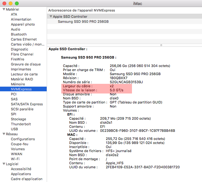

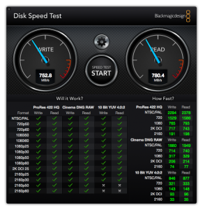

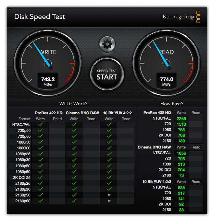

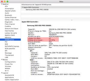

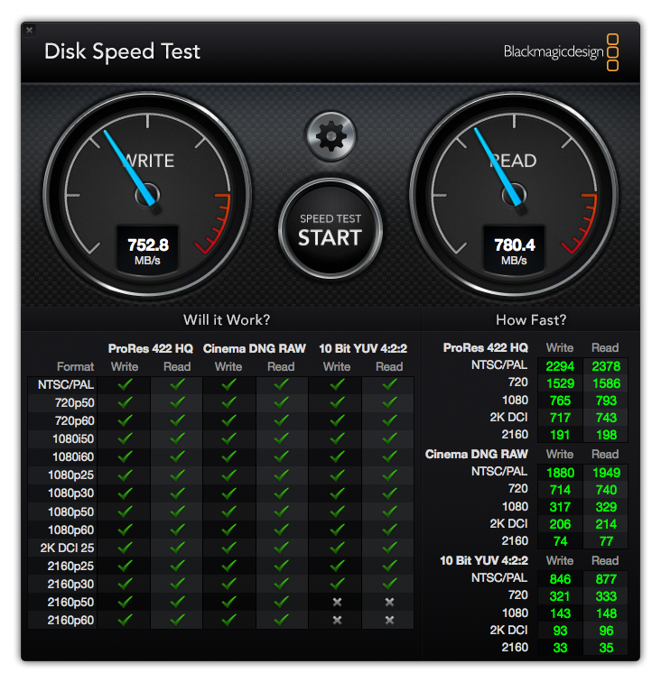

jeanchrijaz Posted January 18, 2017 Share Posted January 18, 2017 i'm back....Finally, I bought another Nvme drive... samsung 950 pro 256Gb(I have not the choice samsung disks are out of stock in france And no one knows when they will be available)now it's work....The drive is recognized as internalalmost everything is ok but I still have a little problemwhen I use the spoof option the kext doesn't work and the computer doesn't want to startIf I don't use the spoof option, the computer starts but I'm getting 750mb/s on read and writemotherboard : asus Z97 pro (wifi ac)El Capitan 10.11.6and i use M2 10 Gb/s slot not PCie card Any suggestions? Link to comment https://www.insanelymac.com/forum/topic/312803-patch-for-using-nvme-under-macos-sierra-is-ready/page/33/#findComment-2352465 Share on other sites More sharing options...

jeanchrijaz Posted January 19, 2017 Share Posted January 19, 2017 Make sure you're using the correct version!!! ./patch_nvme.sh --spoof 10_11_6_sec2016-003 http://www.insanelymac.com/forum/topic/312803-patch-for-using-nvme-under-macos-sierra-is-ready/page-35?do=findComment&comment=2342891 If you are, then try just using Pike patches (the EFI folder I sent to you awhile back) and see if you get a recognized SSD and full speeds. If you don't, then it's your SSD and/or you need to update to 10.12. I used the right version now.... But when I use the spoof command to create the kext the computer does not want to start... I tried without and it works but with reduced speeds I tried with the Pike patches and i have the same problem.... i can't update to sierra.... My external sound card is not functional with sierra and some of my software too (eg. Protools) I'm disappointed I make music with my hachintosh and I need a good sound card Link to comment https://www.insanelymac.com/forum/topic/312803-patch-for-using-nvme-under-macos-sierra-is-ready/page/33/#findComment-2352576 Share on other sites More sharing options...
mfc88 Posted January 19, 2017 Share Posted January 19, 2017 I used the right version now.... But when I use the spoof command to create the kext the computer does not want to start... I tried without and it works but with reduced speeds I tried with the Pike patches and i have the same problem.... i can't update to sierra.... My external sound card is not functional with sierra and some of my software too (eg. Protools) I'm disappointed I make music with my hachintosh and I need a good sound card Try using these patches instead: http://www.insanelymac.com/forum/topic/312803-patch-for-using-nvme-under-macos-sierra-is-ready/?do=findComment&comment=2246600 Then report back. Link to comment https://www.insanelymac.com/forum/topic/312803-patch-for-using-nvme-under-macos-sierra-is-ready/page/33/#findComment-2352588 Share on other sites More sharing options...
RehabMan Posted January 19, 2017 Share Posted January 19, 2017 I used the right version now.... But when I use the spoof command to create the kext the computer does not want to start... I tried without and it works but with reduced speeds --spoof generated kext requires the correct class-code injection (usually done via an SSDT). Link to comment https://www.insanelymac.com/forum/topic/312803-patch-for-using-nvme-under-macos-sierra-is-ready/page/33/#findComment-2352771 Share on other sites More sharing options...
jeanchrijaz Posted January 19, 2017 Share Posted January 19, 2017 Try using these patches instead: http://www.insanelymac.com/forum/topic/312803-patch-for-using-nvme-under-macos-sierra-is-ready/?do=findComment&comment=2246600 Then report back. it works... but same problem.... and link speed detected only in 5Gb/s --spoof generated kext requires the correct class-code injection (usually done via an SSDT). I followed the tutorial I did exactly the same thing Link to comment https://www.insanelymac.com/forum/topic/312803-patch-for-using-nvme-under-macos-sierra-is-ready/page/33/#findComment-2352800 Share on other sites More sharing options...
RehabMan Posted January 19, 2017 Share Posted January 19, 2017 it works... but same problem.... and link speed detected only in 5Gb/s I followed the tutorial I did exactly the same thing Seems likely a hardware/install/setup issue. Test performance on Windows for comparison. Link to comment https://www.insanelymac.com/forum/topic/312803-patch-for-using-nvme-under-macos-sierra-is-ready/page/33/#findComment-2352803 Share on other sites More sharing options...
jeanchrijaz Posted January 19, 2017 Share Posted January 19, 2017 Seems likely a hardware/install/setup issue. Test performance on Windows for comparison. I have already tested ... Under window 7 it works at the right speed Link to comment https://www.insanelymac.com/forum/topic/312803-patch-for-using-nvme-under-macos-sierra-is-ready/page/33/#findComment-2352804 Share on other sites More sharing options...
RehabMan Posted January 19, 2017 Share Posted January 19, 2017 I have already tested ... Under window 7 it works at the right speed Let's see what you're actually doing. Attach ioreg (IORegistryExplorer v2.1) Attach EFI/Clover (as ZIP, without themes, but with ACPI/origin [press F4 to generate EFI/Clover/ACPI/origin prior to collecting]). Attach output of (in Terminal): sudo touch /System/Library/Extensions && sudo kextcache -u / Link to comment https://www.insanelymac.com/forum/topic/312803-patch-for-using-nvme-under-macos-sierra-is-ready/page/33/#findComment-2352812 Share on other sites More sharing options...
jeanchrijaz Posted January 19, 2017 Share Posted January 19, 2017 Let's see what you're actually doing. Attach ioreg (IORegistryExplorer v2.1) Attach EFI/Clover (as ZIP, without themes, but with ACPI/origin [press F4 to generate EFI/Clover/ACPI/origin prior to collecting]). Attach output of (in Terminal): sudo touch /System/Library/Extensions && sudo kextcache -u / Now you have everything .... I hope you find config.zip Link to comment https://www.insanelymac.com/forum/topic/312803-patch-for-using-nvme-under-macos-sierra-is-ready/page/33/#findComment-2352819 Share on other sites More sharing options...
