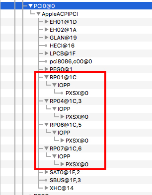

But that also is normal?
I have 3 same location name PXSX@0
Normal.

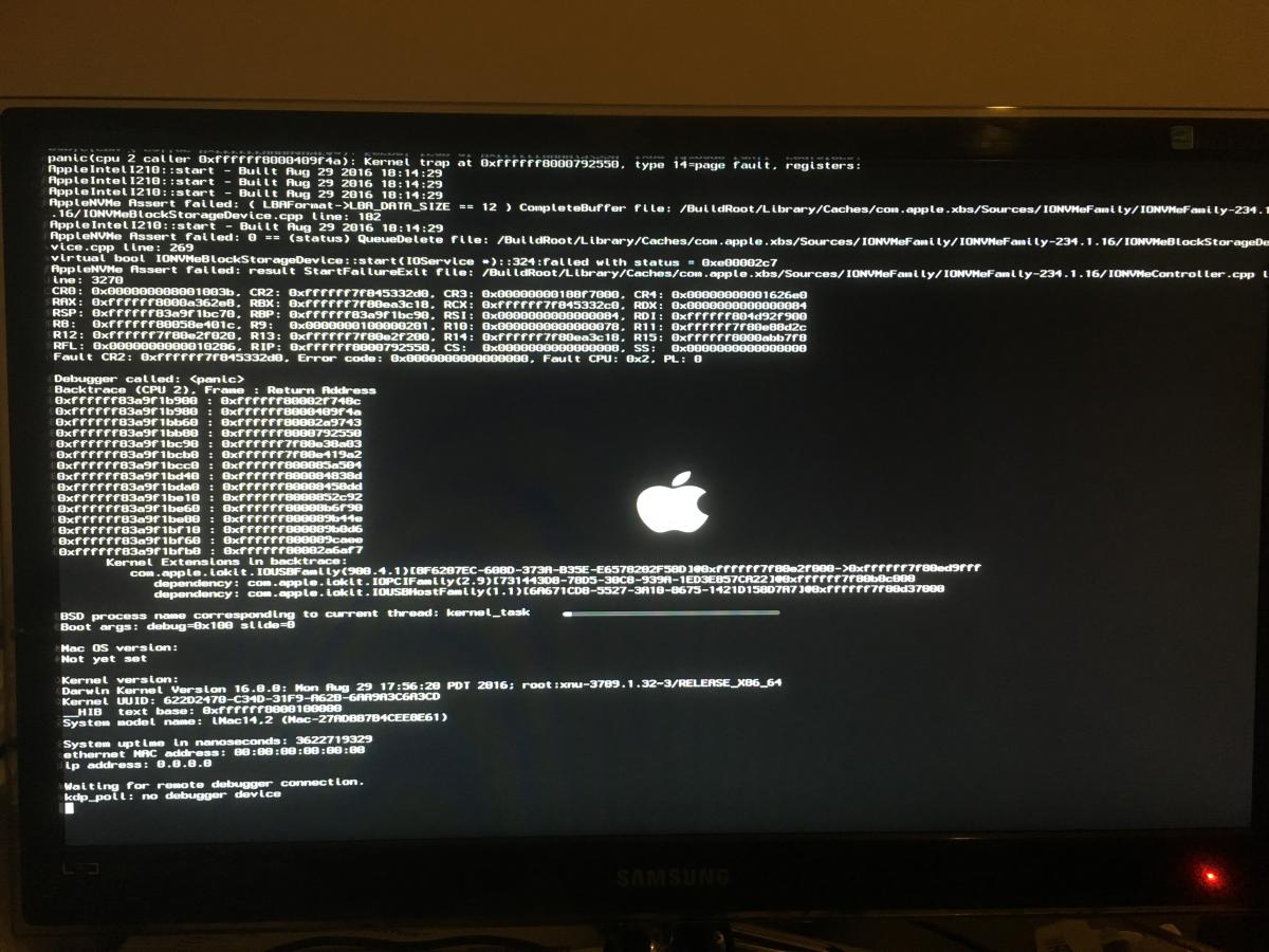

I got this kernel panic
I copied rehabsman patch-nvme to root of usb
boot from usb open terminal run
./patch_nvme.sh 10_12_0
copy HackrNVMeFamilty-10_12_0.kext to EFI/CLOVER/kexts/Other and then reboot to boot again from usb
And then got this kernel panic

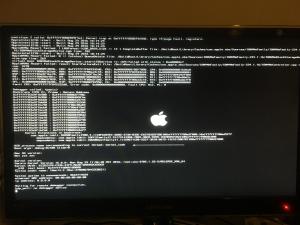

I copied rehabsman patch-nvme to root of usb[/size]
It is because you still have IONVMeFamily.kext present.
As per patch-nvme README, you must delete IONVMeFamily.kext if you're not using the class-code spoof.
Suggest you read carefully.
