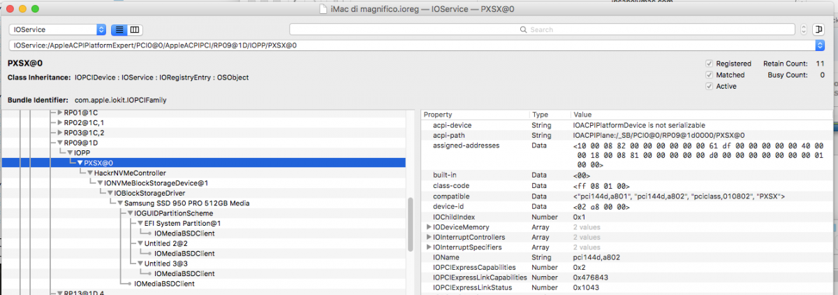

Hi RehabMan,
I am sorry for intervention but the method from post 569 is not working. Tested by magnifico.
See the picture
This device obtained fake class code =
but IOPCIFamily took original class code fro PCI space
compatible = <...>
So that original IONvmeFamily.kext is attached to this device and cause panic as confirmed by users.
Hi RehabMan,
It works just fine (I'm using it on the computer on which I'm typing this message!)
User magnifico is making a mistake.
He has two NVMe disks (second at RP13.PXSX). He is injecting class-code only on one of them (RP09.PXSX).
So... of course native IONVMeFamily still matches on the one still with standard class-code, which causes the problem...

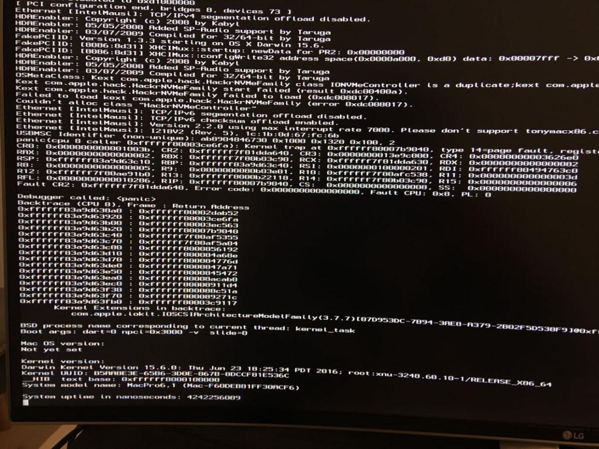

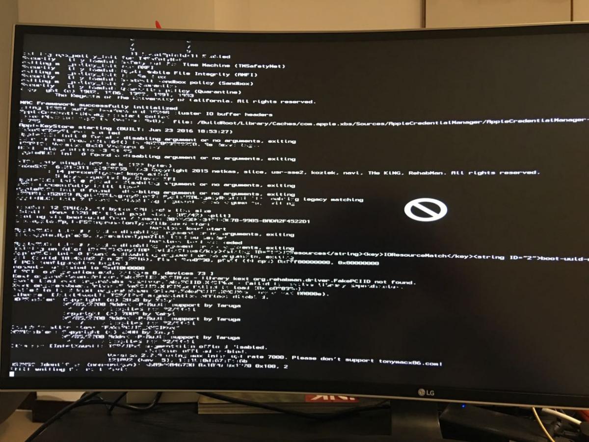

Hi RehabMan,I finished install OS X 10.11.6  on PM961 by using patches in config.plist KextsToPatch. It is easy. But I have a problem when I boot OS X from PM961.It is a photo by verbose mode.post-1557617-0-20287400-1481036587_thumb.jpg
And I have another problem when I used HackrNVMeFamily-10_11_6.kext in CLOVER/KEXTS . The kext froms the other OSX 10.11.6.post-1557617-0-22311000-1481036758_thumb.jpg
Hi RehabMan,I finished install OS X 10.11.6  on PM961 by using patches in config.plist KextsToPatch. It is easy.[/size] But I have a problem when I boot OS X from PM961.It is a photo by verbose mode.[/size]attachicon.gifpatch .jpg
And I have another problem when I used HackrNVMeFamily-10_11_6.kext in CLOVER/KEXTS . The kext froms the other OSX 10.11.6.[/size]attachicon.gifkext.jpg
HackrNVMeFamily.kext should be installed to the system volume.
Make sure you don't use config.plist patches for IONVMeFamily at the same time as HackrNVMeFamily*.kext.
