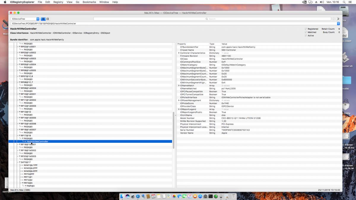

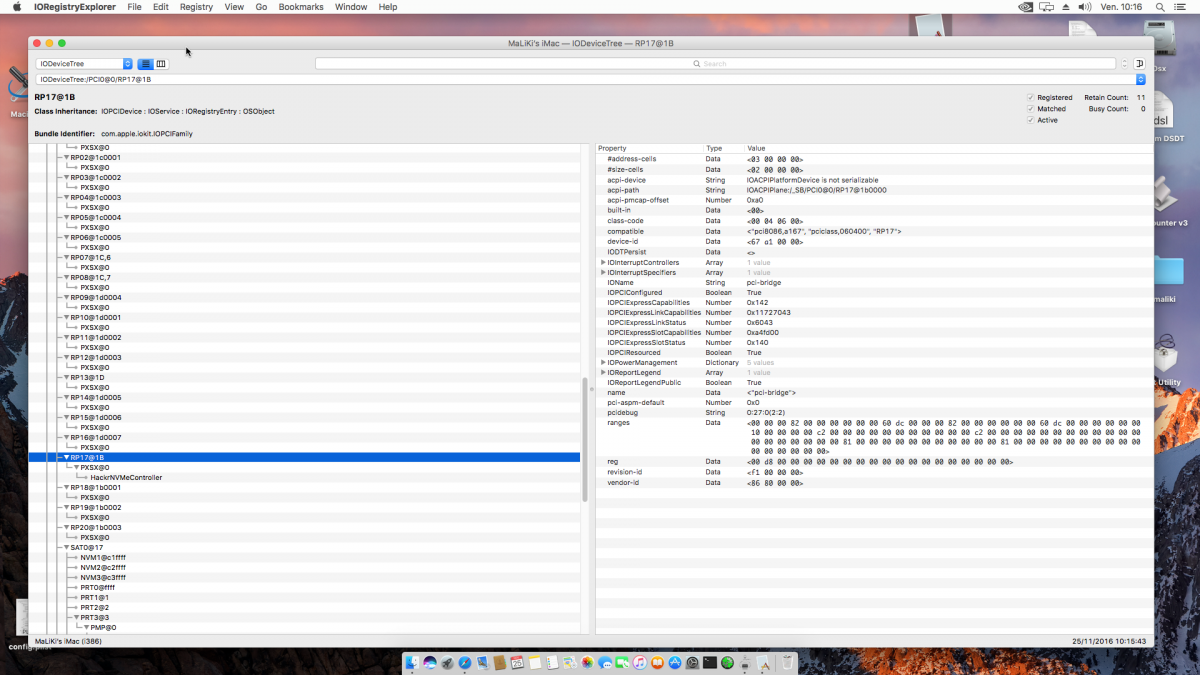

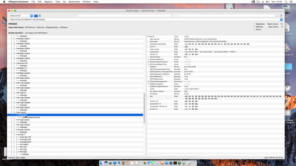

ok..here it is..
I managed to boot into a virgin 10.12.1 installation pre-nvme kext install. so I have all 3 installed M2_1(960PRO-512GB), M2_2(950PRO-256GB) and M2_3 (960PRO-1TB). In Sytem Info, it even shows 3X Apple SSD controller started but nothing else. IOREG too..
Clover install is from the original boot disk with hackrnvme installed...
if it is possible to use vanilla, can you walk me through it to get the 960's going? would seem easier to use vanilla kext over long term..the 950 I can sell..
thanks!

It is going to involve looking at the debug traces from IONVMeFamily to determine what kind of patches will be required.
From what you show, it seems the 960 not working with unmodified IONVMeFamily.
And what you said earlier, not working with Pike's patches either.
