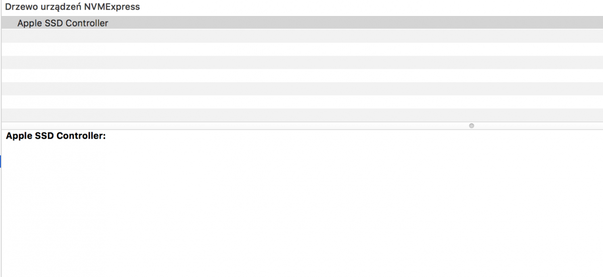

sasta Posted November 1, 2016 Share Posted November 1, 2016 I have the same card (Plextor m8pe) SystemInfo showing something but in disutility is no present. I have the same card (Plextor m8pe) SystemInfo showing something but in disutility is no present. Exactly my case. Where is the right picture from? As it turns out, you are right. Intel stopped support for their motherboards long ago and there isn't a way for me to boot from the nvme. In addition, neither MS or Intel has released a way for nvme drives to be detected in Windows 7, so looks like I'm screwed. I should have done more research. Just boot clover from another drive and point to boot the partition of the nvme. Setup everything on the other hd. This is what I have been doing with my system till now. I was booting from a hd and point my raid setup to boot. Link to comment https://www.insanelymac.com/forum/topic/312803-patch-for-using-nvme-under-macos-sierra-is-ready/page/19/#findComment-2311944 Share on other sites More sharing options...

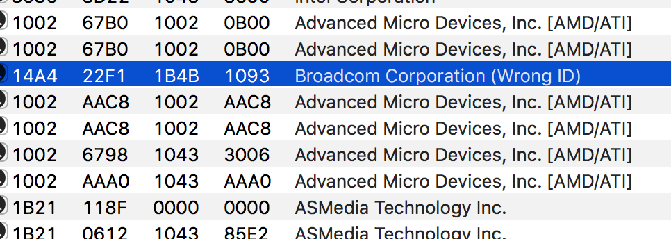

Matthew82 Posted November 1, 2016 Share Posted November 1, 2016 Exactly my case. Where is the right picture from? Just boot clover from another drive and point to boot the partition of the nvme. Setup everything on the other hd. This is what I have been doing with my system till now. I was booting from a hd and point my raid setup to boot. DPCIManager Link to comment https://www.insanelymac.com/forum/topic/312803-patch-for-using-nvme-under-macos-sierra-is-ready/page/19/#findComment-2311957 Share on other sites More sharing options...
sasta Posted November 1, 2016 Share Posted November 1, 2016 DPCIManager I have the same output but without the wrong Id remarkI have the same output but without the wrong Id remark If can't work with the kextstopatch, than I doubt that the patched kext can do better. So no, nothing that I can advice Off course, supposing that you removed all patched kexts and the vanilla kext is there. Is there an explanation of what every patch does, so I can check them all with my hardware? Link to comment https://www.insanelymac.com/forum/topic/312803-patch-for-using-nvme-under-macos-sierra-is-ready/page/19/#findComment-2311963 Share on other sites More sharing options...

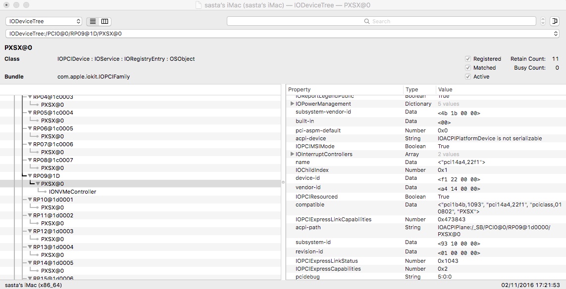

sasta Posted November 2, 2016 Share Posted November 2, 2016 Check this ioregistry extract. What do you see ? What is PXSX ? Why it doesn't work ? Something is missing. Link to comment https://www.insanelymac.com/forum/topic/312803-patch-for-using-nvme-under-macos-sierra-is-ready/page/19/#findComment-2312568 Share on other sites More sharing options...
