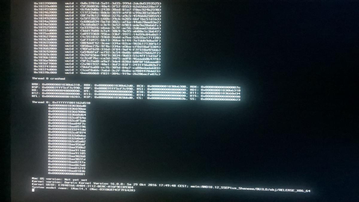

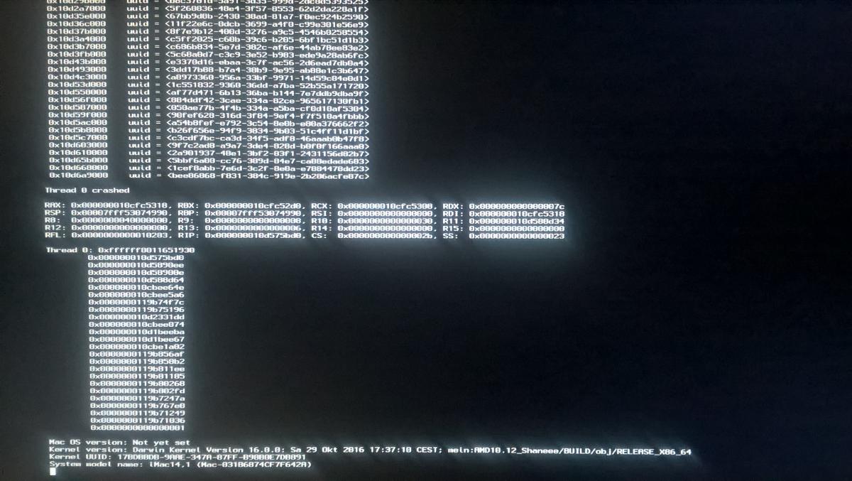

For FX-6300 hackintosh at 10.12.1 & booted by Enoch r2839:
(1) kernel_fx: waiting for root device
(2) kernel_fx with SSEPlus: KP after VM Swap Subsystem is On (if booted by Clover, it got automatic shutdown)
For Phenom X4 9850 & booted by Enoch r2839:
(1) kernel_older cpu: KP after VM SWAP system
(2) kernel_older cpu with SSEPlus: KP after VM Swap Subsystem is On due to invalid opemu or opcode ?
(3) if booted by Clover always got the same errors as at 10.11.x reported by Shaneee
Edited by jsl

I don't know why this kernel got the similar invalid kernel opcode (64-bit) as the others for Phenom X4 9850 hackintosh at 10.12.1 & 10.12GM.
For FX-6300 at 10.12.1 and 10.12GM both got automatic shutdown after VM Swap Subsystem is On.
Solved by replaced FakeSMC.kext to v.6.21.1412 and only working at 10.12GM(16A322) not at 10.12.1 yet !

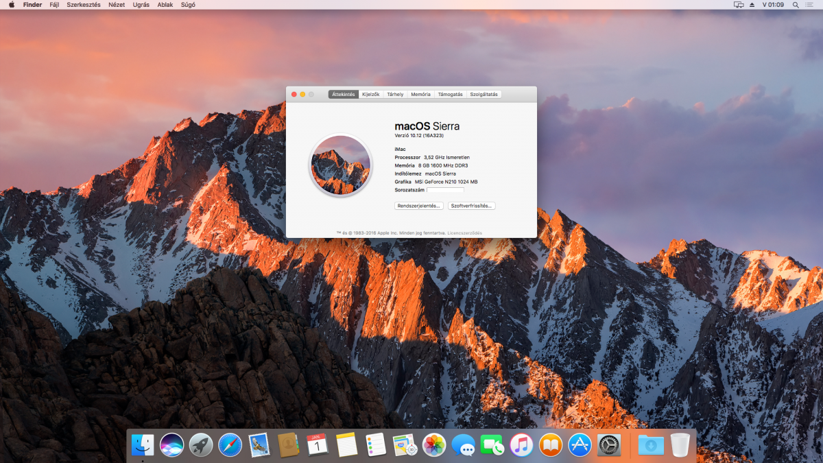

kernel booted to Desktop with no issues :) and NO green icon bug too :) tested it both with Clover and enoch.Some things are not working like Siri (It can't switch to mic mode.I used ALC662v2 kext from Capitan I have sound and mic is tested ok but maybe I need an update) I can't switch keyboard type or function keys shortcuts (voodooPS2 1.8.24) but Kernel is beta as you said :) Used USB fix V3 and in fact I have info now about my USB3 ports (ApppleUSBXHCIPCI) on system information :) Safari with flash player works App Store works Sleep works :) Excellent Kernel for BETA.
iMAC 14.2
DSDT from Capitan (No changes)
USB Fix V3
Latest FakeSMC (1412)
VoodooPstate 1.0.3
Thank you Bronya GREAT Job as always.
