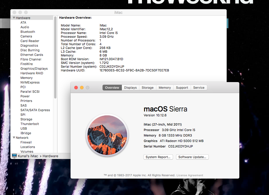

Hello Guys,

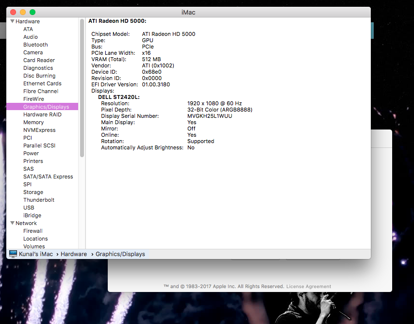

I have managed to install Sierra on to my Optiplex 790 Ultra Small factor.
I have even managed to get proper power management working (I think),
Now for DSDT edits, which fixes are needed ?
Core i5 2400
8GB RAM
ATI HD5450 Dell (Low profile card from dell)
Graphics works perfect but detected as "HD5000"
Thanks in advance,

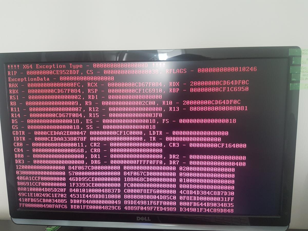

Hello ricoc90,
Appreciate your valuable input! So I used the DSDT.aml and config.plist from Optiplex 790 in #1.
When I did that, my system refused to boot and some weird text in red showed up! (Please see attached image for exact message)
I have my Install USB that I used to get to my system again and make it bootable again using the con gif.plist I attached initially. \
By using DSDT.aml in post #1 and my own config.plist(edited to match the one in post #1), my system boots but I do not have sound!
I did not have nightshift but changing SMBIOS to iMac 13,x seems to have got it functioning again!

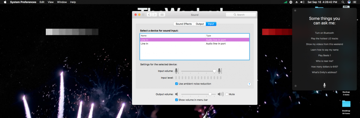

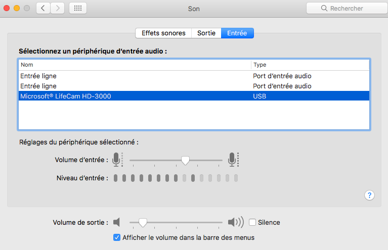

Ive got nightshift working now! I decided to stuck with iMac13,1 and also I finally figured out the applealc + ill method. The only problem is the mic is still not working!
It seems like the input is there but it is extremely low! Also moving the slider for mic input to maximum in system preferences doesn't help...any ideas ?

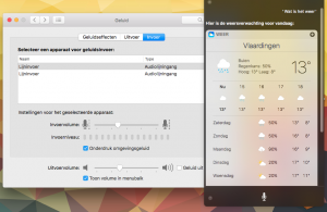

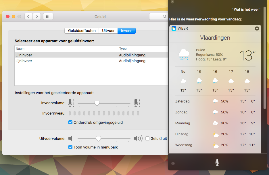

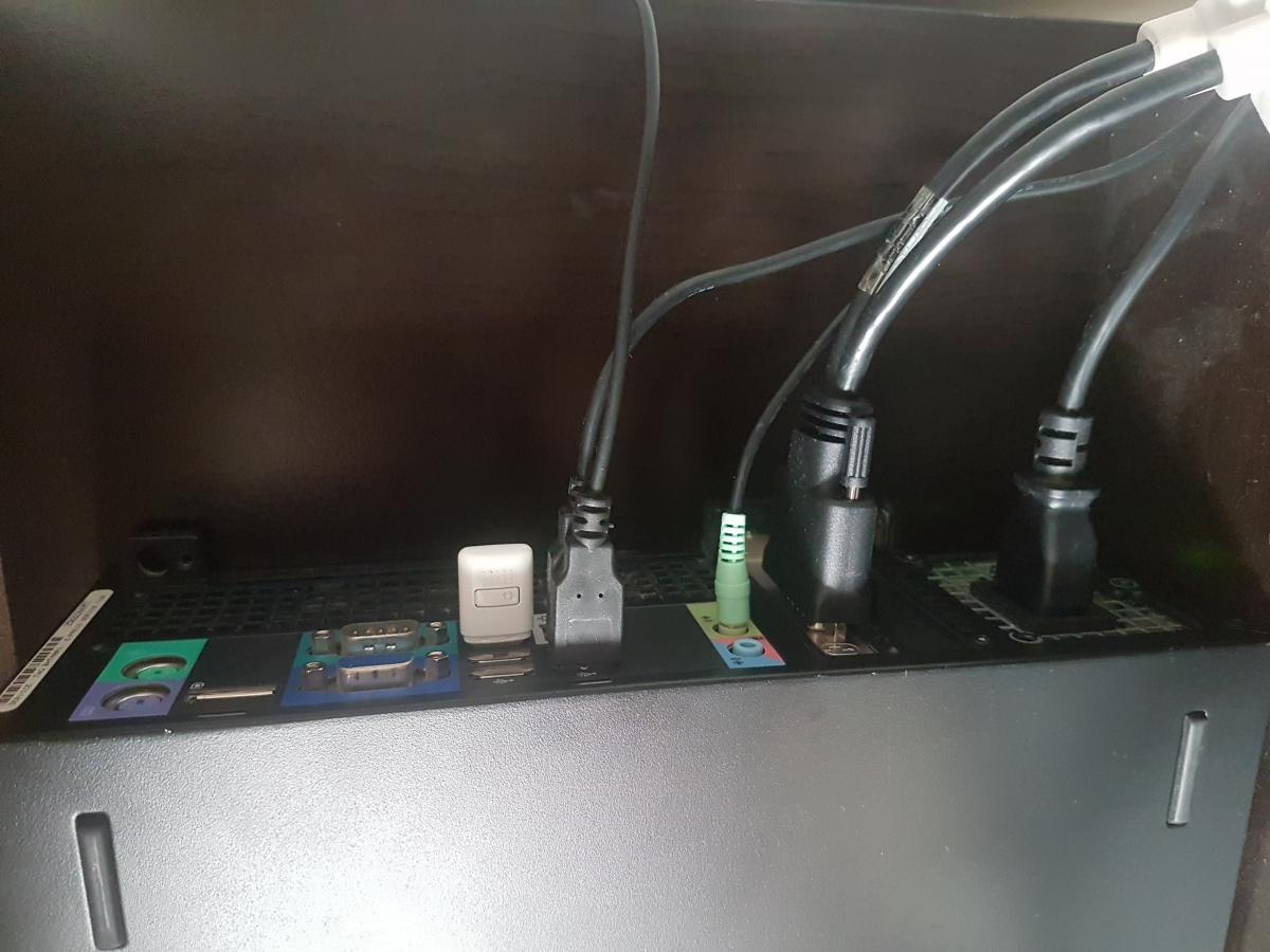

With the mic port on the back I'm having the same issue. The mic port on the front works fine:

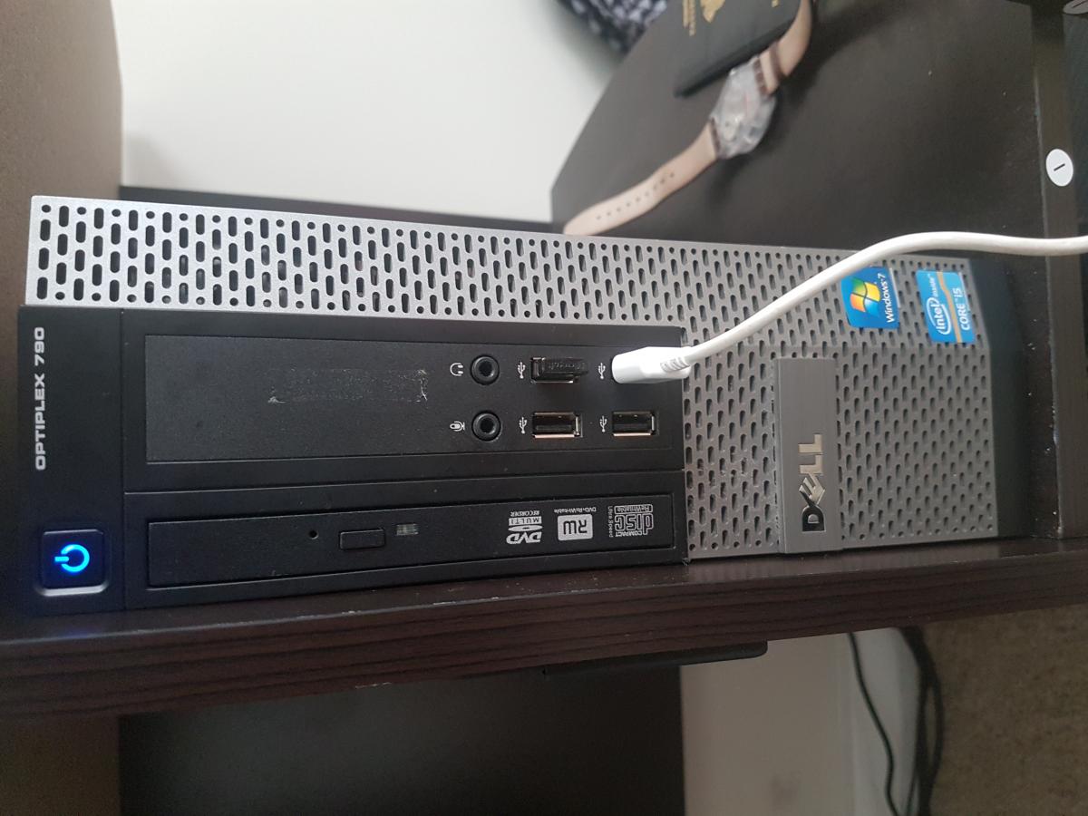

Are you sure you're using the USFF version? I believe the USFF version does not have PCI-e expension slots?
Hello!
So for me neither of the mic ports seem to work! Why I do not know!
Even when I go to sound preferences, it seems to show feedback but my voice doesn't seem to get picked up.
I tried to use Siri and its as if it doesn't hear me.
I think I do have the USFF and it does have a PCI-E expansion slot (only that the cards built for it are supersmall!)
- Quinzie
That is the SFF, not the USFF  :P
The USFF only has 2 USB ports up front and no expansion slots  :wink_anim:
Does your mic work in Windows? Could you upload your EFI folder please?
Strange. I only have AppleALC from #1 plus latest Lilu in Clover/Kexts/Others and layout-ID in HDEF:

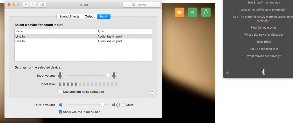

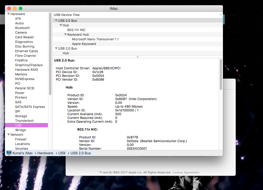

Hello!
I replaced AppleALC.kext with the one you gave me and the result is still the same!
I have attached a screenshot for your reference :)

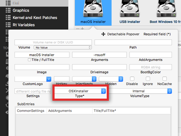

I have the same issue lately. As a workaround I added a custom boot entry for macOS installation:
