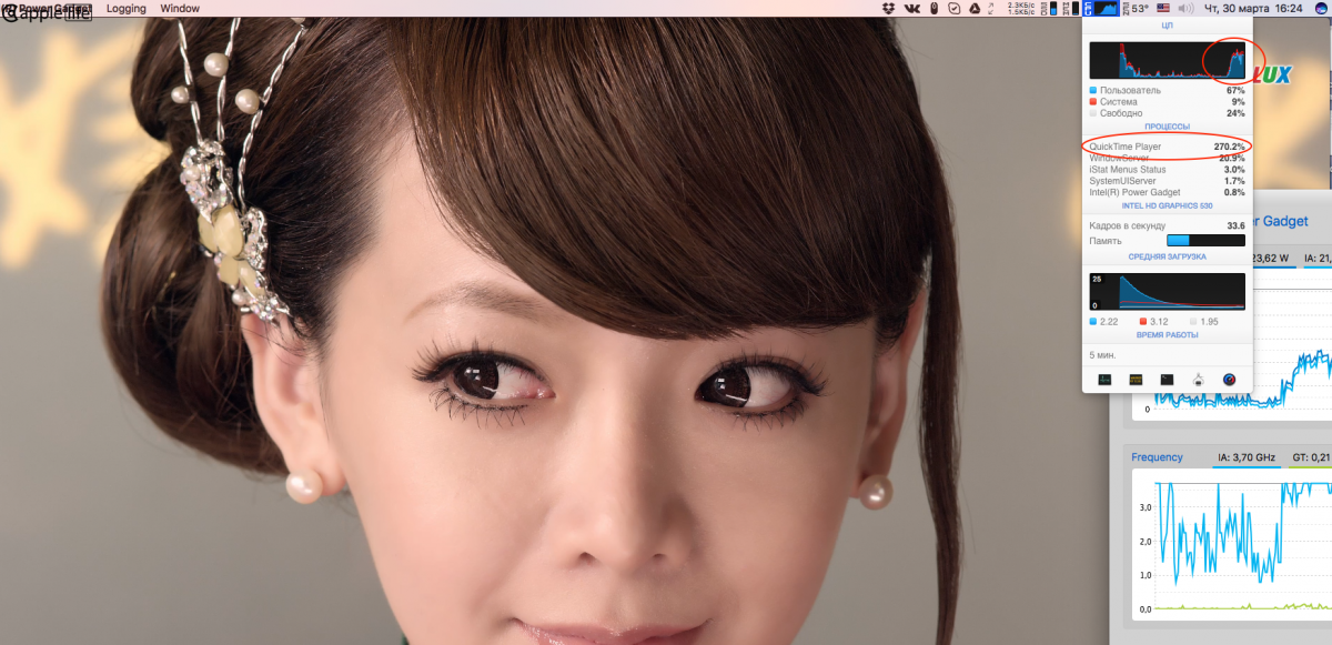

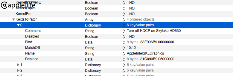

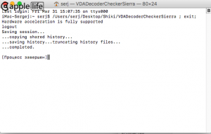

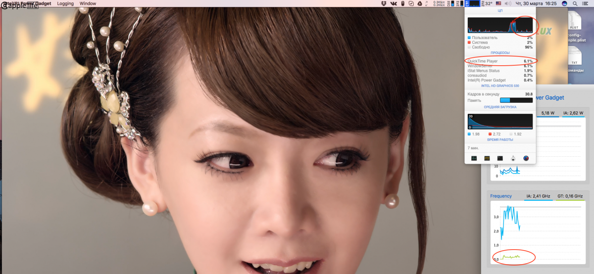

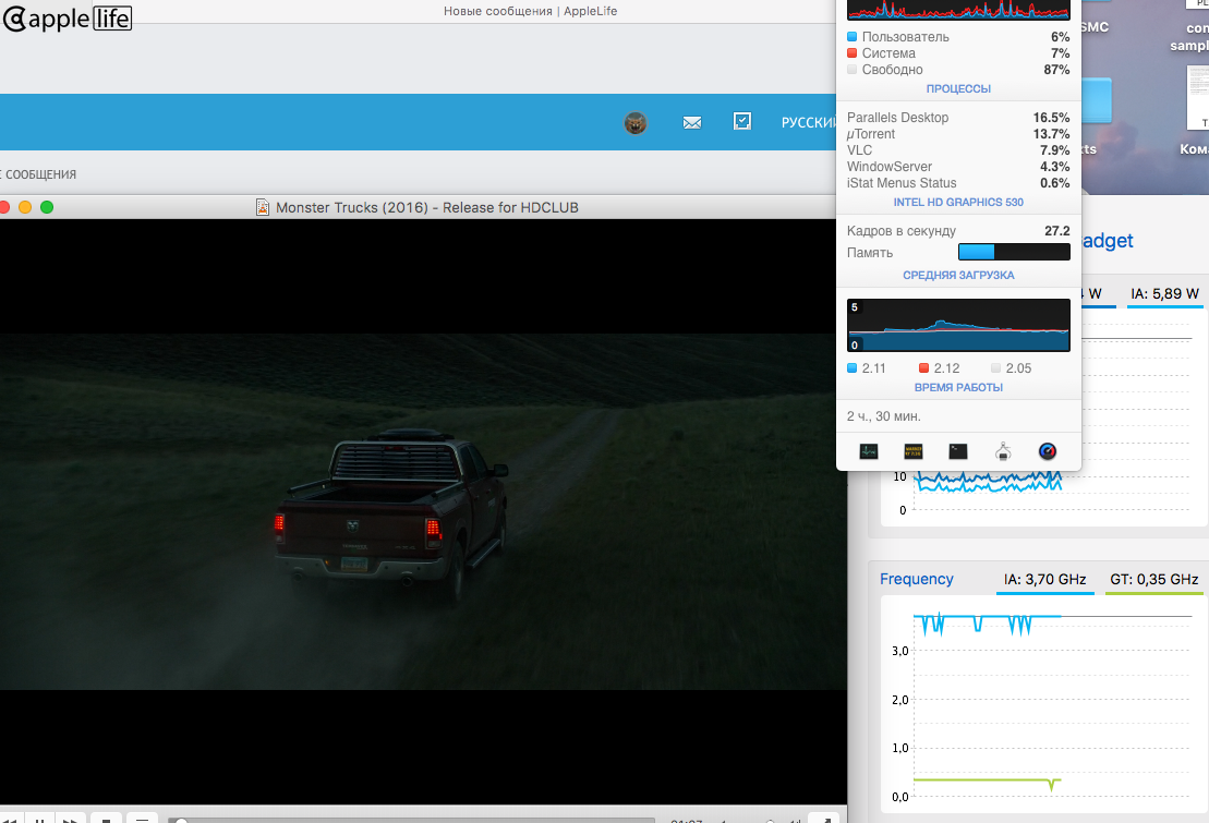

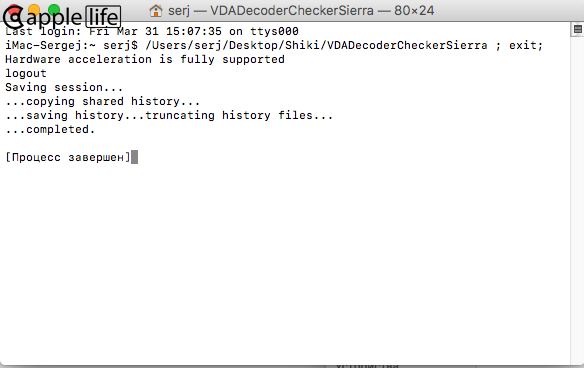

vandroiy2012 Posted March 31, 2017 Share Posted March 31, 2017 To the owners of Intel HD530, who uses it as the only and basic card. With the release of macOS 10.12.4 we were overtaken by the fate of the HD4400/4600 owners. They had a complete system crash when entering with Safari on rbc.ru or when trying to play a trailer in iTunes or imdb.com. With help of @vit9696 and @lvs1974 this problem was solved in Lilu plugin called IntelGraphicsFixup.kext. Until the release of 10.12.4 on HD530 nothing similar was observed and on March 27th this bug caught up with us . Now when you go through Safari to the above sites and iTunes trailers shows random fading of the interface the video is jerking. The situation is very similar to the one that was with the HD4400/4600 but not so critical. A complete crash of the system does not happen but spoils the life of perfectionists fairly The patch for dealing with this problem was easier than in the case of the HD4400/4600. And it was not necessary to allocate it in a separate plugin for Lilu ... It is enough in config.plist in the KextsToPatch section to write the following: It turned out not so simple. With this patch after waking from sleep WebKit were completely freezing. Now you should use latest IntelGraphicsFixup.kext to deal with PAVP/HDCP issue on Skylake HD Graphics https://sourceforge.net/projects/intelgraphicsfixup/files/ This version of IntelGraphicsFixup.kext also pinned in the bottom of this post. Credits for this changes to YungRanj Before using new IntelGraphicsFixup.kext DELETE this old patch from your config.plist!!! The next problem concerns the missing video hardware acceleration on the HD530 if a macmodel is used in which a discrete card is provided. When playing HD content, CPU cores were loaded, and the IGPU was not involved in decoding. The result of playing 4K video WITHOUT hardware acceleration can be seen on the following screenshot: As you can see, the situation is bleak. Part of this problem could be solved by fixing the forceOfflineRenderer-> false parameter in System / Library / PrivateFrameworks / AppleGVA.framework / Resources / info.plist for your board-id, but changing the plist is fraught with signature verification failure when initializing DRM. In some cases, this will break the playback of purchased movies. Intel online = intel with connectors Intel offline = Intel without connectors Therefore, it was decided to make edits through Shiki.kext. And ONLY for those who use the built-in graphics. For such cases a boot argument is needed: -shikigva If the key is present, the OfflineRenderer is forcibly turned off and hardware acceleration starts working. In this case the digital signature of AppleGVA.framework is not violated.Screenshot of 4K video with hardware acceleration (-shikigva) on HD530 Test video - http://4ksamples.com/4k-chimei-inn-60mbps/ The output of VDADecoderChecker. The checker itself build for the Sierra - VDADecoderCheckerSierra.zip Hardware acceleration also works fine in VLC (if you select it forcibly in the settings) In order to make it all work you need to put the most recent versions of Lilu.kext 1.1.0 and Shiki.kext 2.0.1. In connection with the significant differences in the Lilu 1.1.0 code the previous release plugins (AppleALC.kext, Shiki.kext, IntelGraphicsFixup.kext, NvidiaGraphicsFixup.kext, HibernationFixup.kext) will not work with this version of Lilu!!! Lilu.kext version 1.1.0 and compatible with it plugins Shiki.kext 2.0.1 and AppleALC.kext 1.1.1 build from the most recent source code i will attach here. Lilu_1.1.0.zip Shiki_2.0.1.zip AppleALC_1.1.1.zip Concerning the compatibility of IntelGraphicsFixup.kext, NvidiaGraphicsFixup.kext and HibernationFixup.kext with the new version of Lilu, you should contact @lvs1974 on http://applelife.ru. Here is updated compatible with Lilu 1.1.0 plugins by @lvs1974 IntelGraphicsFixup_1.1.1.kext.zip NvidiaGraphicsFixup.kext.zip HibernationFixup.kext.zip It should be noted that all the above kexts are preliminary versions at testing and finalization stage. Without the urgent need don't use them. All thanks to @vit9696 for time spent and code writing!!! 7 Link to comment https://www.insanelymac.com/forum/topic/312278-shiki-%E2%80%94-protected-video-playback-support-on-recent-hardware/page/5/#findComment-2395958 Share on other sites More sharing options...
