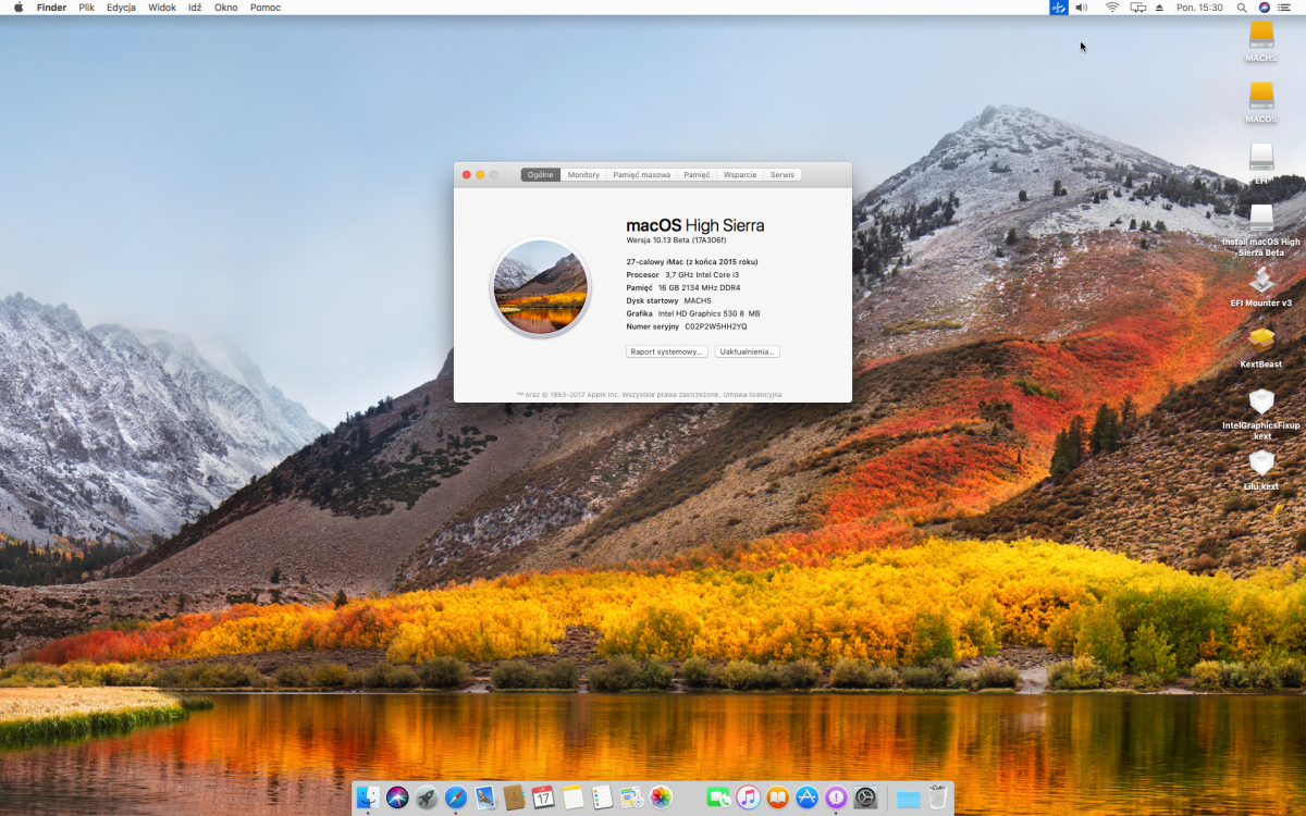

fixpol Posted July 17, 2017 Share Posted July 17, 2017 Just installed High Sierra Beta 2 on external drive, and sound , wifi, works fine but cannot pass HD530 graphics as 10.12.5 fix no longer works. Link to comment https://www.insanelymac.com/forum/topic/312085-guide-macos-sierra-1012x-on-asrock-h170m-itxac/page/14/#findComment-2464901 Share on other sites More sharing options...

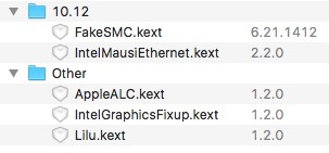

DutchAcerOne Posted October 30, 2017 Share Posted October 30, 2017 [...] What's changed is that now you can place Lilu.kext, AppleALC.kext and IntelGraphicsFixup.kext (latest versions) on CLOVER folder. It would be good to get also another member's advice since now I don't run HD530 as my primary GPU. I'm runnng 10.12.6, installed with updates from 10.12.0. I only use the integrated HD530 video. Denicio is right about the Lilu.kext, AppleALC.kext and IntelGraphicsFixup.kext. I placed the latest versions (v1.2.0) in the "Other" subfolder. The only other kexts I have are in "10.12" subfolder. See picture. Succes! 1 Link to comment https://www.insanelymac.com/forum/topic/312085-guide-macos-sierra-1012x-on-asrock-h170m-itxac/page/14/#findComment-2525281 Share on other sites More sharing options...

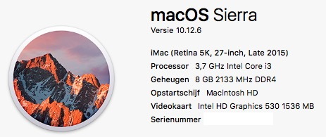

MVaspat Posted October 30, 2017 Share Posted October 30, 2017 I'm runnng 10.12.6, installed with updates from 10.12.0. I only use the integrated HD530 video. DenicIo is right about the Lilu.kext, AppleALC.kext and IntelGraphicsFixup.kext. I places the latest versions (v1.2.0) in the "Other" subfolder. The only other kexts I have are in "10.12" subfolder. See picture. Succes! Thanks to both of you for your replies! 1 Link to comment https://www.insanelymac.com/forum/topic/312085-guide-macos-sierra-1012x-on-asrock-h170m-itxac/page/14/#findComment-2525309 Share on other sites More sharing options...
MVaspat Posted November 13, 2017 Share Posted November 13, 2017 Hi there! The attached files are not updated, you are right. What I can tell you though as far as my installation goes is that "SSDT-2.aml" is still used as-is. What's changed is that now you can place Lilu.kext, AppleALC.kext and IntelGraphicsFixup.kext (latest versions) on CLOVER folder. It would be good to get also another member's advice since now I don't run HD530 as my primary GPU, as you said. Best of luck and skills! Hi Denicio is there any updated version of BCM94352Injector.kext? tried to get the latest from creator's github page, but couldn't find any .kext file there, don't know whether the same I used for a 10.12.3 installation(the one included in your guide's last version) is gonna work for a 10.12.6, thanks in advance! Link to comment https://www.insanelymac.com/forum/topic/312085-guide-macos-sierra-1012x-on-asrock-h170m-itxac/page/14/#findComment-2533802 Share on other sites More sharing options...

MVaspat Posted November 13, 2017 Share Posted November 13, 2017 I had made that kext at some point, but I think the best solution is to download this: https://bitbucket.org/RehabMan/os-x-fake-pci-id/downloads/ Use "FakePCIID.kext" and "FakePCIID_Broadcom_WiFi.kext" from the package. Thanks for your answer, taking advantage of your prompt one, should I copy those files, FakePCIID.kext" and "FakePCIID_Broadcom_WiFi.kext" to EFI/clover/kexts/other/ or to /System/Library/Extensions ? I understand that using the above 2 files I shouldn't make use of BCM94352Injector.kext anymore, let me know whether I'm wrong! thanks again! 1 Link to comment https://www.insanelymac.com/forum/topic/312085-guide-macos-sierra-1012x-on-asrock-h170m-itxac/page/14/#findComment-2533931 Share on other sites More sharing options...
Denicio Posted November 13, 2017 Author Share Posted November 13, 2017 Thanks for your answer, taking advantage of your prompt one, should I copy those files, FakePCIID.kext" and "FakePCIID_Broadcom_WiFi.kext" to EFI/clover/kexts/other/ or to /System/Library/Extensions ? I understand that using the above 2 files I shouldn't make use of BCM94352Injector.kext anymore, let me know whether I'm wrong! thanks again! Correct! Ditch the old kext, and place those two on the "Other" folder, along with your other kext files. Link to comment https://www.insanelymac.com/forum/topic/312085-guide-macos-sierra-1012x-on-asrock-h170m-itxac/page/14/#findComment-2533966 Share on other sites More sharing options...
MVaspat Posted November 19, 2017 Share Posted November 19, 2017 Correct! Ditch the old kext, and place those two on the "Other" folder, along with your other kext files. Thanks again sorry for the belated reply this time! Link to comment https://www.insanelymac.com/forum/topic/312085-guide-macos-sierra-1012x-on-asrock-h170m-itxac/page/14/#findComment-2537110 Share on other sites More sharing options...
