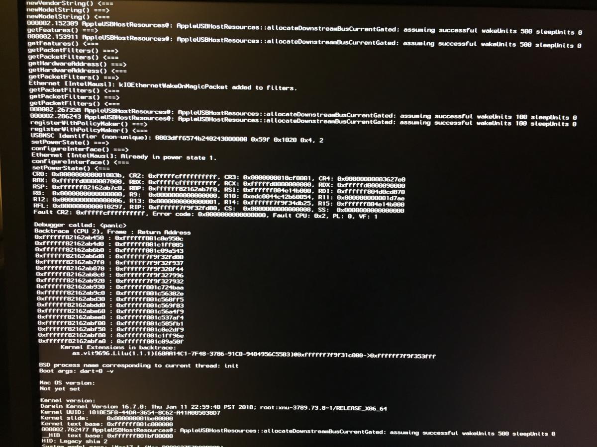

Peerke Posted February 20, 2018 Share Posted February 20, 2018 I'm not having any issues, running the latest updates. Are you up to date with Clover and the latest AppleALC.kext, IntelGraphicsFixup.kext and Lilu.kext? I just ran into this KP with Lilu 1.1.1. I had 10.12.6 running smoothly with your instructions, but patch 2018-001 killed my system. What version(s) were you running? Link to comment https://www.insanelymac.com/forum/topic/312085-guide-macos-sierra-1012x-on-asrock-h170m-itxac/page/16/#findComment-2595604 Share on other sites More sharing options...
DutchAcerOne Posted February 21, 2018 Share Posted February 21, 2018 I just ran into this KP with Lilu 1.1.1. I had 10.12.6 running smoothly with your instructions, but patch 2018-001 killed my system. What version(s) were you running? Here is a list of the kexts and there version numbers in my EFI/CLOVER/kexts/Other folder: EFI/CLOVER/kexts/Other/AppleALC.kext 1.2.2 EFI/CLOVER/kexts/Other/FakeSMC_ACPISensors.kext 6.26-322-g1b20eab7.1765 EFI/CLOVER/kexts/Other/FakeSMC_CPUSensors.kext 6.26-322-g1b20eab7.1765 EFI/CLOVER/kexts/Other/FakeSMC_GPUSensors.kext 6.26-322-g1b20eab7.1765 EFI/CLOVER/kexts/Other/FakeSMC_LPCSensors.kext 6.26-322-g1b20eab7.1765 EFI/CLOVER/kexts/Other/FakeSMC.kext 6.26-322-g1b20eab7.1765 EFI/CLOVER/kexts/Other/IntelGraphicsFixup.kext 1.2.3 EFI/CLOVER/kexts/Other/IntelMausiEthernet.kext 2.2.0 EFI/CLOVER/kexts/Other/Lilu.kext 1.2.2 EFI/CLOVER/kexts/Other/Shiki.kext 2.2.0 I used Clover v2.4k r4369 EFI bootloader. I think you can skip the sensors.kexts, I had them there just for testing. Succes! Link to comment https://www.insanelymac.com/forum/topic/312085-guide-macos-sierra-1012x-on-asrock-h170m-itxac/page/16/#findComment-2595815 Share on other sites More sharing options...
Peerke Posted February 21, 2018 Share Posted February 21, 2018 Here is a list of the kexts and there version numbers in my EFI/CLOVER/kexts/Other folder: EFI/CLOVER/kexts/Other/AppleALC.kext 1.2.2 EFI/CLOVER/kexts/Other/FakeSMC_ACPISensors.kext 6.26-322-g1b20eab7.1765 EFI/CLOVER/kexts/Other/FakeSMC_CPUSensors.kext 6.26-322-g1b20eab7.1765 EFI/CLOVER/kexts/Other/FakeSMC_GPUSensors.kext 6.26-322-g1b20eab7.1765 EFI/CLOVER/kexts/Other/FakeSMC_LPCSensors.kext 6.26-322-g1b20eab7.1765 EFI/CLOVER/kexts/Other/FakeSMC.kext 6.26-322-g1b20eab7.1765 EFI/CLOVER/kexts/Other/IntelGraphicsFixup.kext 1.2.3 EFI/CLOVER/kexts/Other/IntelMausiEthernet.kext 2.2.0 EFI/CLOVER/kexts/Other/Lilu.kext 1.2.2 EFI/CLOVER/kexts/Other/Shiki.kext 2.2.0 I used Clover v2.4k r4369 EFI bootloader. I think you can skip the sensors.kexts, I had them there just for testing. Succes! Thanks, I will update Lilu, AppleALC and IntelGraphics. What does Shiki do? Link to comment https://www.insanelymac.com/forum/topic/312085-guide-macos-sierra-1012x-on-asrock-h170m-itxac/page/16/#findComment-2595820 Share on other sites More sharing options...
DutchAcerOne Posted February 21, 2018 Share Posted February 21, 2018 Thanks, I will update Lilu, AppleALC and IntelGraphics. What does Shiki do? See posts #372...#375 Link to comment https://www.insanelymac.com/forum/topic/312085-guide-macos-sierra-1012x-on-asrock-h170m-itxac/page/16/#findComment-2595932 Share on other sites More sharing options...
Peerke Posted February 21, 2018 Share Posted February 21, 2018 See posts #372...#375 Thanks a lot, everything running smoothly again! 1 Link to comment https://www.insanelymac.com/forum/topic/312085-guide-macos-sierra-1012x-on-asrock-h170m-itxac/page/16/#findComment-2596211 Share on other sites More sharing options...

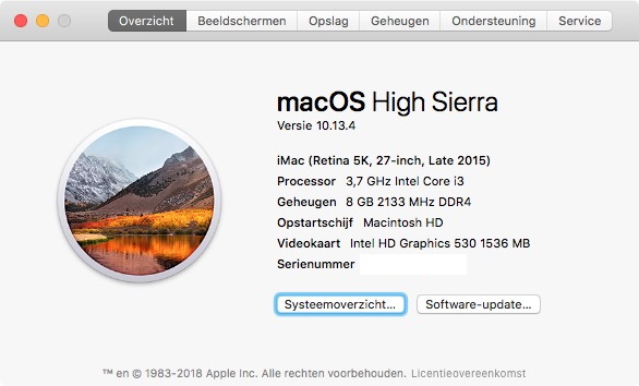

DutchAcerOne Posted April 3, 2018 Share Posted April 3, 2018 (edited) Installed version 10.13.4 without problems (no apfs). First updated all the kexts (AppleALC.kext, IntelGraphicsFixup.kext, Lilu.kext, Shiki.kext) to the latest version and then installed the latest Clover r4411. Edited April 3, 2018 by DutchAcerOne Link to comment https://www.insanelymac.com/forum/topic/312085-guide-macos-sierra-1012x-on-asrock-h170m-itxac/page/16/#findComment-2607380 Share on other sites More sharing options...

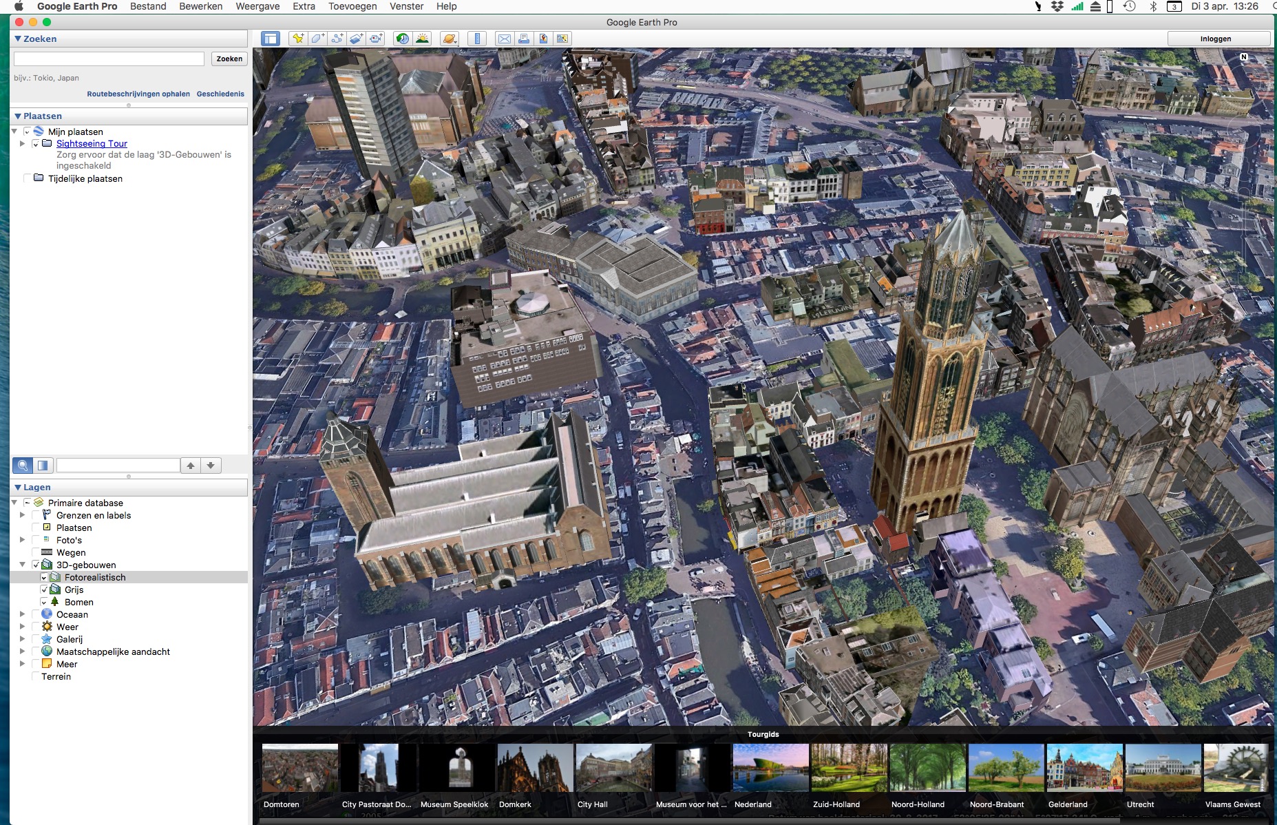

DutchAcerOne Posted April 3, 2018 Share Posted April 3, 2018 (edited) On 11-3-2018 at 4:57 PM, fixpol said: Google Earth in Chrome is crashing when browsing in 3D This view? Seems to work on my system, Google Earth Pro v7.3. Edited April 3, 2018 by DutchAcerOne Link to comment https://www.insanelymac.com/forum/topic/312085-guide-macos-sierra-1012x-on-asrock-h170m-itxac/page/16/#findComment-2607392 Share on other sites More sharing options...
