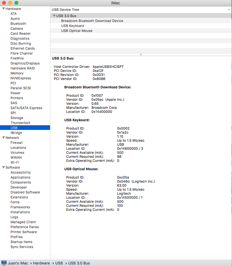

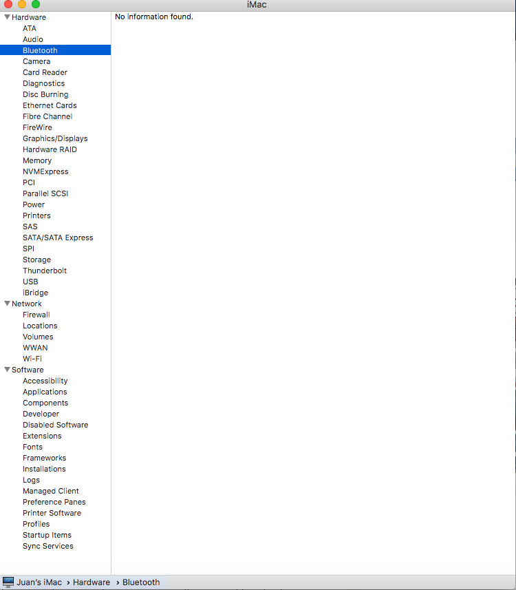

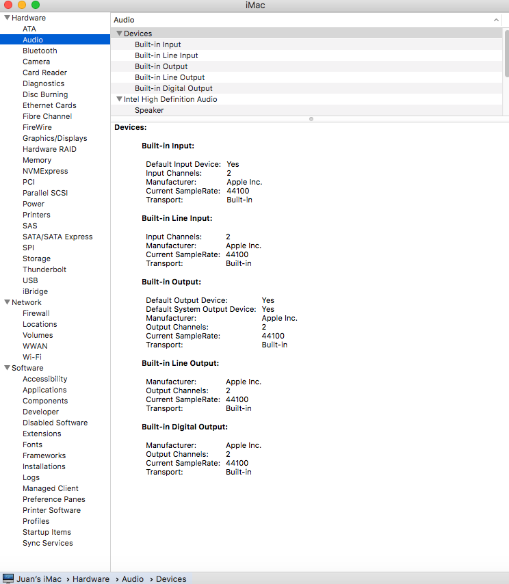

ansjuan Posted April 29, 2017 Share Posted April 29, 2017 Hello, First I wanted to thank Denicio for his fantastic post, it helped me a lot during my installation. I have been able to run OS X Sierra smoothly following this guide, but I still have some thins not working, and I thought that you might be able to help me here. My configuration is the following: - Asrock h170m itx ac - i5 6500 - evga gtx 1060 6gb (I have been able to install the new pascal web drivers) - 16 gb ram ddr4 I also purchased and installed the following Wifi/bt card: BMC94360CD Things not working: - Audio (only have been able to test hdmi audio. I have tried installing ACL892 driver through [url="http://www.insanelymac.com/forum/topic/279450-why-insanelymac-does-not-support-tonymacx86/"]#####[/url] but it doesn't work at all) - BT (wifi works natively, but Bluetooth is not even recognised by the system) ------- P.S: it is my first mackintosh so go easy on me plz Link to comment https://www.insanelymac.com/forum/topic/312085-guide-macos-sierra-1012x-on-asrock-h170m-itxac/page/11/#findComment-2414142 Share on other sites More sharing options...
Denicio Posted April 29, 2017 Author Share Posted April 29, 2017 Hello, First I wanted to thank Denicio for his fantastic post, it helped me a lot during my installation. I have been able to run OS X Sierra smoothly following this guide, but I still have some thins not working, and I thought that you might be able to help me here. My configuration is the following: - Asrock h170m itx ac - i5 6500 - evga gtx 1060 6gb (I have been able to install the new pascal web drivers) - 16 gb ram ddr4 I also purchased and installed the following Wifi/bt card: BMC94360CD Things not working: - Audio (only have been able to test hdmi audio. I have tried installing ACL892 driver through ##### but it doesn't work at all) - BT (wifi works natively, but Bluetooth is not even recognised by the system) ------- P.S: it is my first mackintosh so go easy on me plz Hey, thanks for the kind words! First of all AppleALC.kect should be installed in System/Library/Extensions along with Lilu.kext in the newer versions, use a utility like Kext Wizard to do this. As for the Bluetooth, the only way to make it work is to have sorted out all your USB ports successfully, please attach your EFI/Clover folder as a .zip so I can take a look Link to comment https://www.insanelymac.com/forum/topic/312085-guide-macos-sierra-1012x-on-asrock-h170m-itxac/page/11/#findComment-2414183 Share on other sites More sharing options...

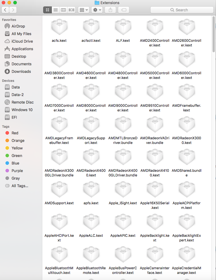

ansjuan Posted April 30, 2017 Share Posted April 30, 2017 Hey, thanks for the kind words! First of all AppleALC.kect should be installed in System/Library/Extensions along with Lilu.kext in the newer versions, use a utility like Kext Wizard to do this. As for the Bluetooth, the only way to make it work is to have sorted out all your USB ports successfully, please attach your EFI/Clover folder as a .zip so I can take a look I have tried to install AppleALC and Lilu kexts in System/Library/Extensions with KextWizard (I have also tried similar programs) but once I reboot I search them in that folder and they are not there (I have disabled SIP as well but it seems I cannot install kexts, maybe I am skipping some step idk). And it is weird because I tried using another program for loading the kexts (kext utility) and it says something like "AppleALC kext already found in S/L/E, creating backup..." , but when I go to that folder it is not there. I have attached my clover .zip, thank you very much (again ) CLOVER.zip 1 Link to comment https://www.insanelymac.com/forum/topic/312085-guide-macos-sierra-1012x-on-asrock-h170m-itxac/page/11/#findComment-2414820 Share on other sites More sharing options...
MaLd0n Posted April 30, 2017 Share Posted April 30, 2017 I have tried to install AppleALC and Lilu kexts in System/Library/Extensions with KextWizard (I have also tried similar programs) but once I reboot I search them in that folder and they are not there (I have disabled SIP as well but it seems I cannot install kexts, maybe I am skipping some step idk). And it is weird because I tried using another program for loading the kexts (kext utility) and it says something like "AppleALC kext already found in S/L/E, creating backup..." , but when I go to that folder it is not there. I have attached my clover .zip, thank you very much (again ) post ur files here, just run, files generate in desktop RunMe.app.zip 1 Link to comment https://www.insanelymac.com/forum/topic/312085-guide-macos-sierra-1012x-on-asrock-h170m-itxac/page/11/#findComment-2414889 Share on other sites More sharing options...

Denicio Posted May 3, 2017 Author Share Posted May 3, 2017 I have tried to install AppleALC and Lilu kexts in System/Library/Extensions with KextWizard (I have also tried similar programs) but once I reboot I search them in that folder and they are not there (I have disabled SIP as well but it seems I cannot install kexts, maybe I am skipping some step idk). And it is weird because I tried using another program for loading the kexts (kext utility) and it says something like "AppleALC kext already found in S/L/E, creating backup..." , but when I go to that folder it is not there. I have attached my clover .zip, thank you very much (again ) From what I can see here are my observations: - You have several AppleHDA related patches on "KextsToPatch" section, not needed. - Also on "KextsToPatch" you don't need the Boot Glitch fix, it's only for Intel GPU. - Either you keep "Rename HDAS to HDEF" or "FixHDA_8000, not both! - On "Drop Tables" you need to specify your SSDT-2.aml file for it to work. - You are using "uia_exclude" on your boot flags, this is not needed if you don't use USBInjectAll.kext. Simple solution: Download again the latest config.plist from this guide All my remarks above are included on the guide's files. I think you are very close to making it work, Bluetooth for example relies on correct USB layout configuration. Keep it up! Link to comment https://www.insanelymac.com/forum/topic/312085-guide-macos-sierra-1012x-on-asrock-h170m-itxac/page/11/#findComment-2416590 Share on other sites More sharing options...
ansjuan Posted May 7, 2017 Share Posted May 7, 2017 From what I can see here are my observations: - You have several AppleHDA related patches on "KextsToPatch" section, not needed. - Also on "KextsToPatch" you don't need the Boot Glitch fix, it's only for Intel GPU. - Either you keep "Rename HDAS to HDEF" or "FixHDA_8000, not both! - On "Drop Tables" you need to specify your SSDT-2.aml file for it to work. - You are using "uia_exclude" on your boot flags, this is not needed if you don't use USBInjectAll.kext. Simple solution: Download again the latest config.plist from this guide All my remarks above are included on the guide's files. I think you are very close to making it work, Bluetooth for example relies on correct USB layout configuration. Keep it up! I have done a clean installation now, still not all usb are working, neither bt nor audio. Should I install the kexts MalD0n said? I have tried installing clover and replacing the folder as he said and I couldn't even boot the system Send me ansjuan iMac.zip Link to comment https://www.insanelymac.com/forum/topic/312085-guide-macos-sierra-1012x-on-asrock-h170m-itxac/page/11/#findComment-2419091 Share on other sites More sharing options...
Denicio Posted May 7, 2017 Author Share Posted May 7, 2017 I have done a clean installation now, still not all usb are working, neither bt nor audio. Should I install the kexts MalD0n said? I have tried installing clover and replacing the folder as he said and I couldn't even boot the system If you followed my suggestions, I would like to take a look at your CLOVER folder one more time Maybe I am missing something. Link to comment https://www.insanelymac.com/forum/topic/312085-guide-macos-sierra-1012x-on-asrock-h170m-itxac/page/11/#findComment-2419104 Share on other sites More sharing options...

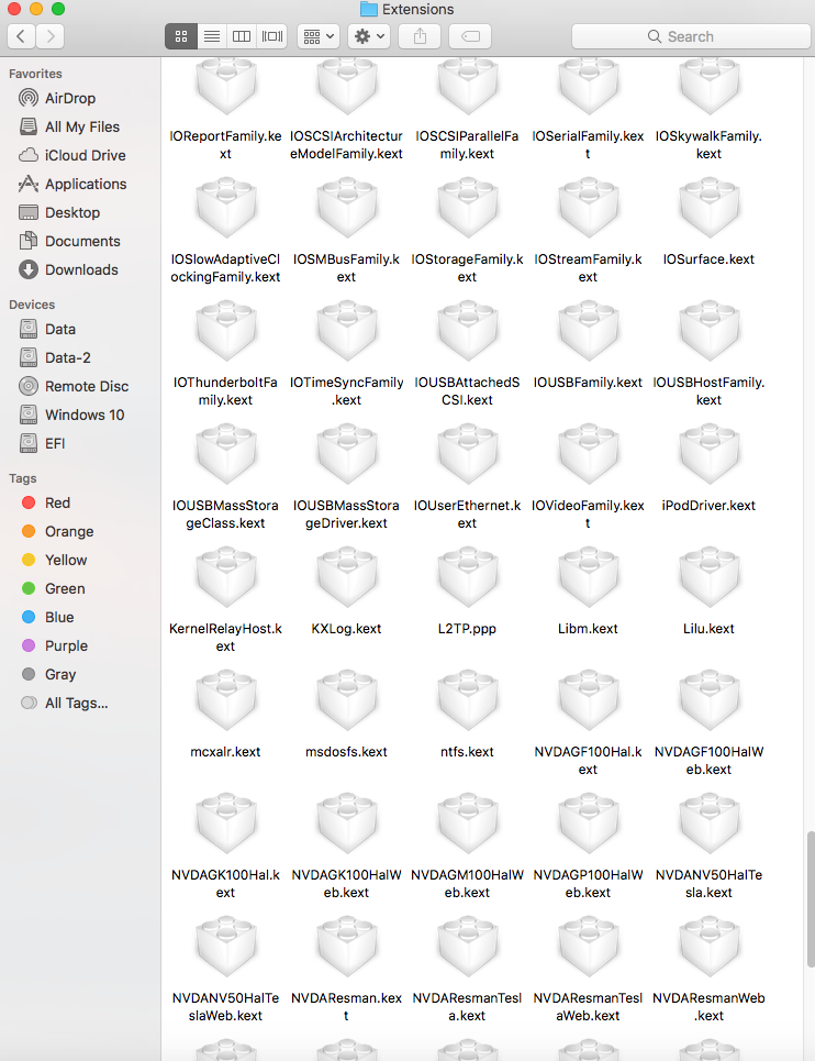

ansjuan Posted May 7, 2017 Share Posted May 7, 2017 If you followed my suggestions, I would like to take a look at your CLOVER folder one more time Maybe I am missing something. I have attached it. I have also successfully installed lilu and appleALC kexts in S/L/E, but it is still not working :S . Many thanks in advance for the effort anyway Denicio I have attached some screenshots as well. It is weird because it seems to be at least something installed in audio. Nothing for bt though, I am even considering buying a dongle, because I am not being able to make it work in windows 10 too (I have dual boot) CLOVER ansjuan.zip Link to comment https://www.insanelymac.com/forum/topic/312085-guide-macos-sierra-1012x-on-asrock-h170m-itxac/page/11/#findComment-2419106 Share on other sites More sharing options...

Denicio Posted May 7, 2017 Author Share Posted May 7, 2017 I have attached it. I have also successfully installed lilu and appleALC kexts in S/L/E, but it is still not working :S . Many thanks in advance for the effort anyway Denicio I have attached some screenshots as well. It is weird because it seems to be at least something installed in audio. Nothing for bt though, I am even considering buying a dongle, because I am not being able to make it work in windows 10 too (I have dual boot) OK there are a few more things I've noticed: - On /kexts just keep one folder populated! Either 10.12 or Other Not many at a time. - Delete USBInjectAll.kext from all your folders, you don't need it. And maybe that is the reason your USB / Bluetooth layout is not working properly. - Your AppleALC.kext is v1.0.19, delete it. Install the latest version of AppleALC.kext and Lilu.kext on System/Library/Extensions only! Latest is v1.1.1. - On config.plist you have enabled Audio Layout 3, why? The correct is 1. - On config.plist also: Don't inject Intel, nor platform-ig for Intel... You have a NVIDIA card, right? Try to follow these, and report back. Good luck and skills! 1 Link to comment https://www.insanelymac.com/forum/topic/312085-guide-macos-sierra-1012x-on-asrock-h170m-itxac/page/11/#findComment-2419164 Share on other sites More sharing options...
ansjuan Posted May 7, 2017 Share Posted May 7, 2017 OK there are a few more things I've noticed: - On /kexts just keep one folder populated! Either 10.12 or Other Not many at a time. - Delete USBInjectAll.kext from all your folders, you don't need it. And maybe that is the reason your USB / Bluetooth layout is not working properly. - Your AppleALC.kext is v1.0.19, delete it. Install the latest version of AppleALC.kext and Lilu.kext on System/Library/Extensions only! Latest is v1.1.1. - On config.plist you have enabled Audio Layout 3, why? The correct is 1. - On config.plist also: Don't inject Intel, nor platform-ig for Intel... You have a NVIDIA card, right? Try to follow these, and report back. Good luck and skills! USBInjectAll deleted from all folders, including S/L/E AppleALC and Lil 1.1.1 installed just in S/L/E audio layout 1 set I have a NVIDIA card yes, I think I disabled those options as well, I have attached my clover folder ---- Still not working though, idk what is wrong :S CLOVER ansjuan.zip Link to comment https://www.insanelymac.com/forum/topic/312085-guide-macos-sierra-1012x-on-asrock-h170m-itxac/page/11/#findComment-2419205 Share on other sites More sharing options...
