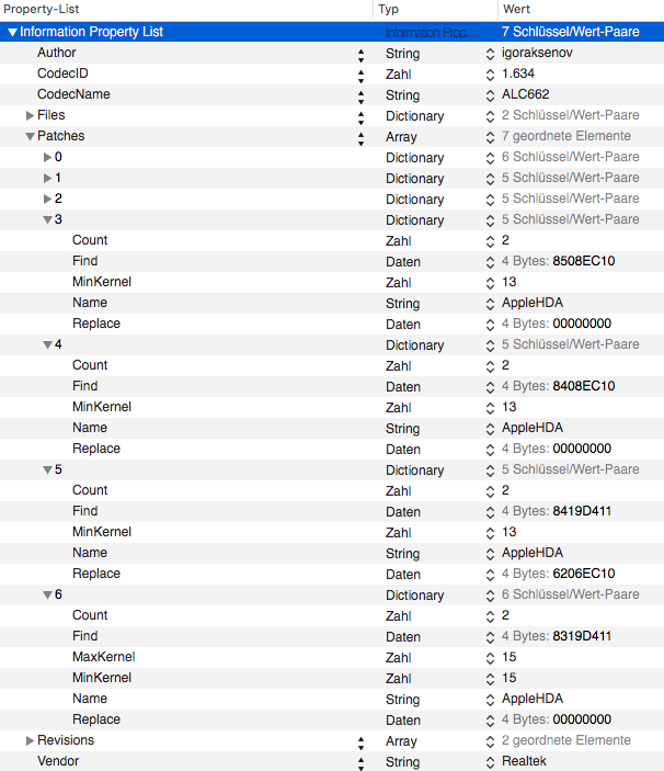

MacPeet Posted November 3, 2016 Share Posted November 3, 2016 The already filed codecs ALC662 (5, 7 and 11) are almost identical, but the patches in the source are probably old. @vandroiy2012 Are these patches ALC662 Source1.0.18 still up-to-date? Link to comment https://www.insanelymac.com/forum/topic/311293-applealc-%E2%80%94-dynamic-applehda-patching/page/42/#findComment-2313037 Share on other sites More sharing options...

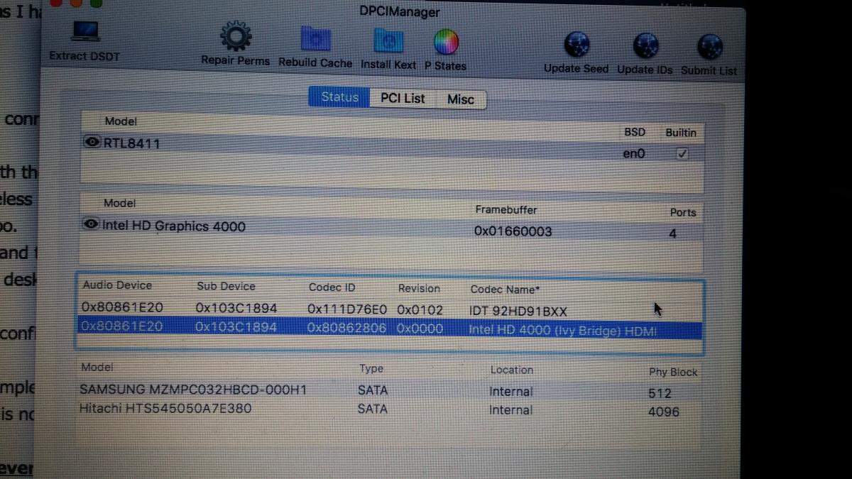

JDAwg42 Posted November 8, 2016 Share Posted November 8, 2016 Hello Friends,I would like to get further assistance with getting my audio working. I have an HP Envy 4 1110us from what i have been able to research it seems to be an ALC269 which should be supported by this. I was able to install the kext in my system and in system prefs i can see a built in speakers option as well as my microphone, mic works. I can see the audio bar go up and down as i speak. My issue is i do not get any audio from my speakers =[ I tried modifying DSDT to layout id 12 and patched with IRQ fix but no go. I also saw a reddit mentioning adding the layout id to my clover config. Would that be a better route?? Can you please help provide me with some extra help? Please advise on any information you may require from me, i would really like to have my audio working natively. =]Would it Help if i provide my DSDT?Thank You.1. HP Envy 4 1110us w/ i3-3217u 2. now i think i have IDT 92HD91BXX codec? See attached screenshot.UPDATE:CodecDump.zip added, please let me know if you need anymore info or files... CodecDump.zip Link to comment https://www.insanelymac.com/forum/topic/311293-applealc-%E2%80%94-dynamic-applehda-patching/page/42/#findComment-2315859 Share on other sites More sharing options...
