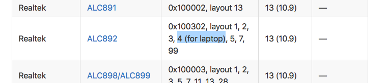

johnnynuca14 Posted October 10, 2016 Share Posted October 10, 2016 i have msi laptop with alc892, is it compatible? Link to comment https://www.insanelymac.com/forum/topic/311293-applealc-%E2%80%94-dynamic-applehda-patching/page/41/#findComment-2297251 Share on other sites More sharing options...
vandroiy2012 Posted October 10, 2016 Share Posted October 10, 2016 i have msi laptop with alc892, is it compatible? Should be. Layout 4 for laptop 892 Link to comment https://www.insanelymac.com/forum/topic/311293-applealc-%E2%80%94-dynamic-applehda-patching/page/41/#findComment-2297256 Share on other sites More sharing options...

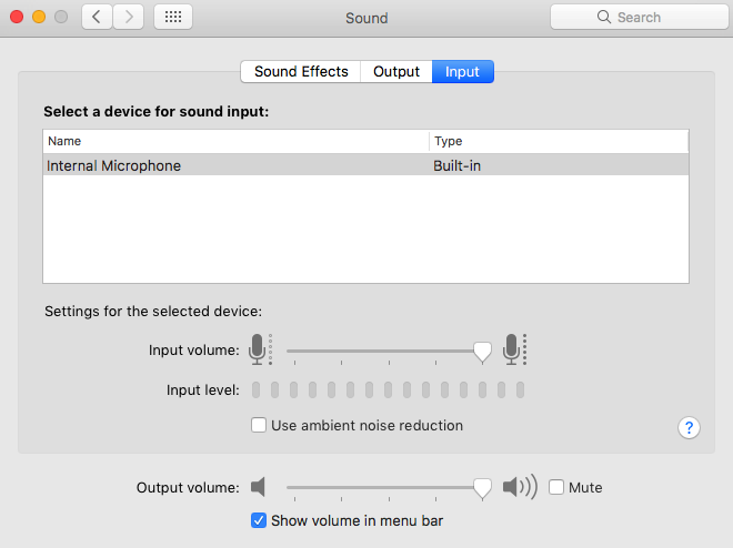

xXiGeniusXx Posted October 21, 2016 Share Posted October 21, 2016 Hi vit9696 Thanks and keep up the good work I wanted to report this bug I'm experiencing on my build. I can't seem to be able to use the microphone on Sierra 10.12, the jack is plugged into the correct pink port on the back which is working flawlessly on Windows but not on macOS! I've tried plugging the microphone jack in every other port but no luck. Also there are a few cosmetic misrepresentations, in the Sound preferences panel, I have to select the "Internal Speakers" for the correct green port (which is the speakers output on Windows and motherboard's user manual) there are 4 options total while technically there are 2 output ports and counting SPDIF results in 3 also the microphone option is recognized "Internal" as well, not sure if it is so on a real Mac. Not a deal-breaker but would be a big plus if they were represented correctly. Motherboard: Gigabyte GA-H61M-S2P-R3. (Realtek ALC887 3 Ports (layout-id: 2)) macOS 10.12 (16A323) AppleALC v1.0.17 Debug info attached. Terminal Output (ALC887).txt Link to comment https://www.insanelymac.com/forum/topic/311293-applealc-%E2%80%94-dynamic-applehda-patching/page/41/#findComment-2303340 Share on other sites More sharing options...
