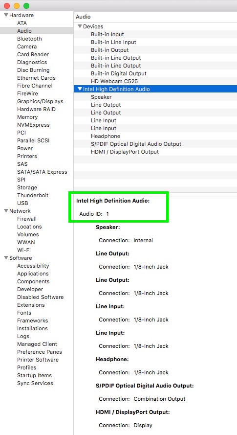

Morning.
Make sure that there is no HDAEnabler oder Disabler at work...
Check this with the System Report -> Audio and see what ID is used there:
Also the HDEF should use "onboard-1" as same as the IGPU & HDAU.
"onboard-2" should be used for external Graphics cards with HDMI-Audio.

Hi,sir!!
I just found a Digital Cable for my Speaker so I try to use it.
I checked id 6 (it was working well with my MAC)
Sound is very good!! However, Volume Control (This device has no output control) missing., other line in all work with Volume control (output control working)
Is there any edit needed to fix it?
I am so noobie of this region but if you give me the instruction I can help to improve it
Thank you!!

Digital Audio doesn't have volume control even on a real Mac. To test Digital Audio on a Hackintosh, I use an optical Toslink cable from the Hackintosh to a Mac Pro and use the LinIn.app from rogueamoeba.com on my Mac Pro to output the sound to my speakers. iTunes volume control works because it works in software.
The Z170N Gaming 5 has both an optical SPDIF output and an internal ATAPI SPDIF output. The internal ATAPI SPDIF output ranges from 0V to +3.3V instead of the standard -0.6V to +0.6V but my coax to optical adapter was able to output that to the Mac Pro anyway.

Apple has no volume control for digital in/outputs as well as HDMI and DP.
