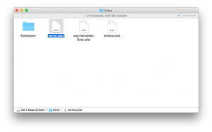

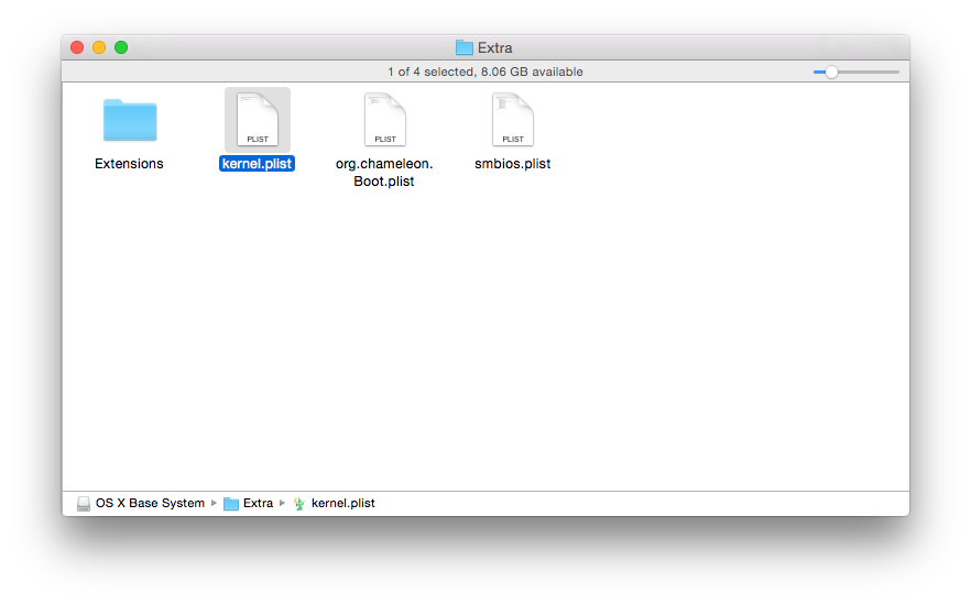

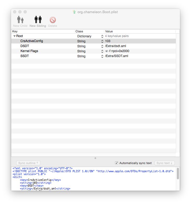

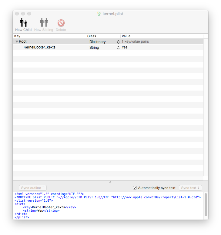

My org.chameleon.Boot.plist:
My kernel.plist:
My Extra folder:
Try to boot with flags: USBLegacyOff=Yes GraphicsEnabler=Yes, and without. Same result.
Every time same in log and I don't see that my graphic card loaded.
My graphics works great in Yosemite with edited DSDT.
With 10.11 I try to boot with and without DSDT file. Same result.

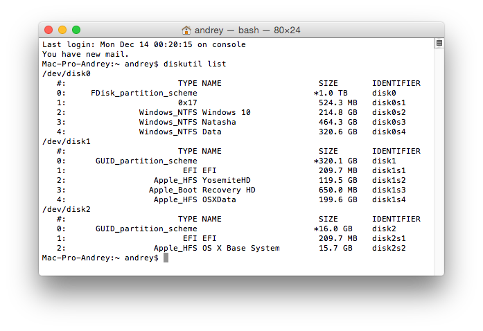

And I don't have volume 'untitled'

First make sure you'r using this kernel, http://www.insanelymac.com/forum/topic/309765-amd-os-x-el-capitan-1011-kernel-testing-release-for-help-use-the-help-topic/?p=2196723
Also you have CrsActiveConfig instead of CsrActiveConfig

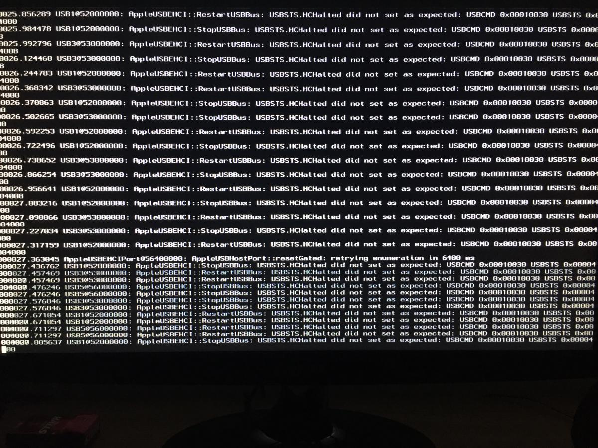

OK I started El Cappy installer with
-v npci=0x3000 GraphicsEnabler=No
And It got to OS X verbose then spams USB stuff so I'm going to read up on El Cappy's new USB issues :D .
Tried with disabling USB 2.0 and such USBLegacyOff=Yes, nothing :(

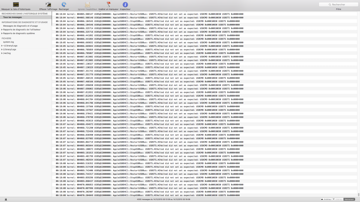

no change :(
usb2 chiot !!

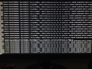

@gils83 I have the exact same error when I try to boot from installer and I can't pass it. Is it kernel related?
yes is big problem :(

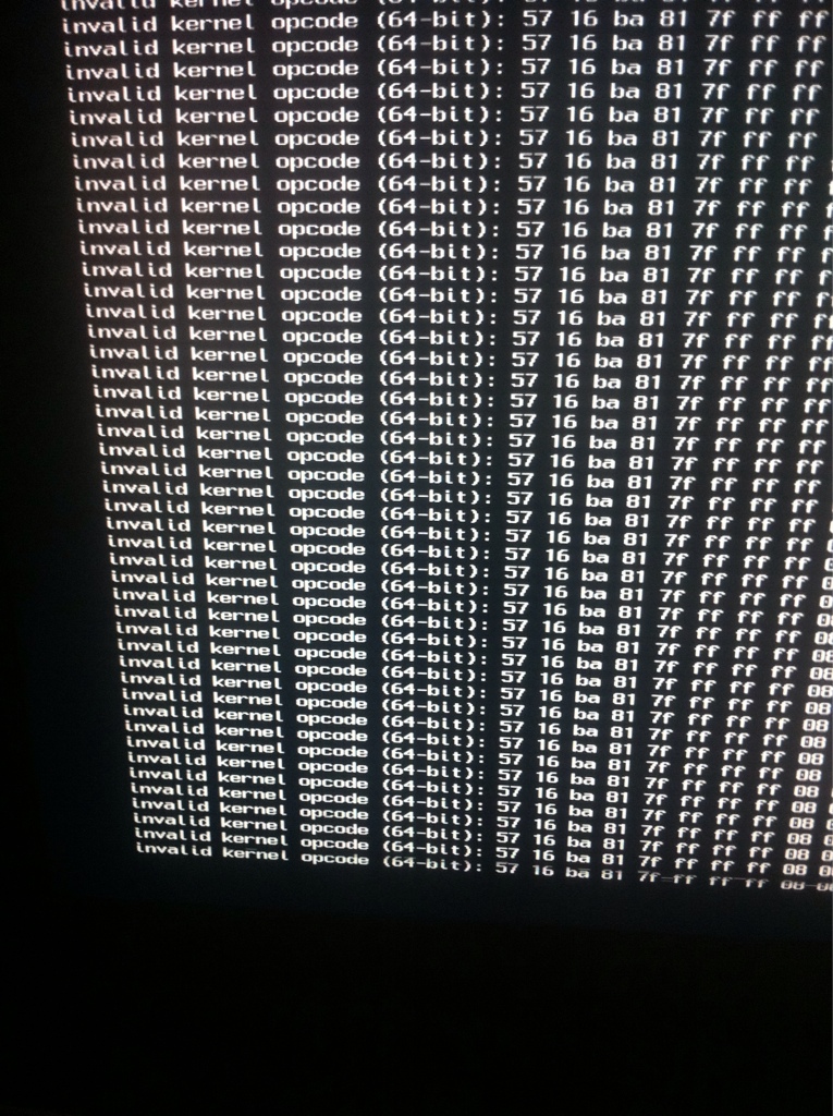

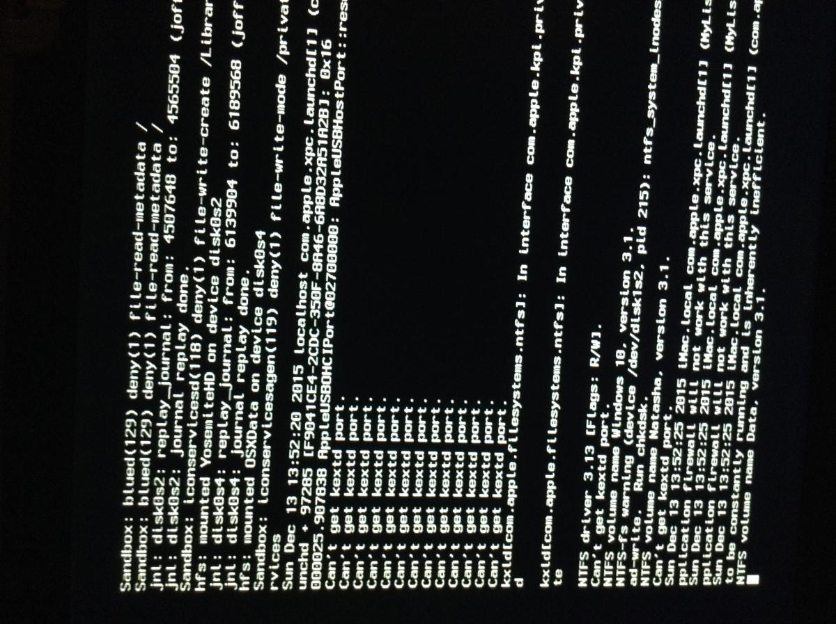

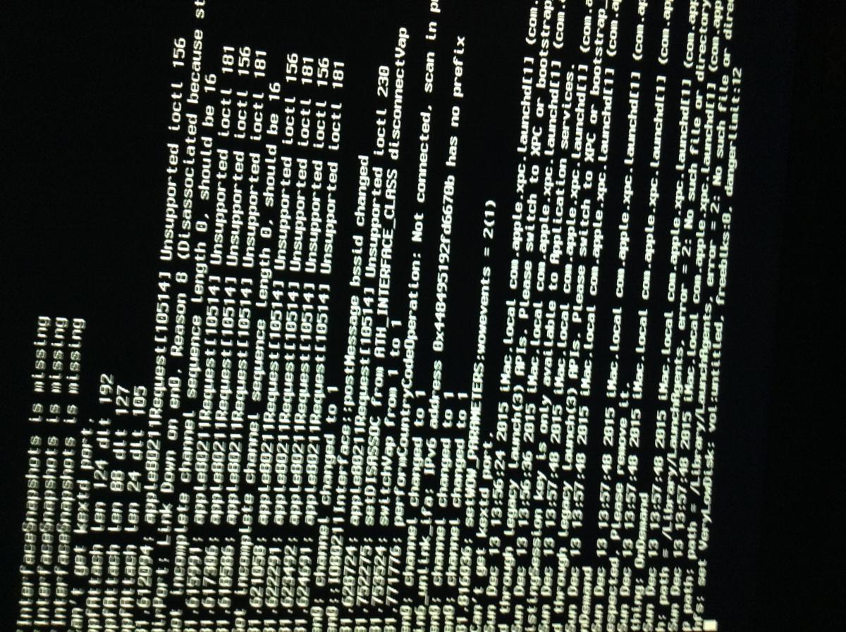

Thanks guys, I corrected my boot plist file and now i see that my graphis card loaded) just one letter was written incorrectly and problem.
But now i have opcode error. attachicon.gifImageUploadedByTapatalk1450049444.800717.jpg
Will try another kernels)
use Enock 2795 , problem with chameleon :)
@Gils
Tu ne pourras pas régler les problèmes d'USB avec des boot-flags :(. Il faut que tu détermine les adresses de tes ports USB2/3 avec IOReg (le mieux est de le faire sous Yosemite) et qu'en fonction de ta DSDT, tu créés un dummy ou plusieurs dummy ou un USB_injector pour qu'ils soient reconnus par El Cap.
Tu dois aussi avoir deux fichiers séparés : o.c.B.p et kernel.plist Tu ne peux pas mettre toutes les infos dans le même fichier.
You can't fix USB issues with just some boot-flags. You need to analyze both IOReg (best is to use Yosemite to do that) and DSDT to determine what's the correct addresses of your USB2/USB3 ports then create dummy(s) kext(s) or USB Injector.
And you also need to have separate files for both o.c.B.p and kernel.plist. You can't have all values in just one file.
It's NOT kernel related. It's caused by new USB management of El Capitan and it's the same for Intel's systems !!!
