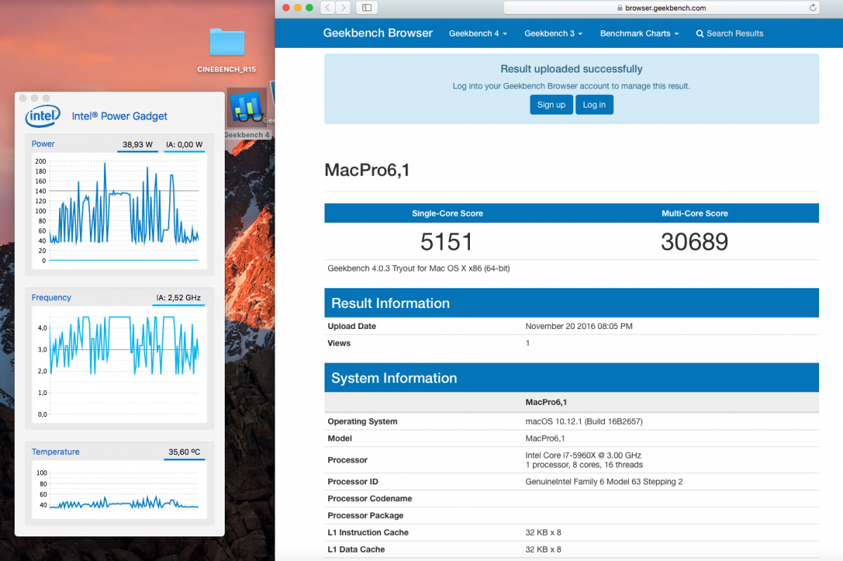

I applied the patch but I am low score  :(
See: https://browser.geekbench.com/v4/cpu/653574
What BIOS CPU settings are you using?
A screenshot of Intel Power Gadget while Cinebench CPU test is running would be helpful.
Edit: are you sure your scores are low? You used Geekbench 4, which has ~30% lower scores by design than Geekbench 3. Your CPU might be performing as it should.

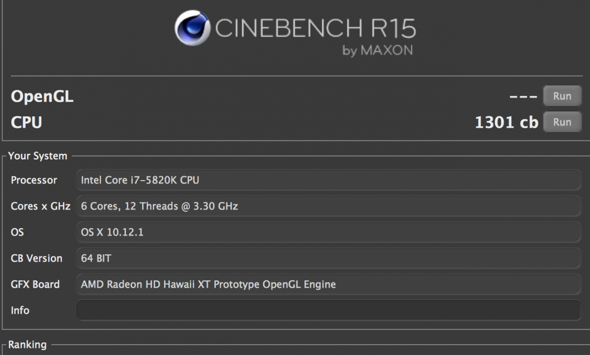

BIOS Settings:
EIST/C1E/C3/C6/C7 - Enable
The correct would be 22000~23000 in Geekbench 4, see: https://browser.primatelabs.com/v4/cpu/605038
Not use: FakeCPUID, NullCPU ...
Cinebench score: 910, correct would be 1100~1150, 4.2ghz OC :(
Intel Power Gadget dont work, only Sandybrigde CPUs :(

https://browser.geekbench.com/v4/cpu/724144
It does better than windows now :) I ran the AI Tweaker and disabled C6 state but kept C3 enabled as in the other thread by SammlerG.
Should I also enable C6 in BIOS? Also, I should watch the monitor closely if it sticks in 4 GHz. Afraid of overheat and cooking the CPU. Wonder if this is purely the patch or if it's both the patch and AI Tweaker Wizard together.

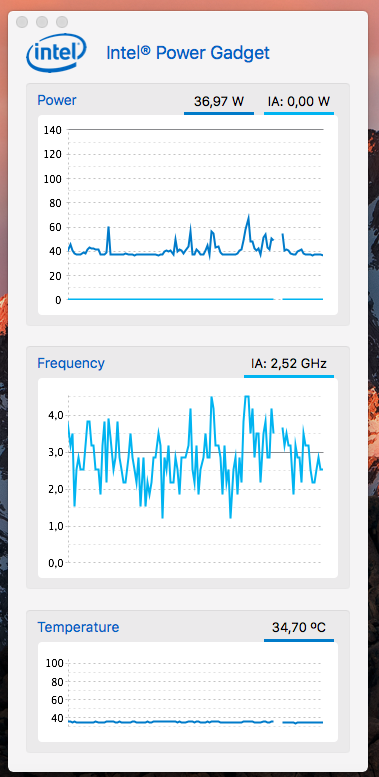

the issue is that intelpowergadget says that my cpu draws 35watt or more in idle.this value was the same (27-28w)with default cpu frequencies (so not depends on overclock)
