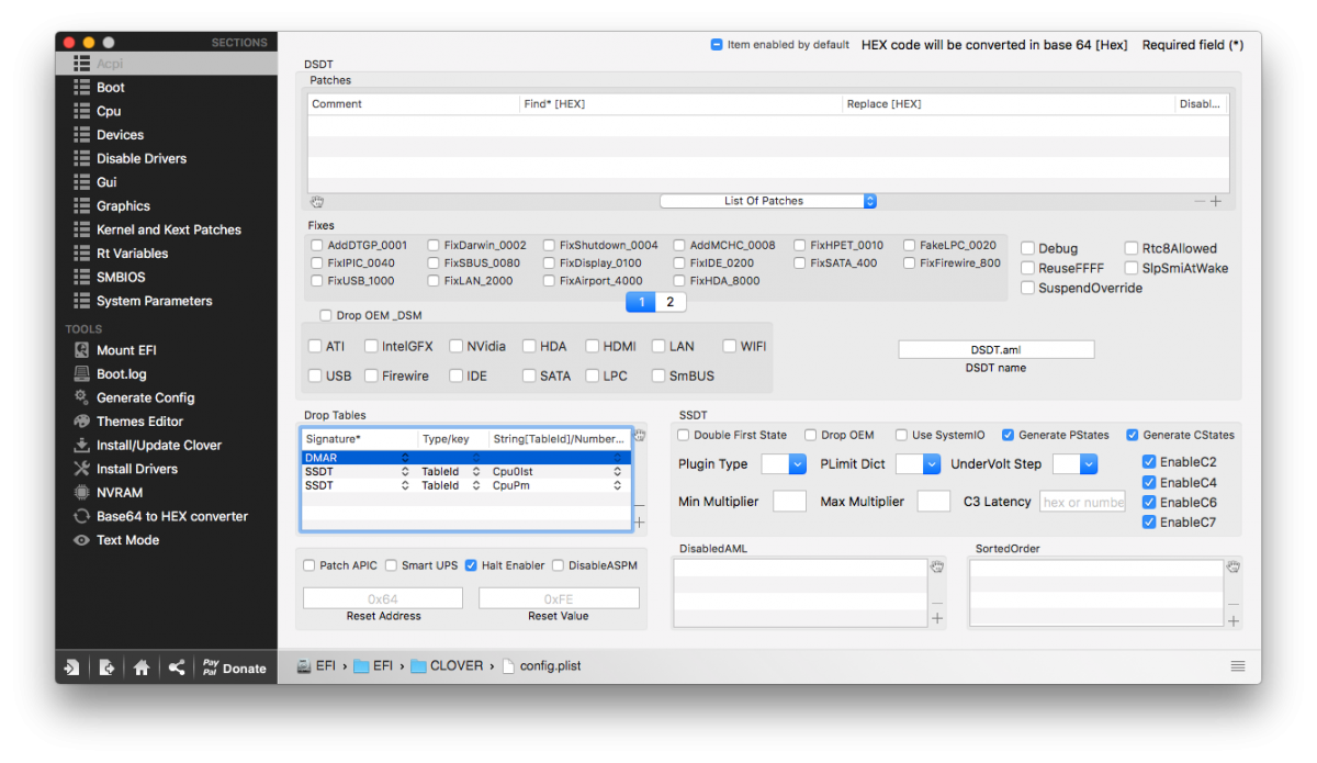

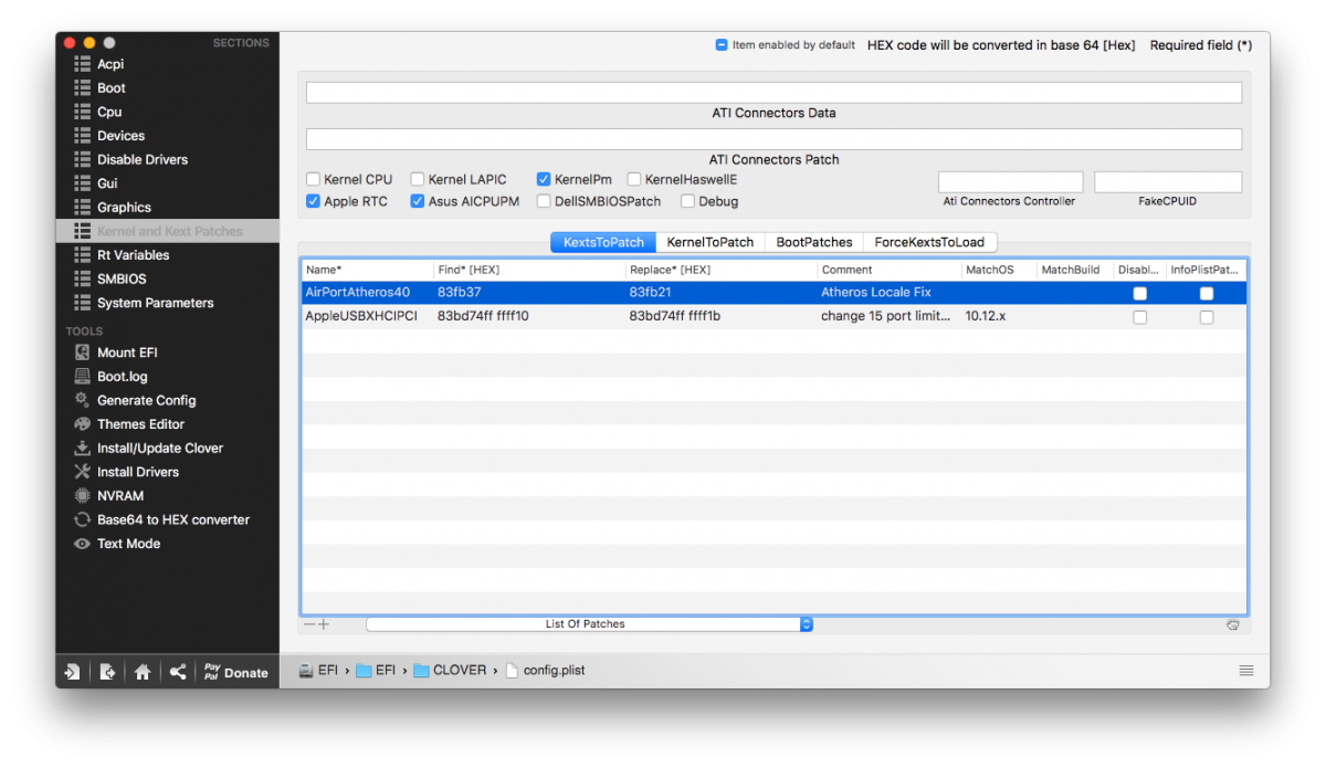

Cyberdevs Posted May 4, 2017 Author Share Posted May 4, 2017 Hey guys, what's up? I recently found a Patched DSDT for GA-Z170X-Gaming 5 mainboards and it works just fine. I removed all the previous patches from clover and as far as I know everything works fine on macOS Sierra 10.12.4 I cannot confirm it for El Capitan but it should work as well. Feel free to test it out and post your experience here. Here is the link to barijaona's GitHub page and all the credit goes to him. https://github.com/barijaona/CLOVER_GA-Z170X-Gaming5 Cheers 1 Link to comment https://www.insanelymac.com/forum/topic/309352-el-capitan-on-ga-z170x-gaming-5/page/26/#findComment-2417705 Share on other sites More sharing options...
MaLd0n Posted May 4, 2017 Share Posted May 4, 2017 Hey guys, what's up? I recently found a Patched DSDT for GA-Z170X-Gaming 5 mainboards and it works just fine. I removed all the previous patches from clover and as far as I know everything works fine on macOS Sierra 10.12.4 I cannot confirm it for El Capitan but it should work as well. Feel free to test it out and post your experience here. Here is the link to barijaona's GitHub page and all the credit goes to him. https://github.com/barijaona/CLOVER_GA-Z170X-Gaming5 Cheers Hi U can test? http://www.insanelymac.com/forum/topic/317548-guide-macos-sierra-1012x-on-gigabyte-z170x-gaming-5/?p=2417732 Link to comment https://www.insanelymac.com/forum/topic/309352-el-capitan-on-ga-z170x-gaming-5/page/26/#findComment-2417741 Share on other sites More sharing options...
Cyberdevs Posted May 5, 2017 Author Share Posted May 5, 2017 After using MaLd0n's patched DSDT I can confirm: I removed the following patches from ACPI: change _OSI to XOSI Change EHC2 to EH02 Rename HDAS to HDEF Change EHC1 to EH01 and I don't need FixShutdown_0004 anymore and with your AppleALC.kext I don't need AppleHDA patches I still use the following Kernel and Kext Patches AirPortAtheros40 AppleUSBXHCIPCI Thank you MaLd0n 1 Link to comment https://www.insanelymac.com/forum/topic/309352-el-capitan-on-ga-z170x-gaming-5/page/26/#findComment-2417861 Share on other sites More sharing options...

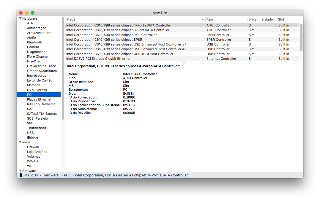

Cyberdevs Posted May 5, 2017 Author Share Posted May 5, 2017 cyber, send me one ioreg, i apply some cosmetics, the people like it IORegistryExplorer.app.zip like it MaLd0n 2017-05-05 às 09.42.55.png only cosmetics, but good There you go And Thanks!! Cyberdev’s iMac.zip 1 Link to comment https://www.insanelymac.com/forum/topic/309352-el-capitan-on-ga-z170x-gaming-5/page/26/#findComment-2417976 Share on other sites More sharing options...
MaLd0n Posted May 5, 2017 Share Posted May 5, 2017 Here u go DSDT.GA-Z170X-Gaming 5.zip the best for intel lan is Mieze kext, AppleIntelE cause some problems IntelMausiEthernet.kext.zip For load LMU, need mod in fakesmc FakeSMC.kext.zip with sensors FakeSMC.SENSORS.zip 1 Link to comment https://www.insanelymac.com/forum/topic/309352-el-capitan-on-ga-z170x-gaming-5/page/26/#findComment-2417996 Share on other sites More sharing options...
