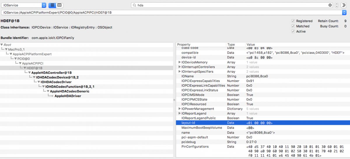

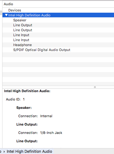

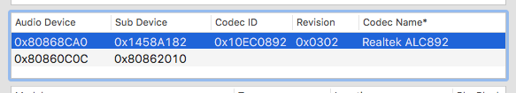

viitols Posted January 22, 2016 Share Posted January 22, 2016 Hey Toleda, I've used your CloverALC method to inject Audio ID 1 for ALC 892. I've got the correct layout-id in IOReg and still no audio devices show up. Using original AppleHDA.kext, kext-dev-mode boot flags, and removed other HDAenablers etc. Even running the audio_codecdetect.command shows that everything is ok. Clover config: <key>KextsToPatch</key> <array> <dict> <key>Comment</key> <string>t1-10.9-10.11-AppleHDA/Realtek ALC892</string> <key>Find</key> <data> ixnUEQ== </data> <key>Name</key> <string>AppleHDA</string> <key>Replace</key> <data> kgjsEA== </data> </dict> <dict> <key>Comment</key> <string>t1-AppleHDA/Resources/xml>zml</string> <key>Find</key> <data> eG1sLnps </data> <key>Name</key> <string>AppleHDA</string> <key>Replace</key> <data> em1sLnps </data> </dict> <dict> <key>Comment</key> <string>t1-10.11-AppleHDA/Realtek ALC...</string> <key>Find</key> <data> gxnUEQ== </data> <key>Name</key> <string>AppleHDA</string> <key>Replace</key> <data> AAAAAA== </data> </dict> </array> Any steps I'm missing? Thanks! Link to comment https://www.insanelymac.com/forum/topic/308387-el-capitan-realtek-alc-applehda-audio/page/6/#findComment-2209150 Share on other sites More sharing options...

toleda Posted January 22, 2016 Author Share Posted January 22, 2016 here it is. With SIP disabled, rebuild kernel cache. Reply with new files. 1 Link to comment https://www.insanelymac.com/forum/topic/308387-el-capitan-realtek-alc-applehda-audio/page/6/#findComment-2209386 Share on other sites More sharing options...
viitols Posted January 23, 2016 Share Posted January 23, 2016 Disabled SIP completely. Ran this to clear the cache: System Integrity Protection status: disabled. sudo touch /System/Library/Extensions/ && sudo kextcache -u / Link to comment https://www.insanelymac.com/forum/topic/308387-el-capitan-realtek-alc-applehda-audio/page/6/#findComment-2209531 Share on other sites More sharing options...
toleda Posted January 23, 2016 Author Share Posted January 23, 2016 Disabled SIP completely. Ran this to clear the cache: Do not see the problem. Has sound worked previously? With Windows? If convenient, a clean install on an empty partition may be helpful. 1 Link to comment https://www.insanelymac.com/forum/topic/308387-el-capitan-realtek-alc-applehda-audio/page/6/#findComment-2209814 Share on other sites More sharing options...

viitols Posted January 27, 2016 Share Posted January 27, 2016 Do not see the problem. Has sound worked previously? With Windows? If convenient, a clean install on an empty partition may be helpful. Thanks, that did the trick. Instead of importing everything from time machine and having old kexts in there, I manually moved the files I need. Link to comment https://www.insanelymac.com/forum/topic/308387-el-capitan-realtek-alc-applehda-audio/page/6/#findComment-2210841 Share on other sites More sharing options...
