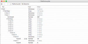

toleda Posted October 25, 2015 Author Share Posted October 25, 2015 It appears that I can edit Platforms.zml as described, but I can't find the same items in the Platforms.xml to edit. Also, the structure of the HDAHardwareConfigDriver/info.plist seems to be different than is described, and I cannot figure out how to achieve the edits listed. Impossible to convert .txt files back to .plist Attach Platforms.zml as Platforms.plist and compress Attach EFI/CLOVER/kext/10.11/realtekALC.kext/Contents/Info.plist and compress Link to comment https://www.insanelymac.com/forum/topic/308387-el-capitan-realtek-alc-applehda-audio/page/2/#findComment-2182039 Share on other sites More sharing options...
Adventuro-3 Posted October 25, 2015 Share Posted October 25, 2015 Impossible to convert .txt files back to .plist Attach Platforms.zml as Platforms.plist and compress Attach EFI/CLOVER/kext/10.11/realtekALC.kext/Contents/Info.plist and compress Thanks for the quick reply. Requested files attached. Platforms.plist.zip Info.plist.zip Link to comment https://www.insanelymac.com/forum/topic/308387-el-capitan-realtek-alc-applehda-audio/page/2/#findComment-2182168 Share on other sites More sharing options...

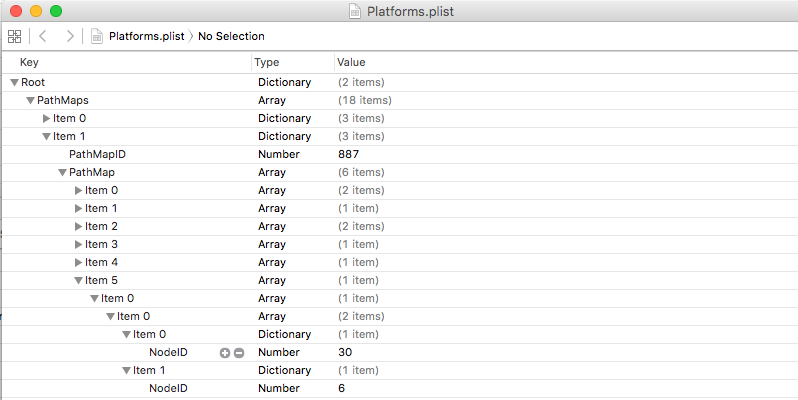

toleda Posted October 26, 2015 Author Share Posted October 26, 2015 Requested files attached. Codec: 887, Audio ID: 1, apply fixes as noted Customization/Appendix B: Platforms: Info: (my mistake, add 2 to Item) Link to comment https://www.insanelymac.com/forum/topic/308387-el-capitan-realtek-alc-applehda-audio/page/2/#findComment-2182192 Share on other sites More sharing options...

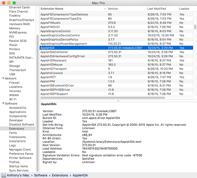

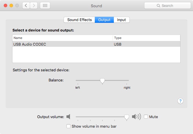

Adventuro-3 Posted October 30, 2015 Share Posted October 30, 2015 Codec: 887, Audio ID: 1, apply fixes as noted Customization/Appendix B: Platforms: Screen Shot 2015-10-25 at 11.16.43 PM.png Info: (my mistake, add 2 to Item) Screen Shot 2015-10-25 at 11.22.47 PM.png Sorry for the long delay in responding, but work and life got in the way. I could not get this to work. For sake of simplicity, I removed all the Clover kexts to modify from the config.plist, and the realtek_HDA.kext from the Clover 10.11 folder. Then I went back to the original AppleHDA.kext, and ran audio_realtekALC-110_v1.0h.command (see attached alc_110_Terminal.txt) After restart, analog audio was working, digital out was not. I applied the fixes to Item 0 on Platforms.xml, and Item 3 on HDAHardwareConfigDriver/info.plist, as it appears this is what was needed from the instruction in your post. After installation and restart, none of the onboard audio choices show at all. This is what was happening with the Clover configuration, but I decided that this would be easier to diagnose, fix and re-apply after updates using just a modified AppleHDA.kext. I still am able to use my external USB audio driver, but I want to try to fix the internal one so I don't need to use it. Here are my current audio choices: It appears that modified AppleHDA.kext is loading: I have attached my modified AppleHDA.kext. Did I make an incorrect edit somewhere, or is there some other problem with the kext or my procedure? AppleHDA.kext.zip alc_110_Terminal.txt Link to comment https://www.insanelymac.com/forum/topic/308387-el-capitan-realtek-alc-applehda-audio/page/2/#findComment-2183796 Share on other sites More sharing options...

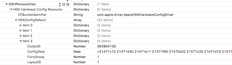

toleda Posted October 31, 2015 Author Share Posted October 31, 2015 Here you go... Info. plist is not correct. Start over Item 1 (edit this item only, not all items) original (2117): 21171cf0 21171d00 21171e00 21171f40 actual edit (2177): 21771cf0 21771d00 21771e00 21771f40 (mistake) replace edit (2117): 21171ca0 21171d01 21171e43 21171f99 (do not add, replace original) Same for second edit. Verify edits Find (1x): 21171ca0 21171d01 21171e43 21171f99 Find (1x): 21e71cf0 21e71d00 21e71e00 21e71f40 Reply with new Info. plist Link to comment https://www.insanelymac.com/forum/topic/308387-el-capitan-realtek-alc-applehda-audio/page/2/#findComment-2183939 Share on other sites More sharing options...
Adventuro-3 Posted October 31, 2015 Share Posted October 31, 2015 Info. plist is not correct. Start over Item 1 (edit this item only, not all items) original (2117): 21171cf0 21171d00 21171e00 21171f40 actual edit (2177): 21771cf0 21771d00 21771e00 21771f40 (mistake) replace edit (2117): 21171ca0 21171d01 21171e43 21171f99 (do not add, replace original) Same for second edit. Verify edits Find (1x): 21171ca0 21171d01 21171e43 21171f99 Find (1x): 21e71cf0 21e71d00 21e71e00 21e71f40 Reply with new Info. plist I started over, but seem to have the same result. I checked the info.plist from the AppleHDA.kext that is now in S/L/E and it seems to show the correct edits (see attachment). I attached a new IOReg file as well. Anachronaut’s iMac.ioreg.zip Info.plist.zip Link to comment https://www.insanelymac.com/forum/topic/308387-el-capitan-realtek-alc-applehda-audio/page/2/#findComment-2183949 Share on other sites More sharing options...
Adventuro-3 Posted October 31, 2015 Share Posted October 31, 2015 Info. plist is not correct. Start over Item 1 (edit this item only, not all items) original (2117): 21171cf0 21171d00 21171e00 21171f40 actual edit (2177): 21771cf0 21771d00 21771e00 21771f40 (mistake) replace edit (2117): 21171ca0 21171d01 21171e43 21171f99 (do not add, replace original) Same for second edit. Verify edits Find (1x): 21171ca0 21171d01 21171e43 21171f99 Find (1x): 21e71cf0 21e71d00 21e71e00 21e71f40 Reply with new Info. plist Update: Rebuilt system and kexts caches on my startup disk with KCPM Utility Pro, restarted and now all is working, including the digital S/PDIF outputs! Hopefully it stays stable. Thanks Toleda! Note: I also tried to "Repair Permissions on Entire Disk" with this utility, but it never finished [3+ hours], so perhaps something changed in 10.11.1. 1 Link to comment https://www.insanelymac.com/forum/topic/308387-el-capitan-realtek-alc-applehda-audio/page/2/#findComment-2184095 Share on other sites More sharing options...
