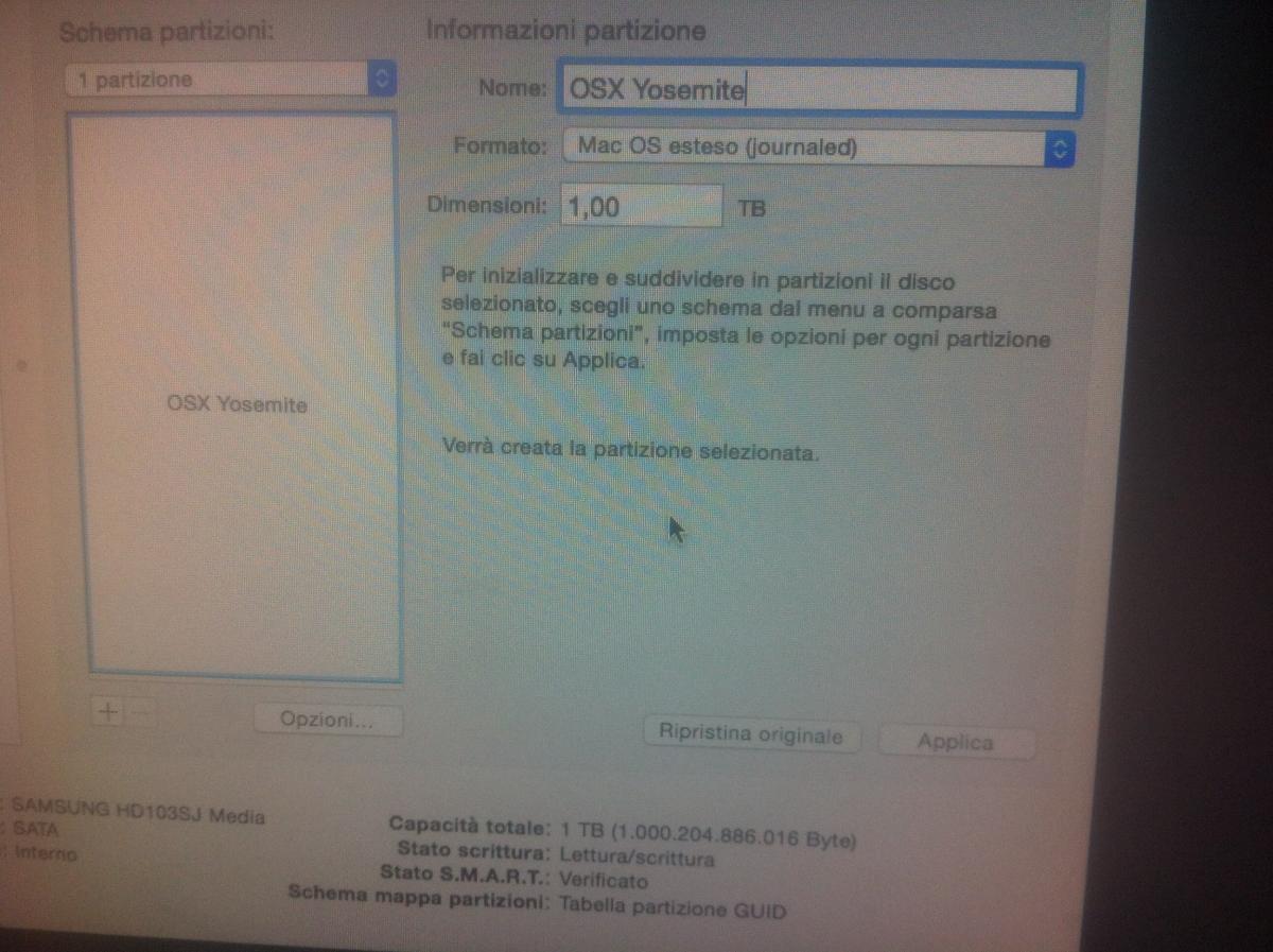

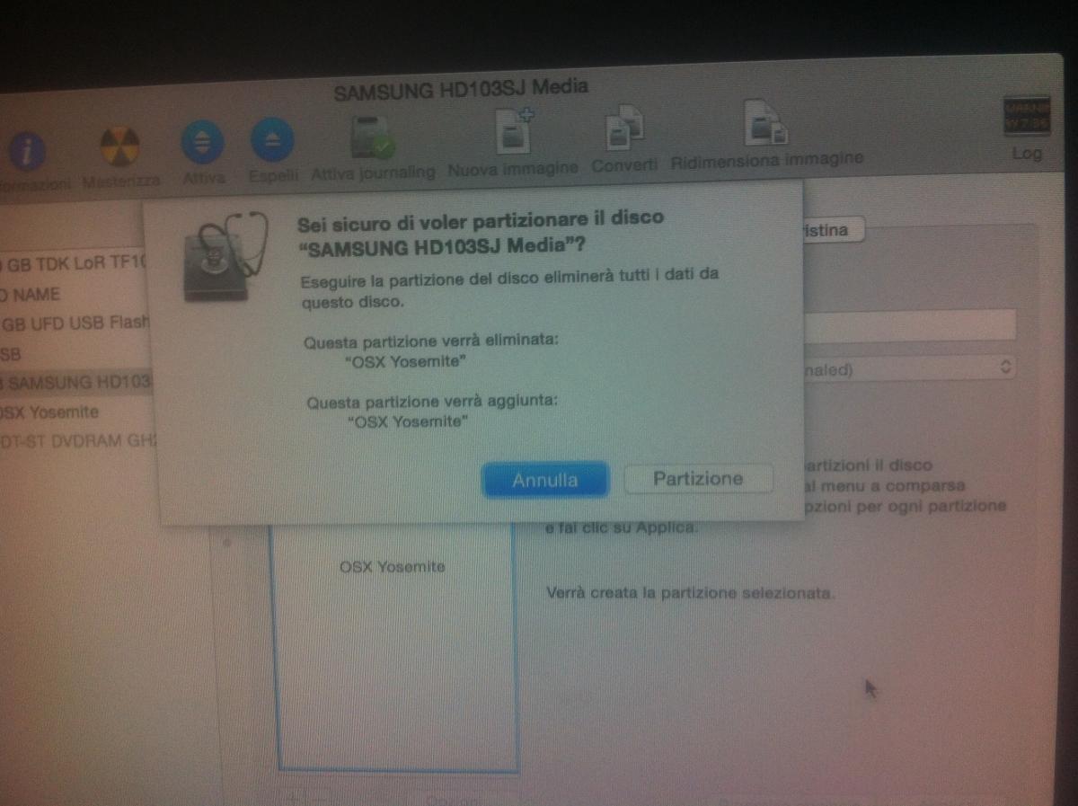

38nic Posted May 31, 2015 Author Share Posted May 31, 2015 Stupida domanda, il disco hd partizione1 mac os esteso journaled in guid e' corretto, ma faccio solo applica come da foto e poi mi chiede di sostituire l'hd con quello nuovo? Link to comment https://www.insanelymac.com/forum/topic/306272-sistema-compatibile/page/13/#findComment-2140299 Share on other sites More sharing options...
gengik84 Posted May 31, 2015 Share Posted May 31, 2015 si ok...clicca su partiziona @ Fabio...Help Link to comment https://www.insanelymac.com/forum/topic/306272-sistema-compatibile/page/13/#findComment-2140301 Share on other sites More sharing options...

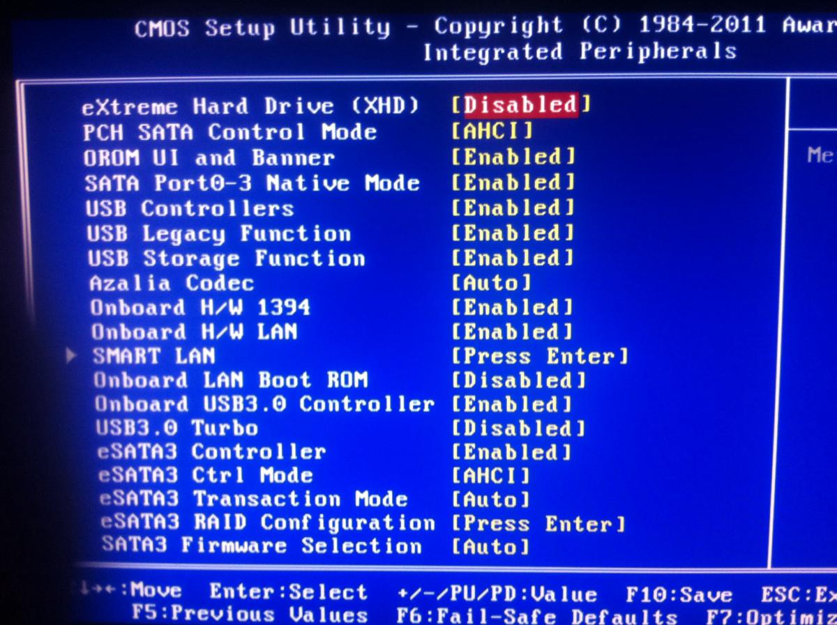

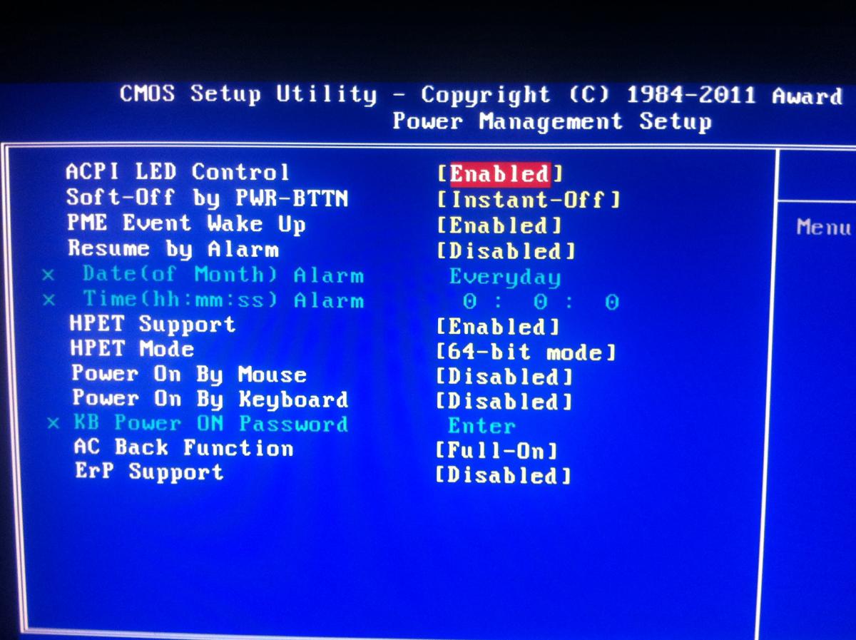

Fabio1971 Posted May 31, 2015 Share Posted May 31, 2015 Controlla nel bios : Sata= Ahci GSata= Ahci Acpi SuspendType= S3 Hpet= 64bit Fabio Link to comment https://www.insanelymac.com/forum/topic/306272-sistema-compatibile/page/13/#findComment-2140306 Share on other sites More sharing options...
38nic Posted May 31, 2015 Author Share Posted May 31, 2015 Sata in Ahci, Gsata non presente e Hpet gia' in 64bit. Invece Extreme hard drive in disabled Link to comment https://www.insanelymac.com/forum/topic/306272-sistema-compatibile/page/13/#findComment-2140312 Share on other sites More sharing options...
