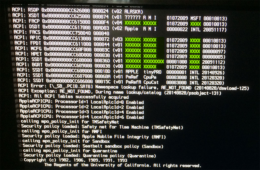

Slice Posted July 17, 2017 Share Posted July 17, 2017 Hello Slice, has been long time since my last contribute. I would like to propose ascii table header fixes discovered by @theracermaster, with ACPI -> DSDT -> Fixes -> FixHeader_0003 = TRUE. It will replace char ( 0x7E) with 0x3F ('?') on table header to avoid panics without dropping the whole table. ** Cannot compile & test this patches for you, but working well with my forked, hope you enjoy. OK, I will implement this. With some precautions If DropSSDT then your patch will not work although it is invented for MATS table first of all. Link to comment https://www.insanelymac.com/forum/topic/306156-clover-problems-and-solutions/page/92/#findComment-2464828 Share on other sites More sharing options...
bronxteck Posted July 17, 2017 Share Posted July 17, 2017 Dell Laptops do not have MATS. failpoint is BGRT table if you care to also include Link to comment https://www.insanelymac.com/forum/topic/306156-clover-problems-and-solutions/page/92/#findComment-2464867 Share on other sites More sharing options...
Slice Posted July 17, 2017 Share Posted July 17, 2017 Dell Laptops do not have MATS. failpoint is BGRT table if you care to also include Sure, all tables will be included. @cecekpawon FixAsciiTableHeader() is not possible in place because initially ACPI tables located in ROM. ReadOnlyMemory. Link to comment https://www.insanelymac.com/forum/topic/306156-clover-problems-and-solutions/page/92/#findComment-2464895 Share on other sites More sharing options...

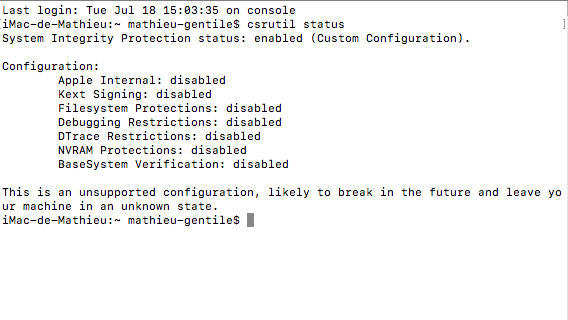

Matgen84 Posted July 18, 2017 Share Posted July 18, 2017 Hi. I noticed some changes about SIP under High Sierra. Here are the patches, thanks to https://www.idelta.info/archives/secure-kernel-extension-loading-in-macos-high-sierra/ files.zip There're also pre-compiled binaries if someone wants: new.zip Some tips: - To disable SIP since 10.13 DP3/PB2 entirely, you need to set CsrActiveConfig = 0x3FF - The name of the new flag is still unknown, but it doesn't really matter, we may change the name after releasing new XNU I try CsrActiveConfig = 0x3FF in my config.plist under High Sierra. Is normal csrutil status as the old CsrActiveConfig (image below)? I don't know. Can you tell me. Sorry for my english Link to comment https://www.insanelymac.com/forum/topic/306156-clover-problems-and-solutions/page/92/#findComment-2465207 Share on other sites More sharing options...
PMheart Posted July 18, 2017 Share Posted July 18, 2017 I try CsrActiveConfig = 0x3FF in my config.plist under High Sierra. Is normal csrutil status as the old CsrActiveConfig (image below)? I don't know. Can you tell me. Sorry for my english Yes. As far as I know the output of csrutil doesn't change. You could try nvram -p | grep csr Link to comment https://www.insanelymac.com/forum/topic/306156-clover-problems-and-solutions/page/92/#findComment-2465218 Share on other sites More sharing options...
Matgen84 Posted July 18, 2017 Share Posted July 18, 2017 Yes. As far as I know the output of csrutil doesn't change. You could try nvram -p | grep csr On Sierra, csrutil status just show "System Integrity Protection status: disabled." Under High Sierra (left image) and under Sierra (right image), with nvram -p | grep csr command: 1 Link to comment https://www.insanelymac.com/forum/topic/306156-clover-problems-and-solutions/page/92/#findComment-2465318 Share on other sites More sharing options...
PMheart Posted July 18, 2017 Share Posted July 18, 2017 On Sierra, csrutil status just show "System Integrity Protection status: disabled." Under High Sierra (left image) and under Sierra (right image), with nvram -p | grep csr command: That should be fine. 1 Link to comment https://www.insanelymac.com/forum/topic/306156-clover-problems-and-solutions/page/92/#findComment-2465336 Share on other sites More sharing options...
Matgen84 Posted July 18, 2017 Share Posted July 18, 2017 That should be fine. Sorry I don't understand: on Sierra, i use 0x67 = SIP Disabled completely Under High Sierra, I use CsrActiveConfig = 0x3FF. Status = SIP enabled but with custom configuration disabled. The two output seems to be different with nvram -p Link to comment https://www.insanelymac.com/forum/topic/306156-clover-problems-and-solutions/page/92/#findComment-2465348 Share on other sites More sharing options...
Badruzeus Posted July 18, 2017 Share Posted July 18, 2017 Sorry I don't understand: on Sierra, i use 0x67 = SIP Disabled completely[/size] Under High Sierra, I use [/size]CsrActiveConfig = 0x3FF. Status = SIP enabled but with custom configuration disabled. The two output seems to be different with nvram -p Did u disable SIP on Sierra via RecoveryHD with "csrutil disable" using Terminal..? If so, just use same method for High Sierra and check again for it's status. Both outputs are same then? Link to comment https://www.insanelymac.com/forum/topic/306156-clover-problems-and-solutions/page/92/#findComment-2465366 Share on other sites More sharing options...
PMheart Posted July 18, 2017 Share Posted July 18, 2017 Sorry I don't understand: on Sierra, i use 0x67 = SIP Disabled completely Under High Sierra, I use CsrActiveConfig = 0x3FF. Status = SIP enabled but with custom configuration disabled. The two output seems to be different with nvram -p Actually no. Under Sierra you need 0x1FF to disable completely rather than 0x67. Don't really trust what you've seen from `csrutil status`. The “csrutil” tool set config bit 0, 1, 2, 4, 5 and 6 (0x77), which will turn off almost the entire rootless/SIP except the kernel debugger. If we only need to turn off kext signing check, 0x1 could be set instead of 0x67. The “rootless=0” put into boot-args should never be used because it would turn off ALL these protection and it will also be deprecated in the public release of 10.11. From: https://www.idelta.info/archives/sip-rootless-internal-in-el-capitan/ So 0x77 doesn't fully disable SIP, at least, CSR_ALLOW_KERNEL_DEBUGGER is still enabled. Please take a glance on Clover GUI -> Options -> System Parameters -> System Integrity Protection (You may need the Clover binaries I provided here I guess), then check everything there, back to the last menu, you'll see CsrActiveConfig = 0x3FF. Did u disable SIP on Sierra via RecoveryHD with "csrutil disable" using Terminal..? If so, just use same method for High Sierra and check again for it's status. Both outputs are same then? Yes. But you see 0x67 not because you've run `csrutil disable` but Clover injects this by default. Thus note that any operation with `csrutil` to set SIP status will make no sense unless you set CsrActiveConfig = 0xFFFF in config.plist, otherwise Clover will still set something anyway. (i.e. If CsrActiveConfig doesn't exist then Clover will set it to 0x67 by default as I said, else Clover shall gather it from user's config.plist) And also. Like I said here, `csrutil disable` doesn't mean fully disabling SIP. 3 Link to comment https://www.insanelymac.com/forum/topic/306156-clover-problems-and-solutions/page/92/#findComment-2465368 Share on other sites More sharing options...
Badruzeus Posted July 18, 2017 Share Posted July 18, 2017 Yes. But you see 0x67 not because you've run `csrutil disable` but Clover injects this by default. Thus note that any operation with `csrutil` to set SIP status will make no sense unless you set CsrActiveConfig = 0xFFFF in config.plist, otherwise Clover will still set something anyway. (i.e. If CsrActiveConfig doesn't exist then Clover will set it to 0x67 by default as I said, else Clover shall gather it from user's config.plist) And also. Like I said here, `csrutil disable` doesn't mean fully disabling SIP. Great explanation; thanks again 1 Link to comment https://www.insanelymac.com/forum/topic/306156-clover-problems-and-solutions/page/92/#findComment-2465386 Share on other sites More sharing options...

apianti Posted July 19, 2017 Share Posted July 19, 2017 You are right, no patch with DropOEM. Sorry, I dont have 10.13 to test, and my tables doesnt have such problems. Im also not sure about ROM, but in fact, all (except user loaded table) get applied if I force to replace all char with "X". Please ignore if you think this still not possible yo Slice It may be that your firmware remapped the tables into regular memory and marked it appropriately as ACPI(_NVS) but there are many firmwares that map the ROM directly to memory and you should not modify this. Link to comment https://www.insanelymac.com/forum/topic/306156-clover-problems-and-solutions/page/92/#findComment-2465524 Share on other sites More sharing options...
cecekpawon Posted July 19, 2017 Share Posted July 19, 2017 and you should not modify this. I hope (gSettings.FixDsdt & FIX_HEADERS) could be useful not just for this purpose in the futures. Maybe Clover need to do filtering by user given table Signature/TableId like drop table to be more safety? Link to comment https://www.insanelymac.com/forum/topic/306156-clover-problems-and-solutions/page/92/#findComment-2465545 Share on other sites More sharing options...
mhaeuser Posted July 19, 2017 Share Posted July 19, 2017 but there are many firmwares that map the ROM directly to memory and you should not modify this. Seriously? Link to comment https://www.insanelymac.com/forum/topic/306156-clover-problems-and-solutions/page/92/#findComment-2465584 Share on other sites More sharing options...
apianti Posted July 19, 2017 Share Posted July 19, 2017 Seriously? Regrettably, yes. There are even firmwares that directly expose the ROM, effectively as NVRAM. You can determine this by SPD information, in this case the ROM is actually reported back as memory device. It's pretty amazing, right??? I hope (gSettings.FixDsdt & FIX_HEADERS) could be useful not just for this purpose in the futures. Maybe Clover need to do filtering by user given table Signature/TableId like drop table to be more safety? Really you shouldn't modify any ACPI memory at all because you can't know whether you are actually modifying the ROM or not, you can brick firmwares. EDIT: I would imagine that most EFI firmwares are not going to have an issue with this though, as the interface to modify the tables is standardized. Link to comment https://www.insanelymac.com/forum/topic/306156-clover-problems-and-solutions/page/92/#findComment-2465599 Share on other sites More sharing options...
mhaeuser Posted July 19, 2017 Share Posted July 19, 2017 The FD should be mapped read-only, shouldn't it? At least on AMI fw, writes are done via a protocol that uses device commands... Link to comment https://www.insanelymac.com/forum/topic/306156-clover-problems-and-solutions/page/92/#findComment-2465929 Share on other sites More sharing options...
apianti Posted July 19, 2017 Share Posted July 19, 2017 The FD should be mapped read-only, shouldn't it? At least on AMI fw, writes are done via a protocol that uses device commands... Yeah, I would hope. That's why I edited and added the part about most EFI firmwares probably being fine. Link to comment https://www.insanelymac.com/forum/topic/306156-clover-problems-and-solutions/page/92/#findComment-2465984 Share on other sites More sharing options...
bronxteck Posted July 19, 2017 Share Posted July 19, 2017 I don't think commit 4118 is working properly. still need to drop BGRT maybe others too. also shouldn't drop all oem cover these tables? because it also does not drop. Link to comment https://www.insanelymac.com/forum/topic/306156-clover-problems-and-solutions/page/92/#findComment-2466004 Share on other sites More sharing options...
apianti Posted July 19, 2017 Share Posted July 19, 2017 I don't think commit 4118 is working properly. still need to drop BGRT maybe others too. also shouldn't drop all oem cover these tables? because it also does not drop. boot.log will show you. Link to comment https://www.insanelymac.com/forum/topic/306156-clover-problems-and-solutions/page/92/#findComment-2466008 Share on other sites More sharing options...
bronxteck Posted July 20, 2017 Share Posted July 20, 2017 it kp's too early to get a log. thats what made finding the acpi table issue so tricky in the first place. 1 Link to comment https://www.insanelymac.com/forum/topic/306156-clover-problems-and-solutions/page/92/#findComment-2466133 Share on other sites More sharing options...
Slice Posted July 20, 2017 Share Posted July 20, 2017 it kp's too early to get a log. thats what made finding the acpi table issue so tricky in the first place. debug.log anyway will be created before the KP. I probably see why BGRT panics. cecekpawon proposition is not enough. Test 4122 1 Link to comment https://www.insanelymac.com/forum/topic/306156-clover-problems-and-solutions/page/92/#findComment-2466154 Share on other sites More sharing options...
