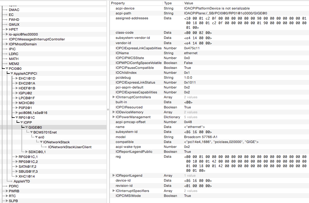

ErmaC 1,831 Posted May 18, 2015 Author Share Posted May 18, 2015 Lower case typo for DSDT autopatch. FixBiosDsdt.c at line 2852 aml_add_string_buffer(pack, "Ethernet");I think need to be in lower case aml_add_string_buffer(pack, "ethernet");ErmaC Link to post Share on other sites
Slice 6,936 Posted May 18, 2015 Share Posted May 18, 2015 Lower case typo for DSDT autopatch. FixBiosDsdt.c at line 2852 aml_add_string_buffer(pack, "Ethernet");I think need to be in lower case aml_add_string_buffer(pack, "ethernet");ErmaC There are different names. device_type = "Ethernet" name = "ethernet" But I see somehow strange that we write name = "pci1431,0013" for example. The difference may occurred from different OSX version or just Apple do this differently on different Macs. Link to post Share on other sites
ErmaC 1,831 Posted May 18, 2015 Author Share Posted May 18, 2015 There are different names. device_type = "Ethernet" name = "ethernet" But I see somehow strange that we write name = "pci1431,0013" for example. The difference may occurred from different OSX version or just Apple do this differently on different Macs. Yep I'm refear to name = ethernet From a real Mac (MacMini) I see only this... I'm unable to find the upper-case case (Ethernet) with this original configuration... ErmaC Link to post Share on other sites

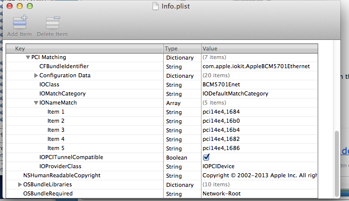

Slice 6,936 Posted May 19, 2015 Share Posted May 19, 2015 See /System/Library/Extensions/IONetworkingFamily.kext/Contents/PlugIns/AppleBCM5701Ethernet.kext/Contents/Info.plist For the kext to load its name must be "pci14e4,1684" but not 'ethernet" as Apple did. There is a question. How can Apple did this? I see other way for kext matching. MacPro5,1 Link to post Share on other sites
ErmaC 1,831 Posted June 2, 2015 Author Share Posted June 2, 2015 There are different names. device_type = "Ethernet" name = "ethernet" But I see somehow strange that we write name = "pci1431,0013" for example. The difference may occurred from different OSX version or just Apple do this differently on different Macs. Thx Slice. So... on the other hand the typo is here... device_inject.c line: 383 devprop_add_value(device, "device_type", (UINT8*)"ethernet", 9); ErmaC Link to post Share on other sites
Slice 6,936 Posted June 3, 2015 Share Posted June 3, 2015 Agree, corrected. Link to post Share on other sites
