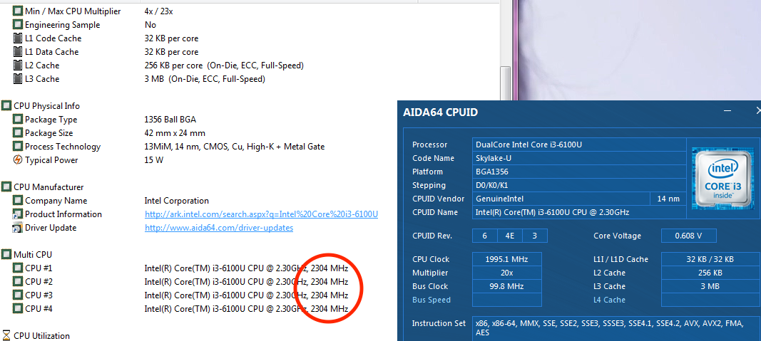

Sherlocks Posted July 8, 2017 Share Posted July 8, 2017 Here you go. hw.busfrequency: 96000000 your cpu tsc calculation is not correct. Finally: ExternalClock=24MHz Bus=99773kHz CPU=2395MHz 24*4=96,000,000 try busspeedfrequency 100,000khz source is no problem now. some device's calculation is not correct. read instruction from clover wiki. ofc clover can use correct value from getcpuproperties. but i dont know why slice makes code that use tsc calibrate after getcpuproperties. https://clover-wiki.zetam.org/Configuration/CPU DMI stores this value in MHz, which is not accurate in contrast to a value calculated from CPU frequency. You can choose a more accurate value, if needed. For example my DMI has a value of 100 MHz, however manually overriding it to a value of 99790 kHz produced better clocks. Link to comment https://www.insanelymac.com/forum/topic/306156-clover-problems-and-solutions/page/91/#findComment-2458880 Share on other sites More sharing options...
Riley Freeman Posted July 8, 2017 Share Posted July 8, 2017 Setting busspeed in config.plist fixed the sysctl output. Link to comment https://www.insanelymac.com/forum/topic/306156-clover-problems-and-solutions/page/91/#findComment-2458888 Share on other sites More sharing options...
Sherlocks Posted July 8, 2017 Share Posted July 8, 2017 Setting busspeed in config.plist fixed the sysctl output. yes. this is standard(clover wiki) of clover since clover start. my laptop also needs to add 100,000 to match correctly it. Finally: ExternalClock=25MHz Bus=100203kHz CPU=2305MHz Link to comment https://www.insanelymac.com/forum/topic/306156-clover-problems-and-solutions/page/91/#findComment-2458892 Share on other sites More sharing options...

Slice Posted July 8, 2017 Share Posted July 8, 2017 hw.busfrequency: 96000000 your cpu tsc calculation is not correct. Finally: ExternalClock=24MHz Bus=99773kHz CPU=2395MHz 24*4=96,000,000 try busspeedfrequency 100,000khz source is no problem now. some device's calculation is not correct. read instruction from clover wiki. ofc clover can use correct value from getcpuproperties. but i dont know why slice makes code that use tsc calibrate after getcpuproperties. https://clover-wiki.zetam.org/Configuration/CPU DMI stores this value in MHz, which is not accurate in contrast to a value calculated from CPU frequency. You can choose a more accurate value, if needed. For example my DMI has a value of 100 MHz, however manually overriding it to a value of 99790 kHz produced better clocks. It may be a difference between Core2Duo and modern i5. For Core2Duo I am sure in value 99790 becuase I was observed system timer. It run or lost depending on this value. Not on value from Smbios table. On value from DataHub "FSBFrequency". 100000 was wrong for me. Sure! 1 Link to comment https://www.insanelymac.com/forum/topic/306156-clover-problems-and-solutions/page/91/#findComment-2458997 Share on other sites More sharing options...
Sherlocks Posted July 8, 2017 Share Posted July 8, 2017 It may be a difference between Core2Duo and modern i5. For Core2Duo I am sure in value 99790 becuase I was observed system timer. It run or lost depending on this value. Not on value from Smbios table. On value from DataHub "FSBFrequency". 100000 was wrong for me. Sure! right. thank you for reply. i see aida64 engineer's report. maybe i think tsc calibrate is correct. bus speeds are slightly different. also shown this http://cpuboss.com/cpus/Intel-Core-i5-6200U-vs-Intel-Core-i3-6100U Overclocking Overclocked clock speed 2.8 GHz 2.31 GHz clover log 1st boot Finally: ExternalClock=25MHz BusSpeed=100274kHz CPU=2306MHz PIS: hw.busfrequency=100000000Hz 2nd boot Finally: ExternalClock=25MHz BusSpeed=100235kHz CPU=2305MHz PIS: hw.busfrequency=100000000Hz 3rd boot Finally: ExternalClock=25MHz BusSpeed=100193kHz CPU=2304MHz PIS: hw.busfrequency=100000000Hz I can not be sure, but it looks good. 1 Link to comment https://www.insanelymac.com/forum/topic/306156-clover-problems-and-solutions/page/91/#findComment-2459011 Share on other sites More sharing options...
