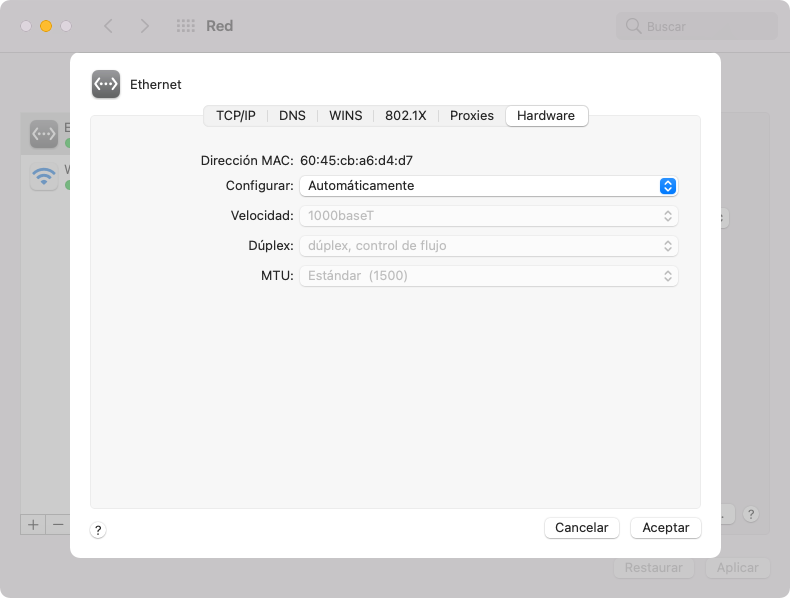

WeBeRiO Posted June 21, 2021 Share Posted June 21, 2021 Grabación de pantalla 2021-06-21 a las 18.23.53.mov In Monterey no work correcty i219-V, only 100mb/s Link to comment https://www.insanelymac.com/forum/topic/304235-intelmausiethernetkext-for-intel-onboard-lan/page/40/#findComment-2761377 Share on other sites More sharing options...

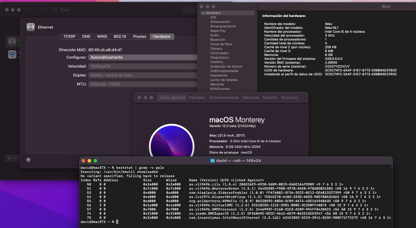

Slice Posted June 25, 2021 Share Posted June 25, 2021 On 6/21/2021 at 7:43 PM, WeBeRiO said: Grabación de pantalla 2021-06-21 a las 18.23.53.mov 6.92 MB · 0 downloads InMonterey no work correcty i219-V, only 100mb/s No, all is good % sudo kextstat | grep -v pple Password: Executing: /usr/bin/kmutil showloaded No variant specified, falling back to release Index Refs Address Size Wired Name (Version) UUID <Linked Against> 19 3 0 0x18000 0x18000 org.netkas.FakeSMC (3.5.3) 503675DF-E091-38F2-AE0C-5A1F93D84E15 <15 9 7 6 3> 20 0 0 0x10000 0x10000 org.slice.RadeonMonitor (1.3.5) 09B20CAE-4A50-34F9-BA72-5996FB7F2386 <19 16 9 6 3> 52 0 0 0x11000 0x11000 org.slice.IntelCPUMonitor (1.2.5) 5601DBF8-2C70-364B-9359-816108A00582 <19 9 7 6 3> 53 0 0 0x11000 0x11000 org.mozodojo.ITEIT87x (1.0.7) C1AEA9CC-79B7-32A6-AF30-CF9F2F5ADA2E <19 9 7 6 3> 74 0 0 0x2e000 0x2e000 com.insanelymac.IntelMausiEthernet (2.5.1d1) 624E285C-5E23-3941-B23C-980E71F7227E <50 16 7 6 3 1> 118 0 0xffffff7f9a2eb000 0x25000 0x25000 org.voodoo.driver.VoodooHDA (2.9.7) 224E762A-1DFE-3C36-988D-9D7371A39434 <110 16 9 7 6 3> 121 0 0xffffff7f9a20e000 0x2000 0x2000 com.intel.driver.EnergyDriver (3.7.0) 35E739F9-BF6C-3024-A67C-750711B3FB64 <9 7 6 3> 1 Link to comment https://www.insanelymac.com/forum/topic/304235-intelmausiethernetkext-for-intel-onboard-lan/page/40/#findComment-2761555 Share on other sites More sharing options...

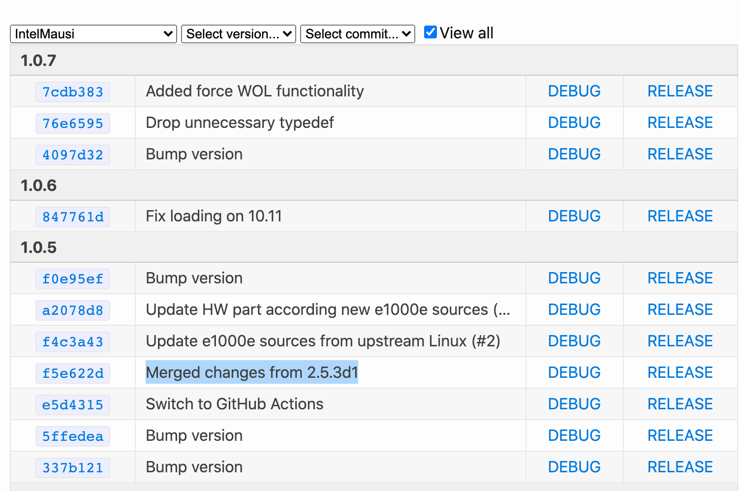

WeBeRiO Posted June 25, 2021 Share Posted June 25, 2021 (edited) 14 hours ago, Slice said: This is the kext I used IntelMausiEthernet.kext.zip 58.81 kB · 0 downloads Why this and not https://github.com/acidanthera/IntelMausi ?? Not understand nothing, I'm very confused ... Edited June 25, 2021 by WeBeRiO Link to comment https://www.insanelymac.com/forum/topic/304235-intelmausiethernetkext-for-intel-onboard-lan/page/40/#findComment-2761583 Share on other sites More sharing options...
Slice Posted June 25, 2021 Share Posted June 25, 2021 The kext from acidanthera is a copy of original with debugging ability (so why 100baseT?). See their Readme Quote Do use the original version when uncertain. No support or troubleshooting provided. Link to comment https://www.insanelymac.com/forum/topic/304235-intelmausiethernetkext-for-intel-onboard-lan/page/40/#findComment-2761587 Share on other sites More sharing options...

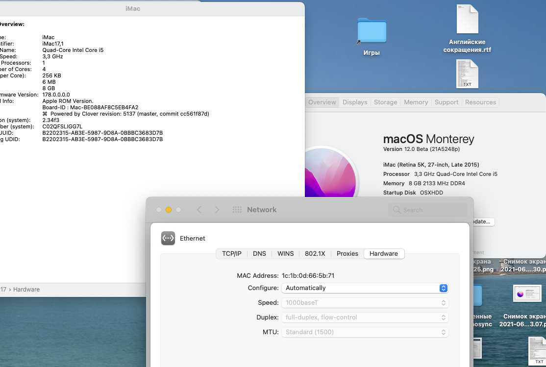

Slice Posted June 26, 2021 Share Posted June 26, 2021 3 hours ago, WeBeRiO said: Same error with your kext May be your router doesn't allow to use 1000? I don't know. There is also an observation that I used Clover while you used OC. FakeSMC vs VirtualSMC. 1 Link to comment https://www.insanelymac.com/forum/topic/304235-intelmausiethernetkext-for-intel-onboard-lan/page/40/#findComment-2761596 Share on other sites More sharing options...
WeBeRiO Posted June 28, 2021 Share Posted June 28, 2021 (edited) Fix it, bad cable... Edited June 28, 2021 by WeBeRiO Link to comment https://www.insanelymac.com/forum/topic/304235-intelmausiethernetkext-for-intel-onboard-lan/page/40/#findComment-2761744 Share on other sites More sharing options...

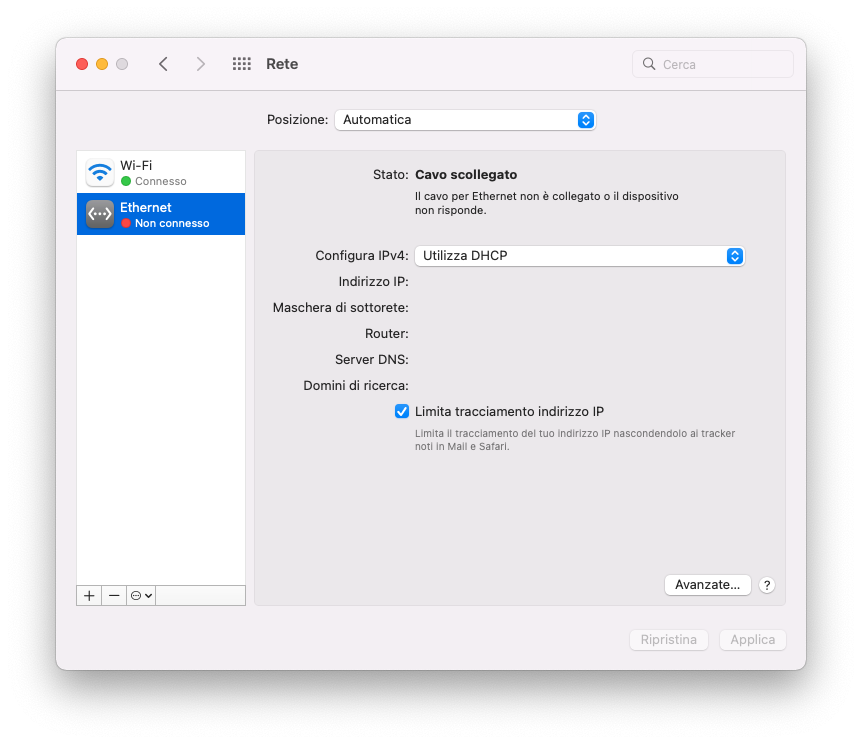

giacomoleopardo Posted February 7, 2022 Share Posted February 7, 2022 (edited) Does anybody have issue with Intel 219V on Z690 boards? System Preference/Network says "Cable disconnected" Asus Z690M-Plus D4 Intel 219V nic OC 0.7.7 Monterey 12.2 IntelMausiEthernet-V2.5.d3 Edited February 7, 2022 by giacomoleopardo Link to comment https://www.insanelymac.com/forum/topic/304235-intelmausiethernetkext-for-intel-onboard-lan/page/40/#findComment-2776413 Share on other sites More sharing options...
Mieze Posted February 8, 2022 Author Share Posted February 8, 2022 @giacomoleopardo The driver needs an update to support Alder Lake chipsets. I'll try to take care of the problem during the next days. Mieze 😺 4 1 Link to comment https://www.insanelymac.com/forum/topic/304235-intelmausiethernetkext-for-intel-onboard-lan/page/40/#findComment-2776511 Share on other sites More sharing options...
