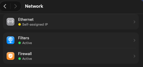

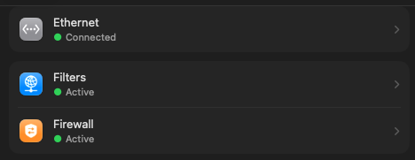

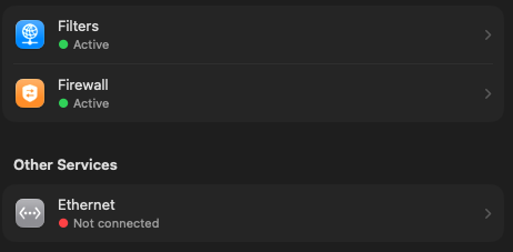

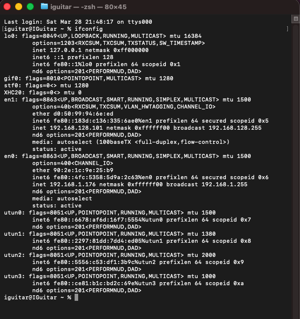

deeveedee Posted March 28 Share Posted March 28 (edited) Since macOS 26.2, I have not observed any issues when using IntelMausiEthernet.kext 3.0.3 with VT-d enabled in BIOS and Kernel > Quirks > DisableIoMapper = False. After upgrading to Tahoe 26.4 Release (25E246), I am finding that Ethernet may not be connected when I boot macOS. I can fix the Ethernet connection by either disconnecting/reconnecting the Ethernet cable or disabling/enabling Ethernet (ifconfig en0 down; ifconfig en0 up). It appears that I can also fix this problem by setting Kernel > Quirks > DisableIoMapper = True, but I'm still testing to confirm that this is consistent. I'm still testing, since other things that I did at the time of the macOS upgrade included Upgrade Open Core from 1.0.6 -> 1.0.7 Upgrade AppleALC.kext 1.9.6 -> 1.9.7 (don't see why this would matter) Has anyone else observed this change in behavior of IntelMausiEthernet.kext 3.0.3 after upgrading to Tahoe 26.4 Release? Edited March 28 by deeveedee 3 Link to comment https://www.insanelymac.com/forum/topic/304235-intelmausiethernetkext-for-intel-onboard-lan/page/42/#findComment-2848527 Share on other sites More sharing options...
Mieze Posted March 28 Author Share Posted March 28 @deeveedee After booting with 26.4 and IntelMausiEthernet.kext please check in Terminal using ifconfig: Is the link up? Has the interface received an IPv4 address via DHCP? Hast the interface received an IPv6 Address? 1 1 Link to comment https://www.insanelymac.com/forum/topic/304235-intelmausiethernetkext-for-intel-onboard-lan/page/42/#findComment-2848528 Share on other sites More sharing options...

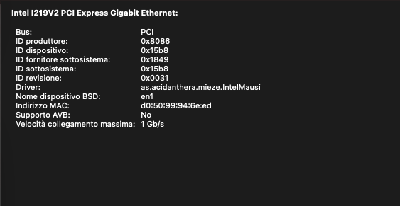

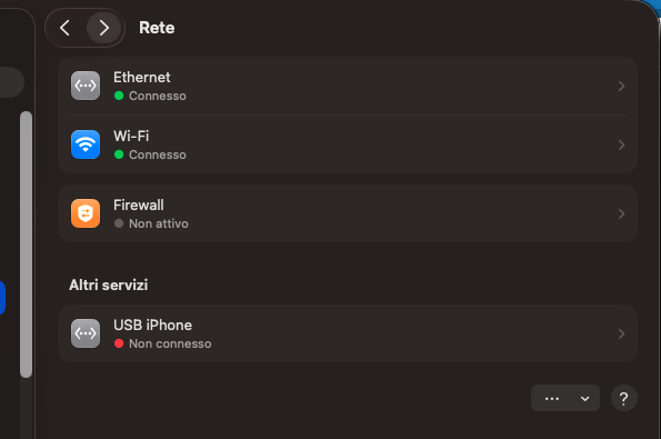

carlo_67 Posted March 28 Share Posted March 28 if it can be helpful here no problem, thanks👍 Link to comment https://www.insanelymac.com/forum/topic/304235-intelmausiethernetkext-for-intel-onboard-lan/page/42/#findComment-2848529 Share on other sites More sharing options...
deeveedee Posted March 28 Share Posted March 28 (edited) @Mieze Thank you for the quick reply! I am ok with setting Kernel > Quirks > DisableIoMapper = True and am only providing this information in case it helps you or anyone else. I performed 10 boot tests with results below. 5 tests with Kernel > Quirks > DisableIoMapper = True and 5 tests with Kernel > Quirks > DisableIoMapper = False. My test configuration is as follows: BIOS: VT-d enabled EFI: Open Core 1.0.7 Original System DMAR Table is not modified IntelMausiEthernet.kext 3.0.3 Test results are as follows: With Kernel > Quirks > DisableIoMapper = True For each of the 5 boots, Ethernet is always connected with assigned IPv4 after boot and with full access to internet With Kernel > Quirks > DisableIoMapper = False For 1 of the 5 boots, Ethernet is connected with IPv4 IP assigned after boot - full access to internet. Spoiler For 2 of the 5 boots, Ethernet IPv4 is "self-assigned" - no access to internet. Toggling Ethernet with attached script fixes internet connection. Spoiler For 2 of the 5 boots, Ethernet is not connected with no IPv4 assigned - no access to internet. Toggling Ethernet with attached script fixes internet connection. Spoiler EDIT: I am not using IPv6. toggleEth.zip Edited March 28 by deeveedee 2 Link to comment https://www.insanelymac.com/forum/topic/304235-intelmausiethernetkext-for-intel-onboard-lan/page/42/#findComment-2848530 Share on other sites More sharing options...
Mieze Posted March 28 Author Share Posted March 28 @deeveedee Please check in Terminal because the network preferences panel often shows a not connected sign when the interface has no IP address, although the link is up. Link to comment https://www.insanelymac.com/forum/topic/304235-intelmausiethernetkext-for-intel-onboard-lan/page/42/#findComment-2848532 Share on other sites More sharing options...
