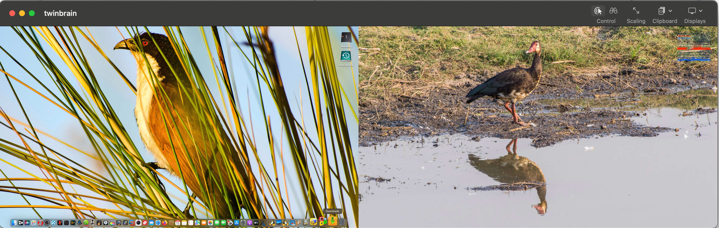

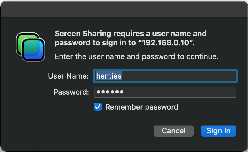

Henties Posted August 13, 2022 Share Posted August 13, 2022 @Mieze Thanks for joining, and I hear what your sentiments are concerning proper bios settings and ACPI data structures, and I agree entirely. In my case however I have a situation where an add on NIC - DGE-560T - works exceptionally well WOL wise, in an identical bios and ACPI data environment in which any version of the IntelMausi.kext which I can lay my hands on, just does not, you figure ? From my vantage point I believe it to be a kext problem and would not want to change anything in any of my systems to make, what I believe a flawed driver, work in my environment the way it should. My sentiments are reinforced by the age old adage "if it ain't broken don't fix it" In my 10 machine environment, comprising any macOS from Big Sur, Monterey as well as Ventura, in multi-boot OC 0.8.3 configurations, WOL/VNC work exceptionally well from anywhere to anywhere. The attached pictures are examples of a machine that was woken with a standard WOL packet followed by a proper VNC construct and voila 12 seconds after issuing the WOL/VNC construct, the login screen appears. That is what I wish the IntelMausi.kext would also be able to do. Incidentally in Windows 10 environments the onboard Intel i219-V onboard NIC works quite well with WOL/VNC, obviously using the windows driver with the same bios setting that macOS is operating under. 14 hours ago, jpz4085 said: I assume WOL from sleep has never worked with the i219-V on your Gigabyte GA-Z170X-UD3. Is that correct? Yes that is correct, however it also applies to another, Haswell based macOS, hack using an Intel i217-V onboard NIC instead. The cure in this case once again was using an add-on DGE-560T NIC. On this particular machine I am however not short of spare PCIe slots. Incidentally in this case Windows is using the same "personality" that it is using for the i219-V NIC on the Skylake mobo. "If so are you using any ACPI patches that would power down the network controller during sleep to prevent instant wake issues?" No not at all. On non of my machines, in my particular environment, did I need to action anything to prevent this phenomena, because I have not experienced that yet. "You could test whether the kext is even able to set the power mode and Magic Packet filter required for WOL by temporarily enabling wake from S5. That would at least tell us it's really sleep specific." Done that, but it makes no difference, and this "setting" is also not available in most of the iterations of this kext floating around. Greetings Henties. Link to comment Share on other sites More sharing options...

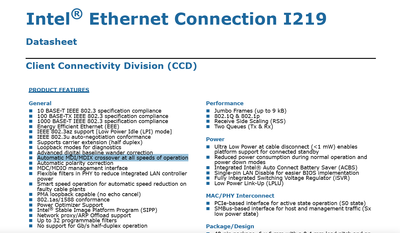

Consistency Posted January 31, 2023 Share Posted January 31, 2023 Just to confirm. There's no support for "Automatic MDI/MDIX crossover at all speeds of operation" in this I219V driver? Therefore a crossover cable is required if I'd like to share the internet connection from a hackintosh? Link to comment Share on other sites More sharing options...

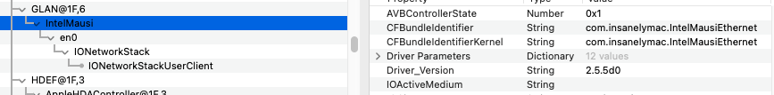

Henry2010 Posted August 3, 2023 Share Posted August 3, 2023 (edited) Is it possibly a bug? I cannot change Duplex in Sonoma 23A5301H using version 2.5.4. It's locked to full-duplex only. In System Info "There was an error while gathering Ethernet device information." 😊 EDIT Using the same kext, Clover version and config.plist, everything works as expected in Monterey. (The NIC is I219-V.) Edited August 5, 2023 by Henry2010 1 Link to comment Share on other sites More sharing options...
