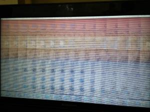

notten Posted February 25, 2015 Share Posted February 25, 2015 Ok. First of all its "config.plist". Now should not copy it to the bottom of the file. Look for "KextsToPatch" under "KernelAndKextPatches" in your plist file and edit there. For ex. here's what i did: I did it like this as well, but I don't think it took. Either the patches or the kexts aren't taking. How do I verify that the graphics Kexts are working? "kextstat | grep FakePCIIID" shows org.rehabman.driver.FakePCIIID is loaded. However, graphics still seem glitchy to me. Link to comment https://www.insanelymac.com/forum/topic/303276-guide-for-installing-os-x-on-lenovo-ideapad-y510p/page/6/#findComment-2115146 Share on other sites More sharing options...
ahmed_ais Posted February 26, 2015 Author Share Posted February 26, 2015 I did it like this as well, but I don't think it took. Either the patches or the kexts aren't taking. How do I verify that the graphics Kexts are working? "kextstat | grep FakePCIIID" shows org.rehabman.driver.FakePCIIID is loaded. However, graphics still seem glitchy to me. I haven't been following up your issue since intruder16 was replying to you. Can you summarize your problem? If you have a problem with graphics then make sure you are following the procedure in the guide correctly. Two kexts are needed as stated in the guide: FakePCIID.kext and FakePCIID_HD4600_HD4400.kext. Also couple of settings will have to be changed in config.plist: <key>Devices</key> <dict> <key>FakeID</key> <dict> <key>IntelGFX</key> <string>0x04128086</string> ... <key>Graphics</key> <dict> <key>Inject</key> <dict> <key>Intel</key> <true/> </dict> <key>ig-platform-id</key> <string>0x0a260006</string> ... If you do these and used a suitable smbios (like macbookpro 11.1 or iMac14.2) you should have a working graphics. If you have a working graphics but with (small, tiny) glitches then try adding the 9MB cursor framebuffer patch which is included in the guide: <dict> <key>Comment</key> <string>0x0a260006 9MB cursor bytes patch</string> <key>Find</key> <string>0600260a01030303000000020000300100006000</string> <key>Name</key> <string>AppleIntelFramebufferAzul</string> <key>Replace</key> <string>0600260a01030303000000020000300100009000</string> </dict> Note: the 9MB cursor framebuffer patch should be put using a plist editor and not with Clover Configurator. If you use Clover Configurator to make any edits to the config.plist you have to know that the app will not recognize that specific patch format and will remove it upon saving so you will have to put it manually after finishing with Clover Configurator. Link to comment https://www.insanelymac.com/forum/topic/303276-guide-for-installing-os-x-on-lenovo-ideapad-y510p/page/6/#findComment-2115267 Share on other sites More sharing options...
notten Posted February 26, 2015 Share Posted February 26, 2015 Note: the 9MB cursor framebuffer patch should be put using a plist editor and not with Clover Configurator. If you use Clover Configurator to make any edits to the config.plist you have to know that the app will not recognize that specific patch format and will remove it upon saving so you will have to put it manually after finishing with Clover Configurator. I'm going to guess that this is my problem. Going to re-do this step now. Checking it out and will reply. However, the symptoms are the following: I installed the kexts you mentioned, applied the config.plist patches you mentioned (at first, incorrectly, but I fixed that thanks to intruder), I used the DPCIMwhatever program to fix perms and rebuild kext cache, restarted and I still get 7MB in About This Mac and glitchy graphics. Should I still see 7MB video RAM? Also, my title bars are glitched and my login screen flickers when loading and when exiting. I don't think I have accelerated graphics yet. EDIT: Re-did the above step. It didn't fix my problem. EDIT2: I think it has something to do with loading the right kexts. Link to comment https://www.insanelymac.com/forum/topic/303276-guide-for-installing-os-x-on-lenovo-ideapad-y510p/page/6/#findComment-2115312 Share on other sites More sharing options...
ahmed_ais Posted February 26, 2015 Author Share Posted February 26, 2015 I'm going to guess that this is my problem. Going to re-do this step now. Checking it out and will reply. However, the symptoms are the following: I installed the kexts you mentioned, applied the config.plist patches you mentioned (at first, incorrectly, but I fixed that thanks to intruder), I used the DPCIMwhatever program to fix perms and rebuild kext cache, restarted and I still get 7MB in About This Mac and glitchy graphics. Should I still see 7MB video RAM? Also, my title bars are glitched and my login screen flickers when loading and when exiting. I don't think I have accelerated graphics yet. EDIT: Re-did the above step. It didn't fix my problem. EDIT2: I think it has something to do with loading the right kexts. If you recall what I said then your problem is not having the (small, tiny) glitch I was talking about. You don't have a properly fixed graphics at all. .... If you do these and used a suitable smbios (like macbookpro 11.1 or iMac14.2) you should have a working graphics. If you have a working graphics but with (small, tiny) glitches then try adding the 9MB cursor framebuffer patch ... Zip your EFI folder and link it here. Also tell me have you played with the kexts in /S/L/E or what did you do before using the 2 kexts I mentioned earlier? Link to comment https://www.insanelymac.com/forum/topic/303276-guide-for-installing-os-x-on-lenovo-ideapad-y510p/page/6/#findComment-2115363 Share on other sites More sharing options...

intruder16 Posted February 26, 2015 Share Posted February 26, 2015 ........ I used the DPCIMwhatever program ........... Now onto topic. Answer these questions first: 1. Which Mac version are you using? 10.10, 10.10.2, 10.10.3? 2. Did you see any of these kexts in either System/Library/Extensions or Clover/Kexts/ : FakePCIID.kext, FakePCIID_HD4600_HD4400.kext 3. Attach you config.plist and post here. Link to comment https://www.insanelymac.com/forum/topic/303276-guide-for-installing-os-x-on-lenovo-ideapad-y510p/page/6/#findComment-2115372 Share on other sites More sharing options...

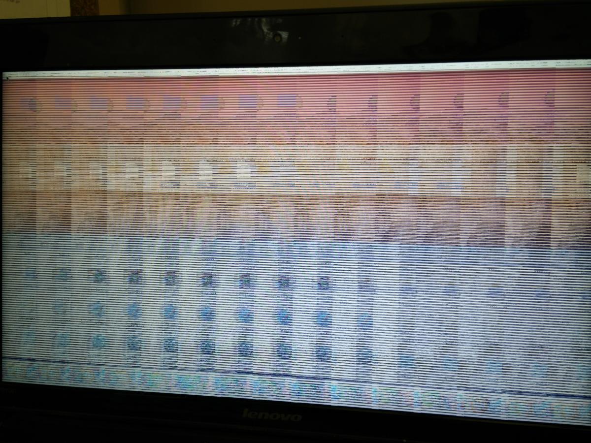

ahmed_ais Posted February 26, 2015 Author Share Posted February 26, 2015 Edit 2: Regarding Hot Plug: There is no problem hot plugging/unplugging HDMI cable (IF) OS X booted with HDMI cable plugged in. Otherwise, once we plug HDMI cable while OS X booted without it the built-in display (only) will turn into this: This is an issue that we need to fix. A workaround if it happened to use the external display to change the built-in display resolution to anything then back to 1920x1080 again. Link to comment https://www.insanelymac.com/forum/topic/303276-guide-for-installing-os-x-on-lenovo-ideapad-y510p/page/6/#findComment-2115445 Share on other sites More sharing options...

intruder16 Posted February 26, 2015 Share Posted February 26, 2015 Sorry brother i can't help you with HDMI. Have nothing to test it with. This is an issue that we need to fix. A workaround if it happened to use the external display to change the built-in display resolution to anything then back to 1920x1080 again. So i guess its better to set up a hotkey to change resolutions then. Link to comment https://www.insanelymac.com/forum/topic/303276-guide-for-installing-os-x-on-lenovo-ideapad-y510p/page/6/#findComment-2115450 Share on other sites More sharing options...

notten Posted February 26, 2015 Share Posted February 26, 2015 Ok i've attached my config.plist try this and report. And also download Patched DSDT and SSDTs from Downloads section on the first page, unzip it and copy the resulting *.aml files to Clover/ACPI/patched folder EDIT: I tried with your config.plist and the *.aml files from the DSDT/SSDT download. Still corrupted graphics. Would you please send me a ZIP with your AppleIntelFramebufferAzul.kext and AppleIntelHD5000.kext or so? I would be grateful Can you ZIP up your copy of AppleIntelFramebufferAzul.kext from /S/L/E also? I have a badly patched one I downloaded from the net. Link to comment https://www.insanelymac.com/forum/topic/303276-guide-for-installing-os-x-on-lenovo-ideapad-y510p/page/6/#findComment-2115459 Share on other sites More sharing options...
intruder16 Posted February 26, 2015 Share Posted February 26, 2015 Can you ZIP up your copy of AppleIntelFramebufferAzul.kext from /S/L/E also? I have a badly patched one I downloaded from the net. Sure. And everything is in the Downloads section of this guide. Ahmed did a very good job with the guide. Attached is the file you need. Also make sure to change the SMBIOS to iMac 14,2 from Clover Configurator. AppleIntelFramebufferAzul.kext.zip Link to comment https://www.insanelymac.com/forum/topic/303276-guide-for-installing-os-x-on-lenovo-ideapad-y510p/page/6/#findComment-2115461 Share on other sites More sharing options...
ahmed_ais Posted February 26, 2015 Author Share Posted February 26, 2015 Oh no. You misunderstood. That was for everyone. Not only for you. I know you were reading a lot also trying to fix this. No my friend I didn't misunderstand you. I know this was your intention but I meant I could write the description my self and thought it is better you do so because it is your work. I am happy with your collaportation to get this hackintosh better and better and would want this to continue ... So dont go far we still have the biggest issue to fix! Link to comment https://www.insanelymac.com/forum/topic/303276-guide-for-installing-os-x-on-lenovo-ideapad-y510p/page/6/#findComment-2115464 Share on other sites More sharing options...
notten Posted February 26, 2015 Share Posted February 26, 2015 Sure. And everything is in the Downloads section of this guide. Ahmed did a very good job with the guide. Attached is the file you need. Also make sure to change the SMBIOS to iMac 14,2 from Clover Configurator. Even with this kext, still get the glitched graphics. Idk wtf is going on. Link to comment https://www.insanelymac.com/forum/topic/303276-guide-for-installing-os-x-on-lenovo-ideapad-y510p/page/6/#findComment-2115465 Share on other sites More sharing options...
