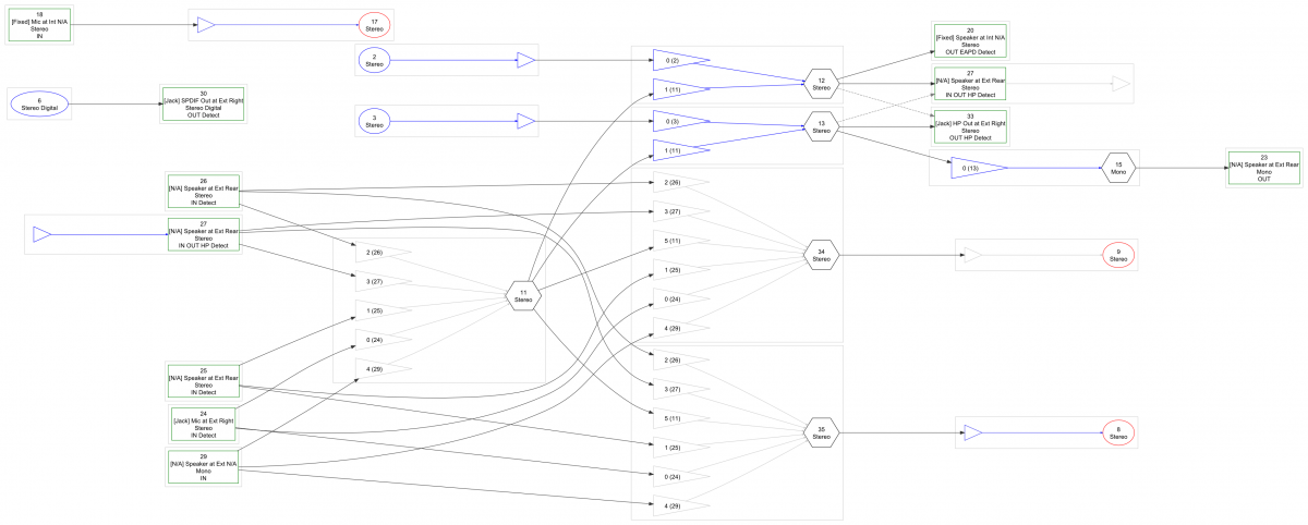

ahmed_ais Posted February 24, 2015 Author Share Posted February 24, 2015 Thats what i got. Wait i'll try. Regarding AppleHDA external mic issue, I just got a reply from Mirone which is disappointing. He said that the problem is how our hardware is configured where the mic and headphones jacks are not separated (what is known as comboJack) and this configuration is troublesome to fix for AppleHDA and there is no solution for this so far. That's not so bad considering VoodooHDA does not enable the external mic either so at least we can have nice sound using AppleHDA instead of VoodooHDA even with one feature not working. Anyone got sleep working? I don't know what your problem is, sleep IS working fine on our laptop if you followed the steps in the guide. I remember I told you (maybe some one else?) that if the system sleep but reboot immediately then it is a wake problem and should filter system log (using console) for "Wake Reason" so we know what to fix. Link to comment https://www.insanelymac.com/forum/topic/303276-guide-for-installing-os-x-on-lenovo-ideapad-y510p/page/5/#findComment-2114468 Share on other sites More sharing options...
intruder16 Posted February 24, 2015 Share Posted February 24, 2015 Regarding AppleHDA external mic issue, I just got a reply from Mirone which is disappointing. He said that the problem is how our hardware is configured where the mic and headphones jacks are not separated (what is known as comboJack) and this configuration is troublesome to fix for AppleHDA and there is no solution for this so far. That's not so bad considering VoodooHDA does not enable the external mic either so at least we can have nice sound using AppleHDA instead of VoodooHDA even with one feature not working. That's sad news. I patched my AppleHDA but i did something wrong while patching it and now my internal mic is not working. I'll try again. BTW if u can, what is your pathway for internal mic? I got these and i'm confused: Internal Mic (0x12): 18-> 17 (0x12->0x11) 25->35->8 (0x19->0x23->0x08) I will try it with the graphical method (didnt try that guide so far) I don't know what your problem is, sleep IS working fine on our laptop if you followed the steps in the guide. I remember I told you (maybe some one else?) that if the system sleep but reboot immediately then it is a wake problem and should filter system log (using console) for "Wake Reason" so we know what to fix. I patched my DSDT again from scratch. And now sleep is working fine. With audio not working afterwards. But its easy to fix. Link to comment https://www.insanelymac.com/forum/topic/303276-guide-for-installing-os-x-on-lenovo-ideapad-y510p/page/5/#findComment-2114508 Share on other sites More sharing options...
ahmed_ais Posted February 24, 2015 Author Share Posted February 24, 2015 That's sad news. I would like to add something. I think Mirone was not correct regarding our laptop having Audio Combo Jack (combo jacks are not supported by Apple) because I think it does not. I googled and found the combo jack is a single jack that allow a single connector to feed both external mic and headphone like this one: Lenovo Y50 have this combo jack as you can see in this picture: But our Y510p have two separated jacks so it is not a combo jack: This, if true, will give us a chance to try to get AppleHDA working with external mic fixed. I patched my AppleHDA but i did something wrong while patching it and now my internal mic is not working. I'll try again. BTW if u can, what is your pathway for internal mic? I got these and i'm confused: Internal Mic (0x12): 18-> 17 (0x12->0x11) 25->35->8 (0x19->0x23->0x08) I will try it with the graphical method (didnt try that guide so far) The path should be coded in reverse order for mic so the path for the internal mic should be coded 17 -> 18 (which is implemented in the kext) and the path for external mic is (according to my map) is 8->35->24. On my map 24 refers to [Jack] Mic at Ext Right and 25 refers to [N/A] Speaker at Ext Rear. Link to comment https://www.insanelymac.com/forum/topic/303276-guide-for-installing-os-x-on-lenovo-ideapad-y510p/page/5/#findComment-2114600 Share on other sites More sharing options...
intruder16 Posted February 24, 2015 Share Posted February 24, 2015 I would like to add something. ..... Thats what i thought at first. Combo jack is different and its not implemented in our laptops. The path should be coded in reverse order for mic so the path for the internal mic should be coded 17 -> 18 (which is implemented in the kext) and the path for external mic is (according to my map) is 8->35->24. On my map 24 refers to [Jack] Mic at Ext Right and 25 refers to [N/A] Speaker at Ext Rear. Ok. The internal mic is configured ok. So here's what i have on external mic: Generic pathway: Audio Input -> Audio Mixer -> Pin Complex For External Mic: 0x08 -> 0x23 -> 0x18 0x19 0x1a 0x1b 0x1d 0x0b 0x09 -> 0x22 -> 0x18 0x19 0x1a 0x1b 0x1d 0x0b where, 0x18 -> [Jack] Mic at Ext Right 0x19 -> [N/A] Speaker at Ext Rear So the path for External Mic becomes: 0x08 -> 0x23 -> 0x18 | (8 -> 35 -> 24) 0x09 -> 0x22 -> 0x18 | (9 -> 34 -> 24) I'm going to try both of them next time. Frankly, i'm quite confused with editing layout.xml & platform.xml. But i'll get it done. And btw i'm too having problem with Graphics after sleep. Any solution yet? Link to comment https://www.insanelymac.com/forum/topic/303276-guide-for-installing-os-x-on-lenovo-ideapad-y510p/page/5/#findComment-2114663 Share on other sites More sharing options...
ahmed_ais Posted February 24, 2015 Author Share Posted February 24, 2015 And btw i'm too having problem with Graphics after sleep. Any solution yet? Well, the problem is not related to sleep. Putting the system to sleep then awake is just one way to replicate a more general problem. The problem happens whenever the display is turned OFF then ON and this can be replicated by different scenarios: System sleep: it turns display off in the process then on wake it turns display on Screen Saver: on switch on it turns display off then on to activate SS Selecting display sleep to any corner from screen saver dialog Changing screen resolution: Display turns off then on as part of the process There may be other scenarios to replicate the problem. But it is related to graphics mainly, and no solution I know of yet! Link to comment https://www.insanelymac.com/forum/topic/303276-guide-for-installing-os-x-on-lenovo-ideapad-y510p/page/5/#findComment-2114675 Share on other sites More sharing options...
intruder16 Posted February 25, 2015 Share Posted February 25, 2015 Hi guys, any one interested helping in trying to get AppleHDA working instead of VoodooHDA? I started to dig in but would appreciate some cooperation !! Update: GOT IT WORKING! now testing it Update2: After testing .... Audio output: Internal Speaker (built in): Works External Speaker (headphone): Works (with auto switching of course) Audio input: Internal Microphone (built in): Works External Microphone: Not Working I think I will need to patch the AppleHDA kext from scratch to fix external microphone issue ... Ok. So after 4 days of hard work i finally fixed it. Internal/External Mic is now working perfectly with AppleHDA. Audio output: Internal Speaker (built in): Works External Speaker (Headphone): Works (with auto switching) Audio input: Internal Microphone (built in): Works (with ambient noise reduction) External Microphone: Works (with auto switching) Attached are the two files: AppleHDA.kext & EAPDFix.kext EAPDFix.kext : to prevent sound "not working" after sleep. Note: If you are using VoodooHDA, uninstall it first. It wont work with VoodooHDA. Just one thing to do after installing the kexts: Goto Clover Configurator -> Devices -> Audio (Inject) -> 3 You're all done. Enjoy crisp sound of apple drivers. AppleHDA >>>>> VoodooHDA (Much better). Try it yourself if you don't believe me. If you want more power install "Boom 2". Now onto HDMI: I am trying to patch HDMI audio too. But i cannot test it. If anybody's interested in testing please let me know. I'll hard to get it working. ELAN Touchpad Fix: Also, if anybody's using ELAN touchpad driver. It breaks the brightness key shortcut (Fn+Vol up/down) functionality. Good news is, I've fixed it too. It requires a DSDT patch to work properly afterwards. Also working: Fn+F1 -> Sleep Fn+F6 -> Touchpad On/Off Fn+F9 -> Media Play/Pause If your Touchpad is ELAN i'll highly recommend this driver http://forum.osxlatitude.com/index.php?/topic/1948-elan-and-focaltech-smart-touchpad-driver-mac-os-x/. Its even better than windows driver (much better). Let me know guys if you want this fix. Keep hackintoshing! And please guys leave some feedback on what's working and what's not. Its not easy to find bugs. If you encounter any please post it here. PS. @Ahmed: You can update the guide. AppleHDAFixed.zip 1 Link to comment https://www.insanelymac.com/forum/topic/303276-guide-for-installing-os-x-on-lenovo-ideapad-y510p/page/5/#findComment-2115030 Share on other sites More sharing options...

ahmed_ais Posted February 25, 2015 Author Share Posted February 25, 2015 Ok. So after 4 days of hard work i finally fixed it. Internal/External Mic is now working perfectly with AppleHDA. Audio output: Internal Speaker (built in): Works External Speaker (Headphone): Works (with auto switching) Audio input: Internal Microphone (built in): Works (with ambient noise reduction) External Microphone: Works (with auto switching) Attached are the two files: AppleHDA.kext & EAPDFix.kext EAPDFix.kext : to prevent sound "not working" after sleep. Note: If you are using VoodooHDA, uninstall it first. It wont work with VoodooHDA. Just one thing to do after installing the kexts: Goto Clover Configurator -> Devices -> Audio (Inject) -> 3 You're all done. Enjoy crisp sound of apple drivers. AppleHDA >>>>> VoodooHDA (Much better). Try it yourself if you don't believe me. If you want more power install "Boom 2". And please guys leave some feedback on what's working and what's not. Its not easy to find bugs. If you encounter any please post it here. PS. @Ahmed: You can update the guide. GREAT WORK! That's what I means by collaboration. I tried it myself, and it is working just as you described. I will update the guide to include your work, good job! Link to comment https://www.insanelymac.com/forum/topic/303276-guide-for-installing-os-x-on-lenovo-ideapad-y510p/page/5/#findComment-2115063 Share on other sites More sharing options...
intruder16 Posted February 25, 2015 Share Posted February 25, 2015 GREAT WORK! That's what I means by collaboration. I tried it myself, and it is working just as you described. I will update the guide to include your work, good job! Thanks mate. Can you test HDMI? I can't because i'm way too far from home and i don't have anything to test it with. It would be great if somebody can test it. It won't work obviously but i'm working on it. Link to comment https://www.insanelymac.com/forum/topic/303276-guide-for-installing-os-x-on-lenovo-ideapad-y510p/page/5/#findComment-2115071 Share on other sites More sharing options...

ahmed_ais Posted February 25, 2015 Author Share Posted February 25, 2015 Thanks mate. Can you test HDMI? I can't because i'm way too far from home and i don't have anything to test it with. It would be great if somebody can test it. It won't work obviously but i'm working on it. HDMI Audio needs much more than a working AppleHDA.kext but it is a good start, lets do this! Link to comment https://www.insanelymac.com/forum/topic/303276-guide-for-installing-os-x-on-lenovo-ideapad-y510p/page/5/#findComment-2115112 Share on other sites More sharing options...
