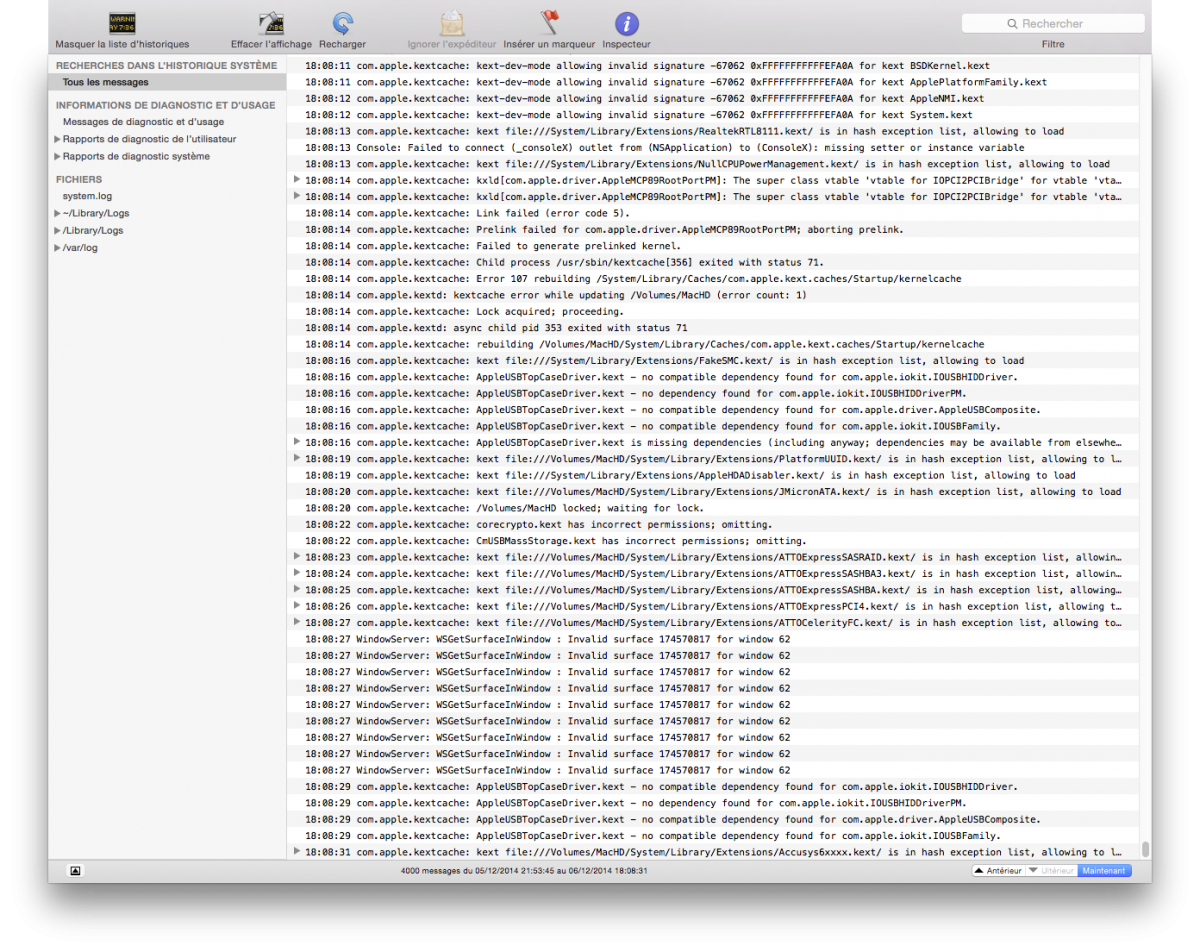

here the revision of the upper kernels without kernel panic: kernel extensions in backtrace: core crypto

Swapped out the EXTERNAL_HEADERS/corecrypto and reverted back to the original way of handling this with OpenSSL in the page_decrypt.c
A temp workaround with a boot speed sacrifice.
10.10.2 will not work. I tried to replace the drivers that before I could start successfully on the other partition. It is not, perhaps someone has an idea.?
I will continue to try to resolve the problem and report.
