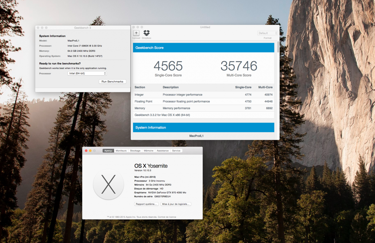

Fljagd Posted September 26, 2015 Share Posted September 26, 2015 If you want to test, I'm updating my post-install for X99 https://www.dropbox.com/s/53ykjh7jt6wozdw/Post-Installer%20X79-X99.dmg.zip?dl=0Fred Link to comment https://www.insanelymac.com/forum/topic/301585-haswell-e-mach_kernel-patch-5960x-5830k-and-5820k-1010-10101-yosemite/page/24/#findComment-2170377 Share on other sites More sharing options...
Fljagd Posted September 27, 2015 Share Posted September 27, 2015 If you want to test, I'm updating my post-install for X99 https://www.dropbox.com/s/53ykjh7jt6wozdw/Post-Installer%20X79-X99.dmg.zip?dl=0 Fred Successful installation of Deluxe Asus X99 Cpu 5960x on Yosemite10.10.5 Link to comment https://www.insanelymac.com/forum/topic/301585-haswell-e-mach_kernel-patch-5960x-5830k-and-5820k-1010-10101-yosemite/page/24/#findComment-2170788 Share on other sites More sharing options...
maleorderbride Posted September 27, 2015 Share Posted September 27, 2015 What are you overclocked to? 4.5GHz? Link to comment https://www.insanelymac.com/forum/topic/301585-haswell-e-mach_kernel-patch-5960x-5830k-and-5820k-1010-10101-yosemite/page/24/#findComment-2170802 Share on other sites More sharing options...
Fljagd Posted September 28, 2015 Share Posted September 28, 2015 What are you overclocked to? 4.5GHz? 4,3GHz And to 4,4 GHz it is the machine of Samtimbaub thank you to him for having used my install Fred 1 Link to comment https://www.insanelymac.com/forum/topic/301585-haswell-e-mach_kernel-patch-5960x-5830k-and-5820k-1010-10101-yosemite/page/24/#findComment-2170844 Share on other sites More sharing options...
