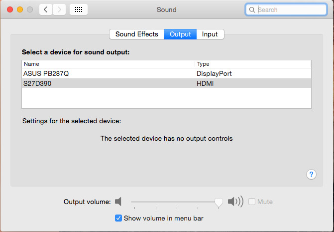

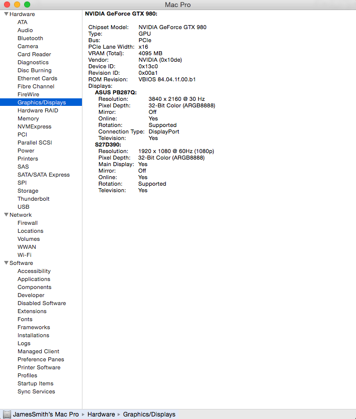

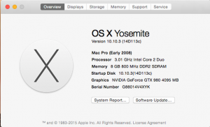

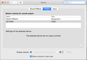

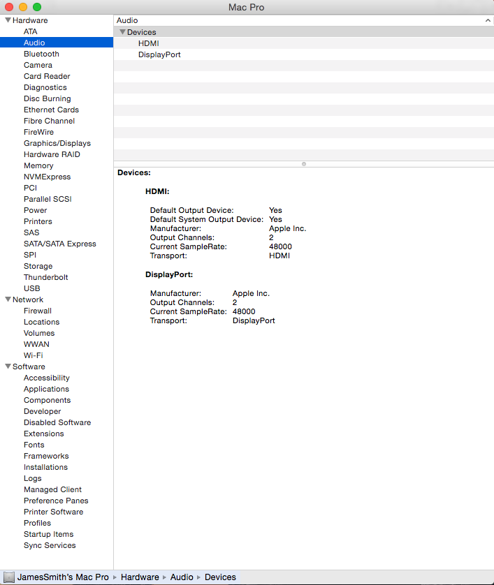

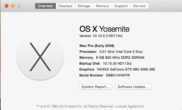

For my Nvidia GTX 980 in 10.10.3 (14D113c) WebDriver-343.02.03b04 works with both 4K monitor and HDMI monitor as well as its DisplayPort audio & HDMI audio at the same time.
