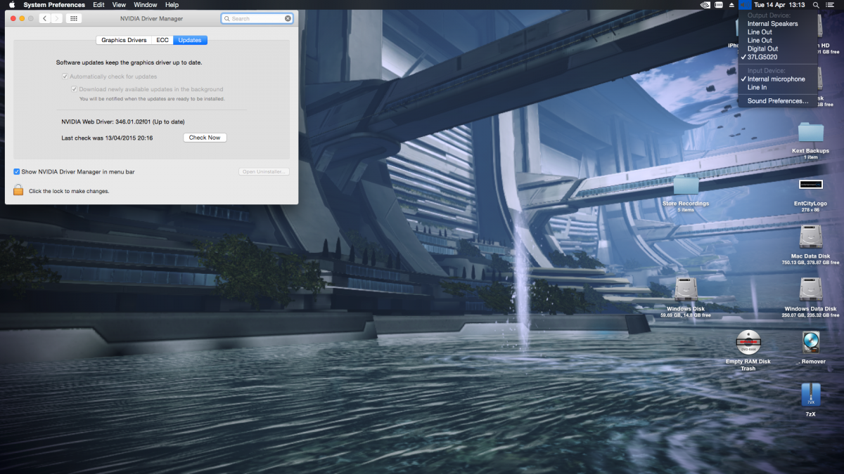

The last thing I did was install the HDMIaudio1.1 kext that I'm sure everyone on this forum knows about (I'm guessing version 1.0 would work as well). You can find both in posts #1 and #207 in this thread: http://forums.macrumors.com/showthread.php?t=1499797 After restarting, HDMI audio works perfectly. It's the same as it always has been for me though, the sound icon in the menu bar is grayed out. But regardless, HDMI audio works! And when I plug in my TV to the 2nd HDMI port of the GTX 750, it shows up in the Sound settings and I can choose between it and my computer monitor. I also tested if they worked after waking from sleep and they both do no problem.
HOORAY! Audio through HDMI Finally works! ...Ok enough excitement :lol:  (For the record, since 10.10.2 i couldnt get HDMI audio to work!)

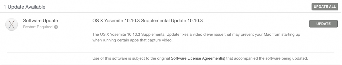

Here's the fix for supplemental update & latest webdrivers :
sudo nano /System/Library/Extensions/NVDAStartup.kext/Contents/Info.plist
Change this :
<key>NVDARequiredOS</key>
<string>14D131</string>
Like that :
<string>14D136</string>
then :
sudo kextcache -system-prelinked-kernel
sudo kextcache -system-caches
And finally, reboot ! :D

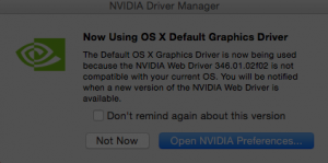

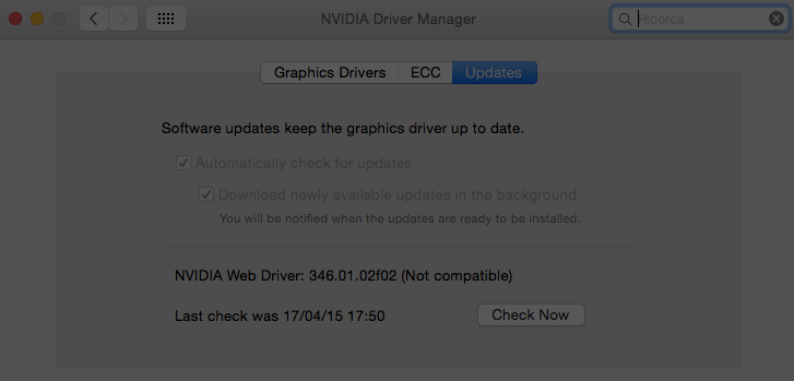

No luky for me... still remain : "(not compatible)"
Driver version : 346.01.02f01
Did you control-x before shutting down the terminal ? Otherwise, changes would not be applied :P....
You can easily check this by running once again :
It should works.
It should works.
Yes. I save it.

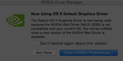

Nothing works for me with this last supplemental update.
I was using the latest Nvidia driver for 14D131 and got the update from the MAS, then before restarting I modified the Nvidia plist to 14D136 and touched the system extensions in terminal. Then I got this weird thing saying that NvStartup was installed improperly.. Weird because I'm used to doing this method before without issues. Don't know what went wrong this time around.
Anyways, now I'm on the 14D136 version of the OS and Nvidia's panel doesn't let me use the alternate drivers. Tried Blankmac solution too of modifying the system version directly but no luck so far. I'm stuck for now. Any thoughts?
Yes. I save it.

Seems like something got corrupted. I can no longer access the Nvidia panel in system preferences, it asks for a reinstall.
As of Nvidia's package drivers, my computer in not compatible now...
So, I modified the system version back and forth, nothing's happening.
