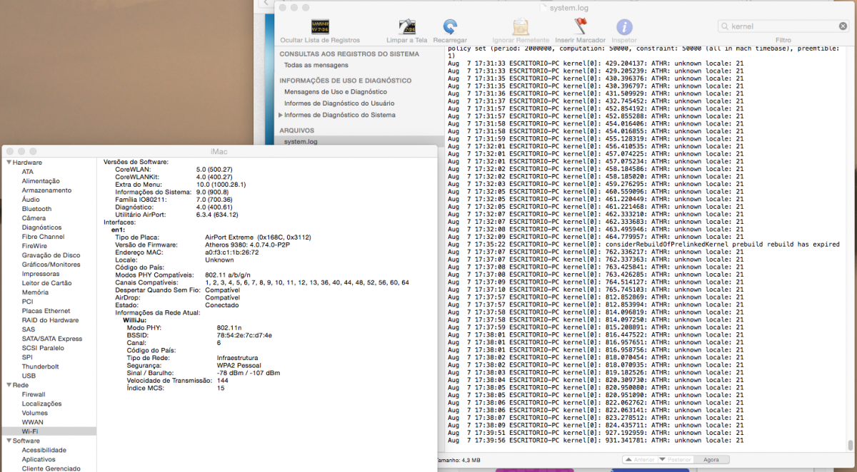

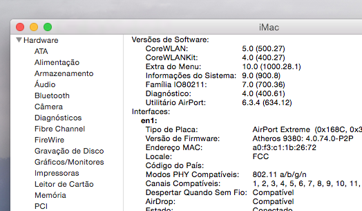

MacWill Posted August 7, 2014 Share Posted August 7, 2014 What can be done about this? Does anyone have an idea? Link to comment https://www.insanelymac.com/forum/topic/298402-os-x-yosemite-dps-builds/page/65/#findComment-2049500 Share on other sites More sharing options...
Maniac10 Posted August 7, 2014 Share Posted August 7, 2014 @MacWill: Try this patch in KernelAndKextPatches->KextsToPatch (Clover only): <dict> <key>Comment</key> <string>Wi-Fi Region to 0x64</string> <key>Find</key> <data> D7eH3AQAAA== </data> <key>Name</key> <string>AirPortAtheros40</string> <key>Replace</key> <data> uGQAAACQkA== </data> </dict> No idea if it works in Yosemite but it used to work for me in Mavericks. 3 Link to comment https://www.insanelymac.com/forum/topic/298402-os-x-yosemite-dps-builds/page/65/#findComment-2049514 Share on other sites More sharing options...
ADHDMedia Posted August 7, 2014 Share Posted August 7, 2014 @MacWill: Try this patch in KernelAndKextPatches->KextsToPatch (Clover only): <dict> <key>Comment</key> <string>Wi-Fi Region to 0x64</string> <key>Find</key> <data> D7eH3AQAAA== </data> <key>Name</key> <string>AirPortAtheros40</string> <key>Replace</key> <data> uGQAAACQkA== </data> </dict>No idea if it works in Yosemite but it used to work for me in Mavericks. I have that problem too, I'll give that patch a shot when I get home. Link to comment https://www.insanelymac.com/forum/topic/298402-os-x-yosemite-dps-builds/page/65/#findComment-2049524 Share on other sites More sharing options...

MacWill Posted August 8, 2014 Share Posted August 8, 2014 Maniac10 perfect! What is the region corresponding to the key 0x64? The corresponding to Brazil I can only confirm on windows. 1 Link to comment https://www.insanelymac.com/forum/topic/298402-os-x-yosemite-dps-builds/page/65/#findComment-2049571 Share on other sites More sharing options...
TimeWalker75a Posted August 8, 2014 Share Posted August 8, 2014 0x64 is FCC (specification has been issued by Federal Communications Commission) as you can see from your system information. The country code that matches it is within the US an Americas. 3 Link to comment https://www.insanelymac.com/forum/topic/298402-os-x-yosemite-dps-builds/page/65/#findComment-2049604 Share on other sites More sharing options...

MacWill Posted August 9, 2014 Share Posted August 9, 2014 Wpplay2, as RegDomain Utility for Atheros Adapters (RCU) the regdomain from Brazil is 0x3b (FCC3_WORLD). The hexadecimal replacement in Clover I do not know if it's the same ... 1 Link to comment https://www.insanelymac.com/forum/topic/298402-os-x-yosemite-dps-builds/page/65/#findComment-2049872 Share on other sites More sharing options...
Wppley2 Posted August 9, 2014 Share Posted August 9, 2014 Wpplay2, as RegDomain Utility for Atheros Adapters (RCU) the regdomain from Brazil is 0x3b (FCC3_WORLD). The hexadecimal replacement in Clover I do not know if it's the same ... Wpplay2, as RegDomain Utility for Atheros Adapters (RCU) the regdomain from Brazil is 0x3b (FCC3_WORLD). The hexadecimal replacement in Clover I do not know if it's the same ... Hey MacWill! Thanks for responding. You set this value to your wi-fi card? What was the patch? Link to comment https://www.insanelymac.com/forum/topic/298402-os-x-yosemite-dps-builds/page/65/#findComment-2049873 Share on other sites More sharing options...
MacWill Posted August 9, 2014 Share Posted August 9, 2014 I have not tried. But the patch Maniac10 works perfectly. 1 Link to comment https://www.insanelymac.com/forum/topic/298402-os-x-yosemite-dps-builds/page/65/#findComment-2049875 Share on other sites More sharing options...
Wppley2 Posted August 9, 2014 Share Posted August 9, 2014 I am using the patch Maniac10 and I thank him. But my country code is CN FCC, i.e., China. Link to comment https://www.insanelymac.com/forum/topic/298402-os-x-yosemite-dps-builds/page/65/#findComment-2049877 Share on other sites More sharing options...
