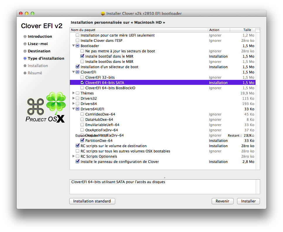

polyzargone Posted August 29, 2014 Author Share Posted August 29, 2014 boot1 error means you are not correctly installed Clover. As I said many times boot1h file from Chameleon package will not work with Clover while Clover's boot1h works for both bootloaders. The point is that when I installed Clover on my HDD, I removed all boot files from Chameleon at the root of it. So the problem is not related to Chameleon, it's in the process of Clover Install. I'm certainly not choosing the right option in the bootloader field. Link to comment https://www.insanelymac.com/forum/topic/297391-cpus1-fix-for-amd-athlon-64-x2-3800/#findComment-2056538 Share on other sites More sharing options...

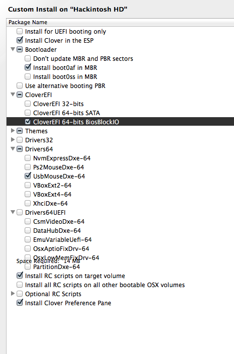

jamiethemorris Posted August 30, 2014 Share Posted August 30, 2014 The point is that when I installed Clover on my HDD, I removed all boot files from Chameleon at the root of it. So the problem is not related to Chameleon, it's in the process of Clover Install. I'm certainly not choosing the right option in the bootloader field. Try BiosBlockIO instead of SATA. Link to comment https://www.insanelymac.com/forum/topic/297391-cpus1-fix-for-amd-athlon-64-x2-3800/#findComment-2056617 Share on other sites More sharing options...
jsl Posted October 25, 2014 Share Posted October 25, 2014 The point is that when I installed Clover on my HDD, I removed all boot files from Chameleon at the root of it. So the problem is not related to Chameleon, it's in the process of Clover Install. I'm certainly not choosing the right option in the bootloader field. I think you are the first or only lucky one who use AMD Athlon 64 x2 3800+ with working 10.9.4. May I know which patched AMD kernel you are using for that ? and boot by Chameleon or Clover ? Can you also show your org.cahmeleon.Boot.plist or Clover's config.plist ? Link to comment https://www.insanelymac.com/forum/topic/297391-cpus1-fix-for-amd-athlon-64-x2-3800/#findComment-2075932 Share on other sites More sharing options...
spakk Posted October 25, 2014 Share Posted October 25, 2014 according to the attached image which he has uploaded, he uses clover, see image Link to comment https://www.insanelymac.com/forum/topic/297391-cpus1-fix-for-amd-athlon-64-x2-3800/#findComment-2075975 Share on other sites More sharing options...
polyzargone Posted October 25, 2014 Author Share Posted October 25, 2014 according to the attached image which he has uploaded, he uses clover, see image No, I TRIED to install Clover but never had success The kernel I used is AMD Kernel For OS X Mavericks 10.9.4 [XNU:13.3.0] V2.0 from Deekay available at hackintoshosx. I believe AMD Kernel rc7 works fine too. here's my chameleon.boot : <?xml version="1.0" encoding="UTF-8"?> <!DOCTYPE plist PUBLIC "-//Apple//DTD PLIST 1.0//EN" "http://www.apple.com/DTDs/PropertyList-1.0.dtd"> <plist version="1.0"> <dict> <key>Boot Banner</key> <string>No</string> <key>EthernetBuiltIn</key> <string>Yes</string> <key>Kernel</key> <string>/Extra/deekay_kernel</string> <key>Kernel Flags</key> <string>-f npci=0x2000</string> <key>Legacy Logo</key> <string>Yes</string> <key>PrivateData</key> <string>No</string> <key>SMBIOS</key> <string>/Extra/SMBios.plist</string> <key>SystemType</key> <string>1</string> <key>Theme</key> <string>Default</string> <key>Timeout</key> <string>5</string> <key>busratio</key> <string>10</string> </dict> </plist> and my Extra folder : AppleACPIPS2Nub.kext AppleATIATA.kext ApplePS2Controller.kext BCM5722D.kext lspcidrv.kext NullCPUPowerManagement.kext Patched_10.7_AppleRTC.kext SuperVIAATA.kext VoodooHDA.kext VoodooTSCSyncAMD.kext However, I can't update to 10.9.5, no matter which kernel I use. 2 Link to comment https://www.insanelymac.com/forum/topic/297391-cpus1-fix-for-amd-athlon-64-x2-3800/#findComment-2075983 Share on other sites More sharing options...
